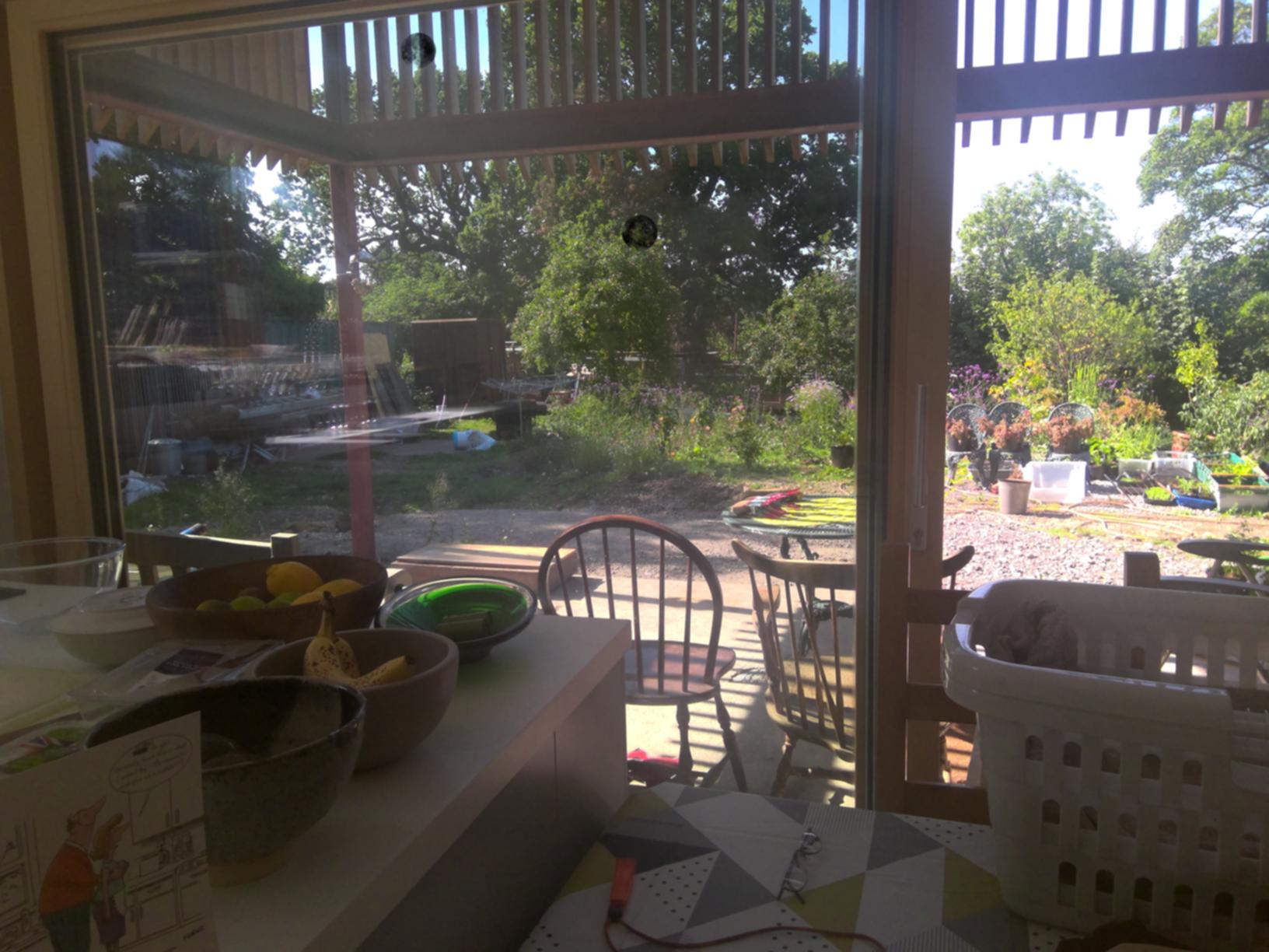

ToughButterCup Posted September 8, 2021 Posted September 8, 2021 We had our PHPP calcs done, and found we needed to take account of the solar gain. So this is what we did - picture taken from the kitchen where I am typing this post... Yes, its a large overhang - its called a Winter Garden - fancy name for overhang. Kevin WhatsHisFace would call it a Breeze Corridor. Anyway, whatever the name, without it, we'd cook. You are looking through six sheets of glass on the left hand side (one slider moved to the left handside), and no glass to the right of the vertical : that's 2 and a bit meters of open window - 27 outside and 22 inside out of the wind. 3

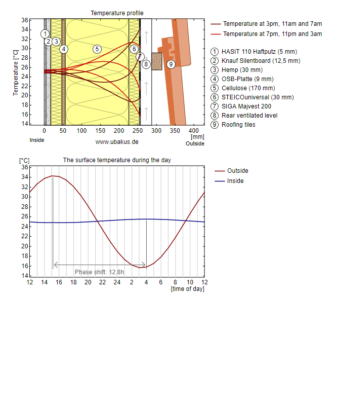

Iceverge Posted September 12, 2021 Posted September 12, 2021 Out of interest how was the roof insulated in your previous home? Do you know what materials were used as different types of insulations have very different behaviours in heat even with the same u value. Do you have any plans of the house you're proposing to share?

Deejay_2 Posted September 13, 2021 Author Posted September 13, 2021 On 12/09/2021 at 21:55, Iceverge said: Out of interest how was the roof insulated in your previous home? Do you know what materials were used as different types of insulations have very different behaviours in heat even with the same u value. Do you have any plans of the house you're proposing to share? Expand Hi - my spreadsheet indicates SIG Roof Rectocel Rigid Board PIR 130mm SIG Speedline Thermal Laminate 37.5 I am hopefully attaching photos from the house we built previously. I have photos of every stage which is handy as I can now see what could be regarded by the experts as "not very well done". The architect has tried to send the plans for proposed dwelling over to my PC but we have failed so I can't upload them. We are communicating by Royal Mail at the moment - he sends the amended plans (misses stuff off), I re-amend them and post them back - works well to be honest. I'll upload the plans for the previous house as they are similar. However there is a projection on the rear of the proposed house and the garage is a detached triple with granny flat above and we have an additional 4.5 m single storey "gym" to adhere to the 25 degree rule re daylight. We never intended building on the site ourselves so were real amateurs. However having Premier Warranty was an additional back up and well worth the money. Don't laugh but I sort of project managed it myself - ordering all the stuff and then organising trades when the builder had left at the watertight stage. We had no hiccups and the build ran smoothly and stress free. You may say, that's because I let them get away with murder - who knows!!! I'm interested to hear your views on the insulation. Struggling to upload pictures so will do another post.

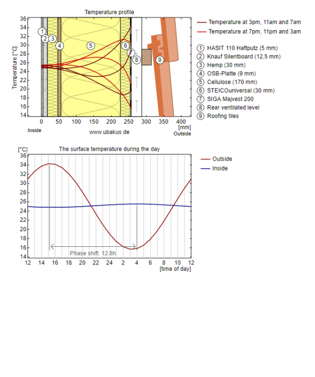

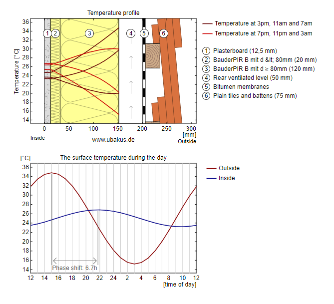

Iceverge Posted September 13, 2021 Posted September 13, 2021 I guess your first buildup was something like this. I calculated a U value of 0.188 and a phase shift (decrement delay) of 6.7hrs. This isn't a great number and may have added to your overheating. A better option for heat protection. Similar U value but a phase shift of 12.8hrs. Notice the much less extreme swing for internal surface temperature in the summer. This makes overheating easier to control. On a cold winters day both roofs will perform the same against the cold. The website I used was. It's worth having a play. https://www.ubakus.com/en/r-value-calculator/? It includes this importance sentence in the blurb there too. "For a proper summer heat protection, materials with a high heat storage capacity should be used, ideally in combination with an outer insulation. In addition, the direct sun exposure through windows must be reduced to an acceptable level by shading means, e.g. outer blinds, roller shutters or sun sails" 2
