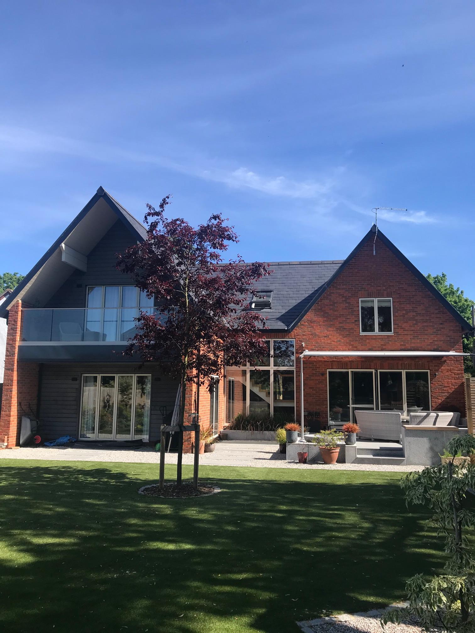

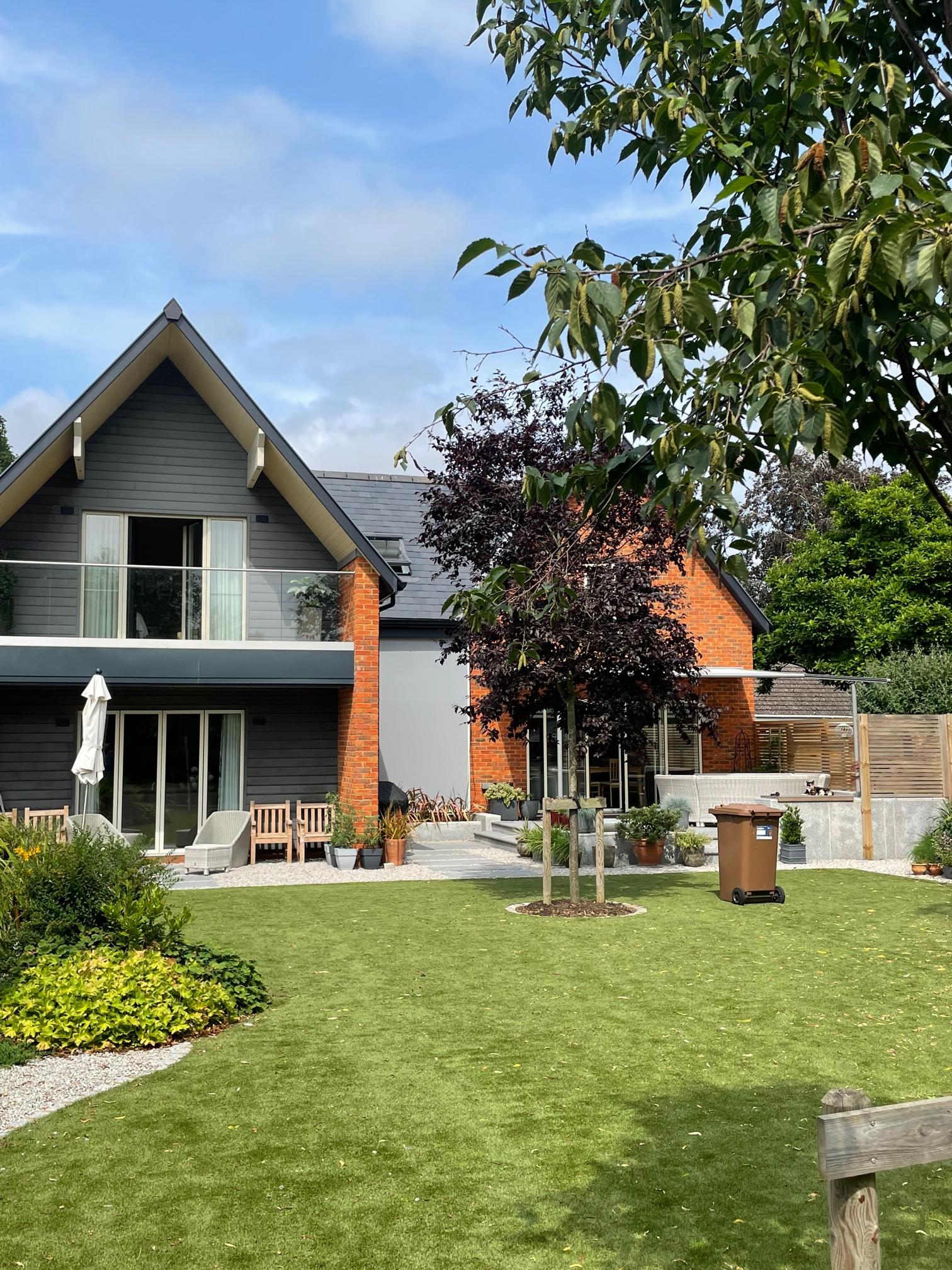

We made the mistake of concentrating on insulating for winter rather than summer. Having a SSE facing rear has contributed to high levels of solar gain in the summer months. Our large hall and landing window is non-opening and can easily raise the inside temperature to 32deg.
We have now finished installing an electric pergola for the kitchen and electric solar blind for the hall. These both operate from the Somfi app and coupled with the Velux have made things much more controllable.
