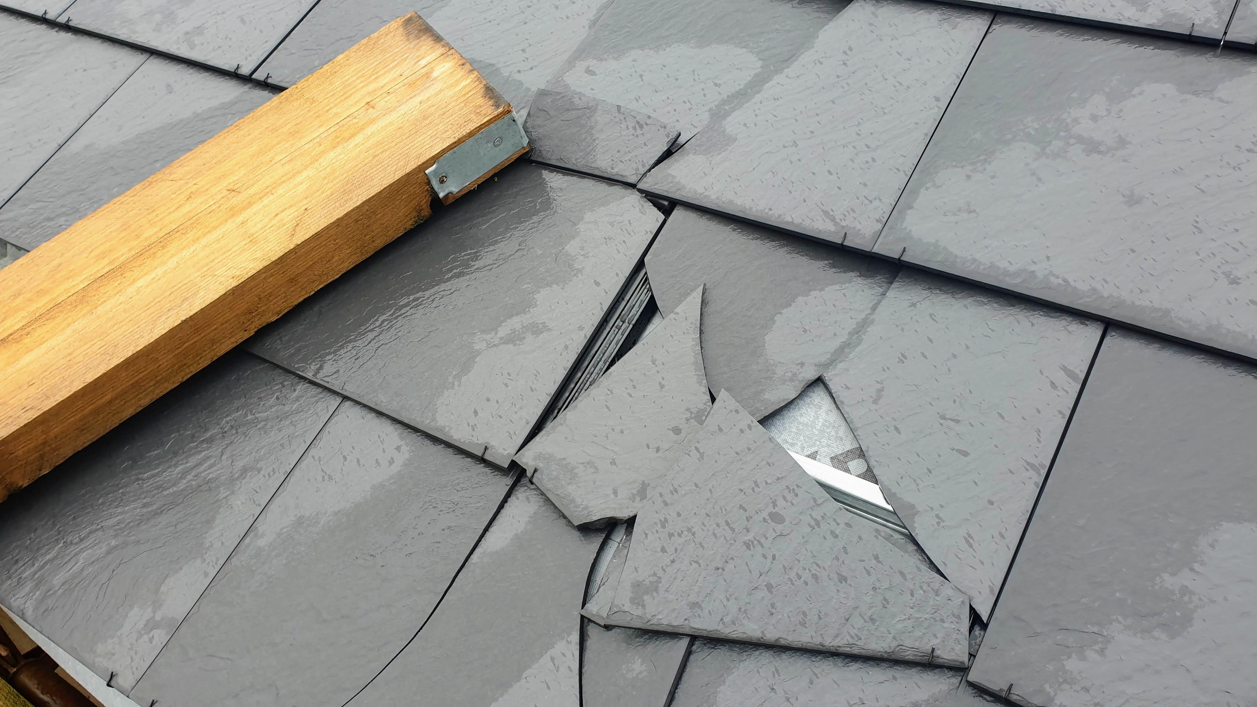

Two years ago, just after the roof was tiled with Nulock cermaic tiles, a bit of a hooley blew up: long story short it blew some scaffolding planks off the scaff and onto the roof.
Live and learn. Next time scaff plank clips. ?
Here's part of what the storm did.

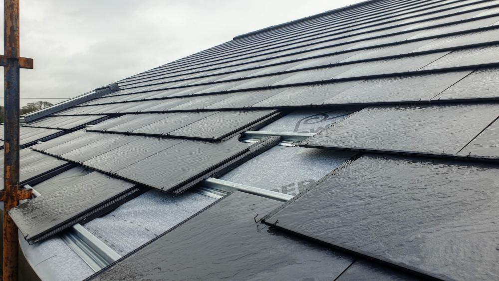

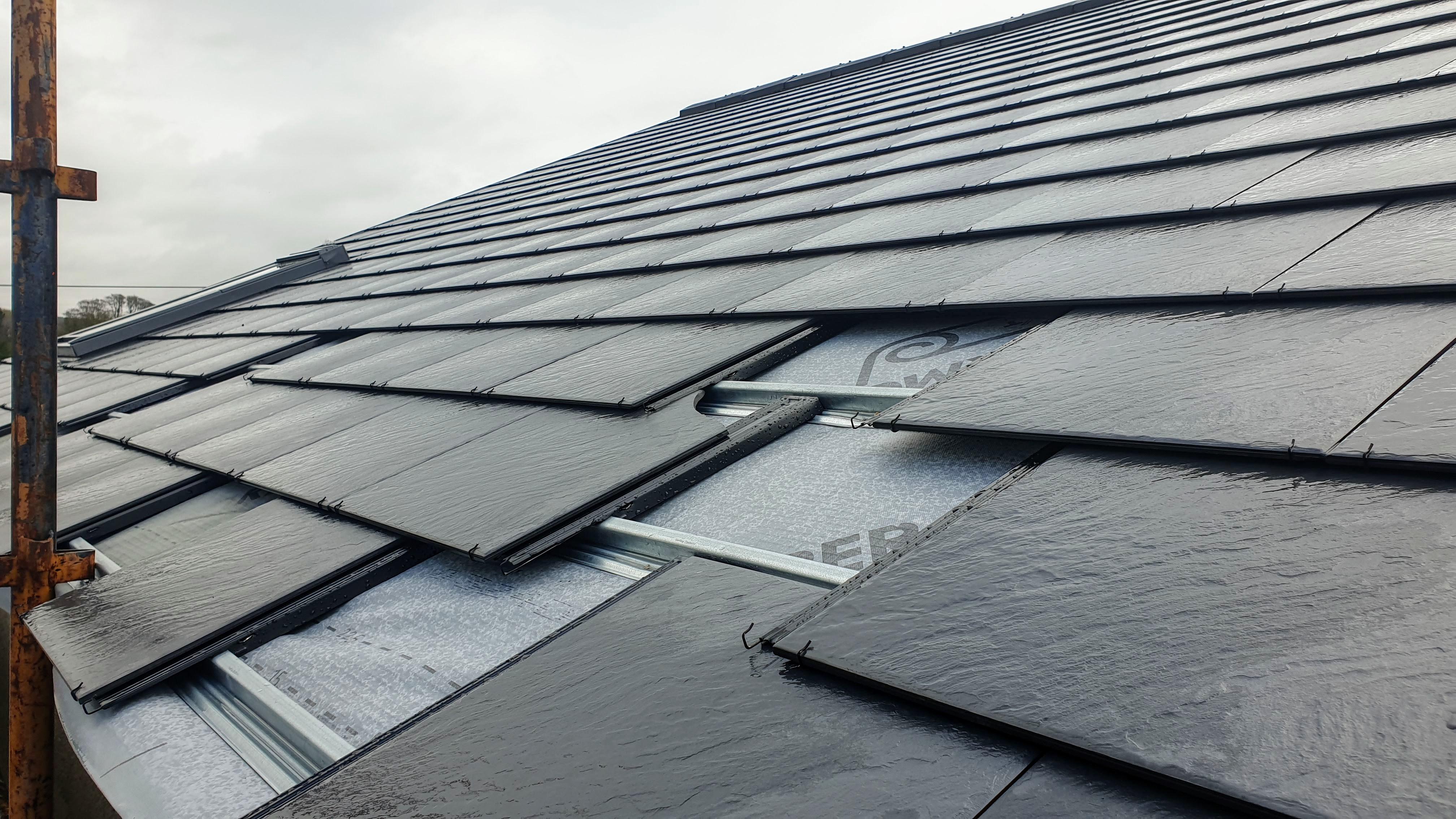

and here's how I repaired it
The photos were taken when the storm was still pretty full-on: I was clipped to the scaffolding with a full harness. Nulok is easy to replace though - and I was keen to get the job done to prevent further damage.

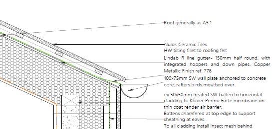

There is no roof space, so I cant see the exposed underside of the roof from inside. Heres a cross section -
Why did it happen now? A bit of head-scratching and came up with the following - what have I missed?
The repair to the tiles was done  under pressure: it was quite dangerous - windy enough to be fully harnessed and clipped on. The repair to the tiles took about 15 minutes.
Nulok is very easy indeed to replace - throw the broken tiles off the roof, slide in a new one. They simply clip in.
What I did NOT DO was inspect the underlying felt because I was worried about being blown off the roof. I bet I simply missed a small rip or two in the felt......  If thats correct,  given sufficient temperature contrast, there would be condensation on the bottom of the tiles. And maybe there's a bit of ponding on the felt...  and the water makes its way through the small rip. And because its small hole, it takes ages to show up.  Maybe it took that long to trickle through over 300mm of roof build up.

I assume you replaced the tile with broken corner in second photo?
Yes.

Those two don't quite match. You have the membrane above the counter batten.
One reason for the counter batten can be to form a gap between membrane and batten so that any water that does get past the tiles can run down to the gutter and not pool above the battens. Its important on a roof with wooden battens because without it the membrane can be pressed against the batten. Pollen and other sources of dirt can collect above the batten and form a gunk/slime that seals any tiny gap that might exist. Eventually  the timber batten can rot. Not an issue with metal battens?

I have to agree with @Temp re the roof build up.

I have mislead you all about the roof build up:
  • On top of the joists is a wooden batten that runs along the joists (25mm)
  • [There's a 25mm gap between the top of the insulation and the top of the  joists - 50mm gap in all]
  • The there's the felt - with slightly slack trough to allow water to run to the centre of the gap between the joists
  • On top of that is the metal batten which
  • holds the metal formers
  • which hold the ceramic tiles.
