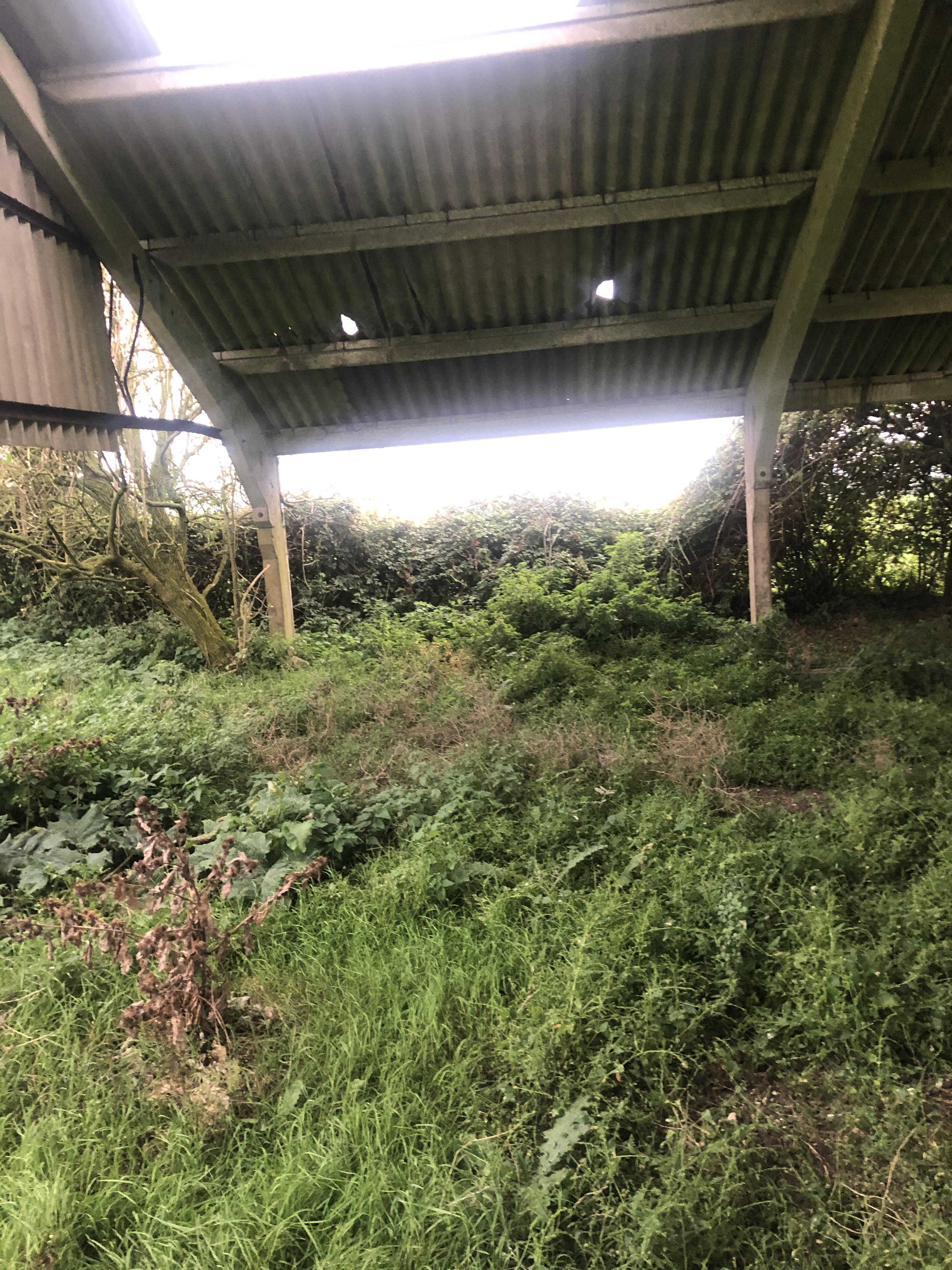

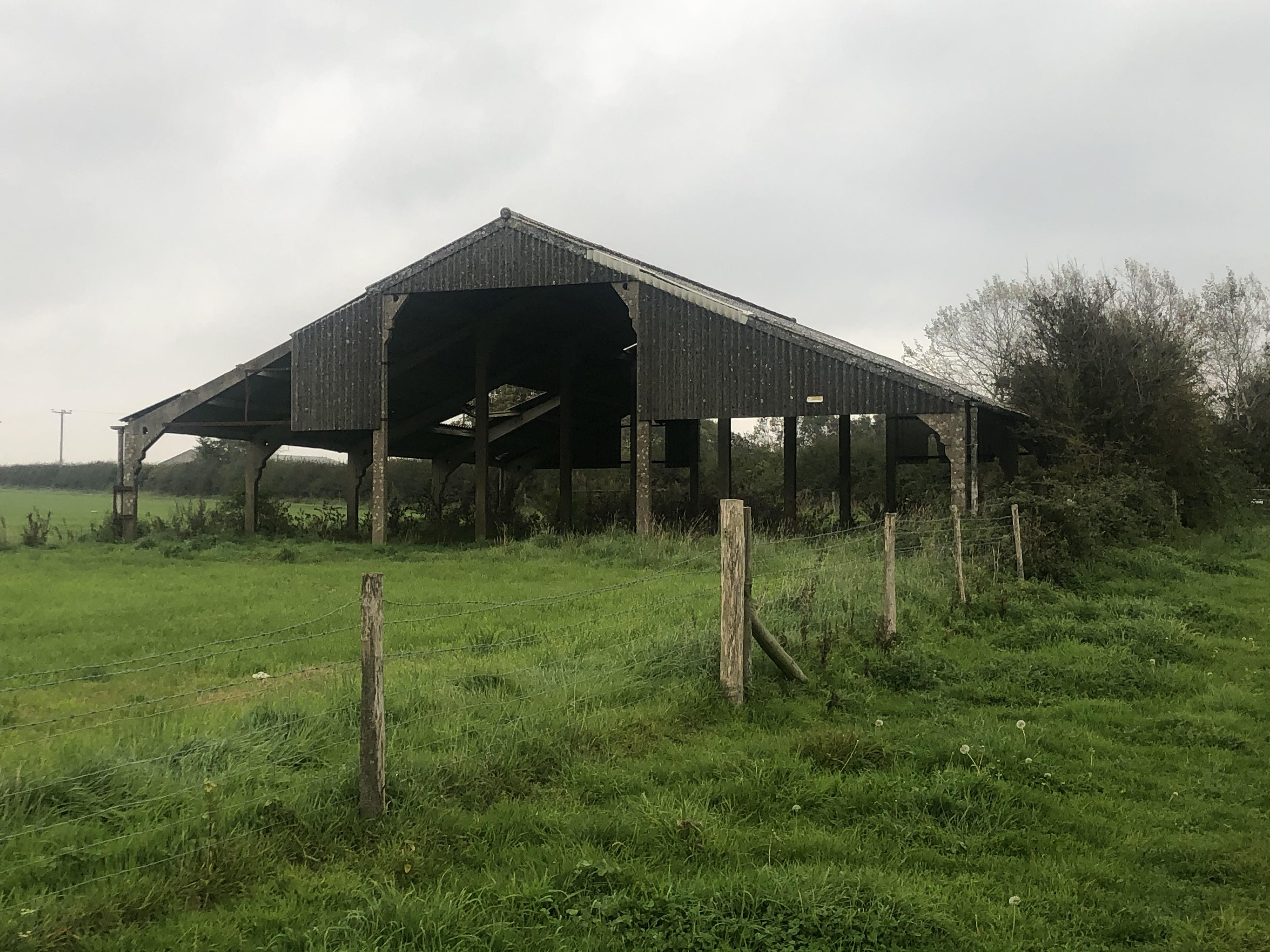

This is the place. Spoke to a planning consultant today who is giving me some advice on a pre application meeting/ correspondence. I think part Q is a non starter so it’ll probably be all in. I need to push the sustainability pitch in other ways. Environmental credentials? Working with the local college students as a sustainability project? Open a small holding?
