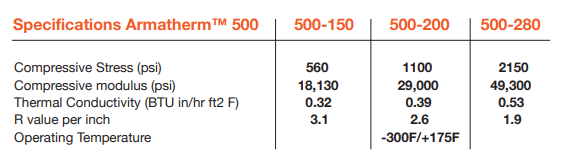

  9. We've used armatherm structural thermal breaks in a variety of places, which like the Farrat are I think commonly used for steel balcony connections https://www.armatherm.co.uk/products/frr-structural-thermal-break-material/ They can provide bushings and washers as well Not expensive. I believe stainless steel bolts give reduced heat transfer. While I'm not a professional, even if I wasn't concerned about heat transfer I wouldn't want any structural steel running through the envelope on a building intended to last 100+ years. What if the outer end gets wet and rusts? Wouldn't want to have to replace the entire beam. In that, I'd want the balcony to be replaceable independently of the main structure. We don't have any balconies, but we have an awning bracket which is similar. The stuff that looks like wood is the armatherm FRR:

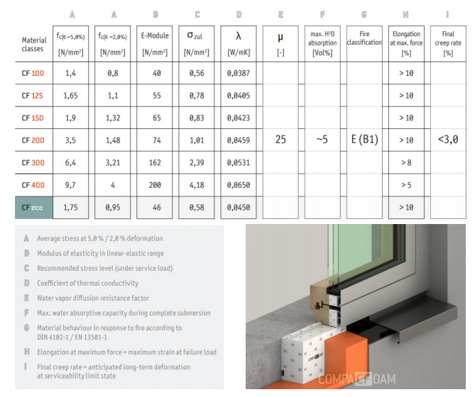

  13. Fair enough. For various reasons we can't support much weight off the sides, and while in principle the support along the bottom need not be continuous (e.g. could have 3 blocks of perinsul and fill in the gaps between with foam blocks) the way the whole thing has been designed requires an insulating & structural block under the whole window frame, which then has things screwed into it and airtightness tape attached. The insulating / structural block is shaded. TBH I never really looked at this detail until now, hence the question. Also now obvious that perinsul won't work here since it can't take a screw, and I wonder perhaps armatherm can't either.

  16. Due to use of steel frame for the building structure, we have to sit all windows on a thermal break, strong enough to take the load from them. 250 kg in some cases. Experience / opinions on suitability of: Armatherm 500 https://www.armatherm.co.uk/products/500-structural-thermal-break-material/ Which we're using elsewhere for steel connections I couldn't find creep numbers for this. Compacfoam https://www.partel.co.uk/product/55/5/compacfoam Perinsul foamglas https://www.foamglas.com/en-gb/applications-and-solutions/thermal-bridge/thermal-bridge-solution My biggest concern is durability say over 50 years, and naively I'd assume the perinsul or armatherm is best for that? Some discussion of this at http://www.greenbuildingforum.co.uk/newforum/comments.php?DiscussionID=16914
