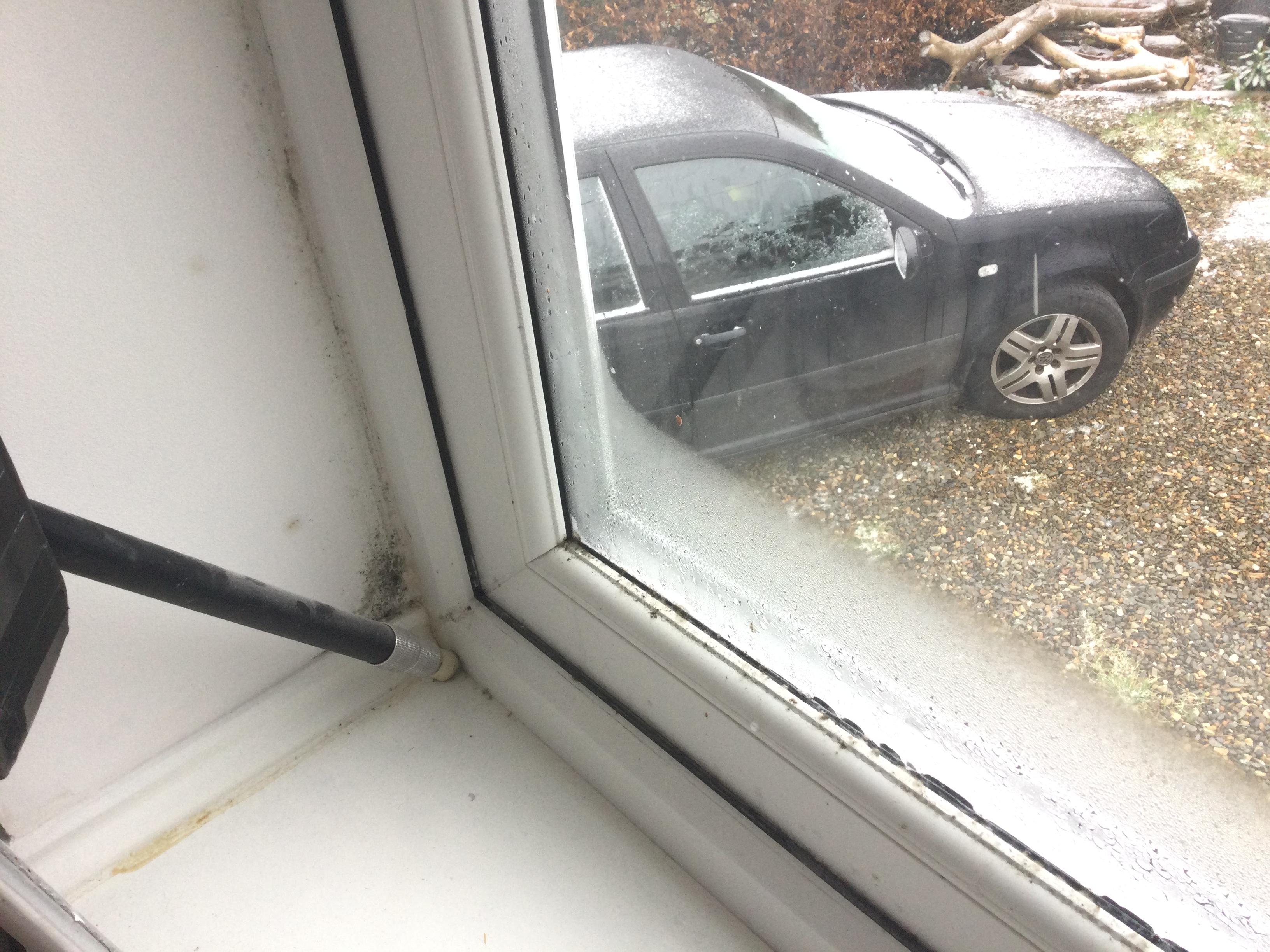

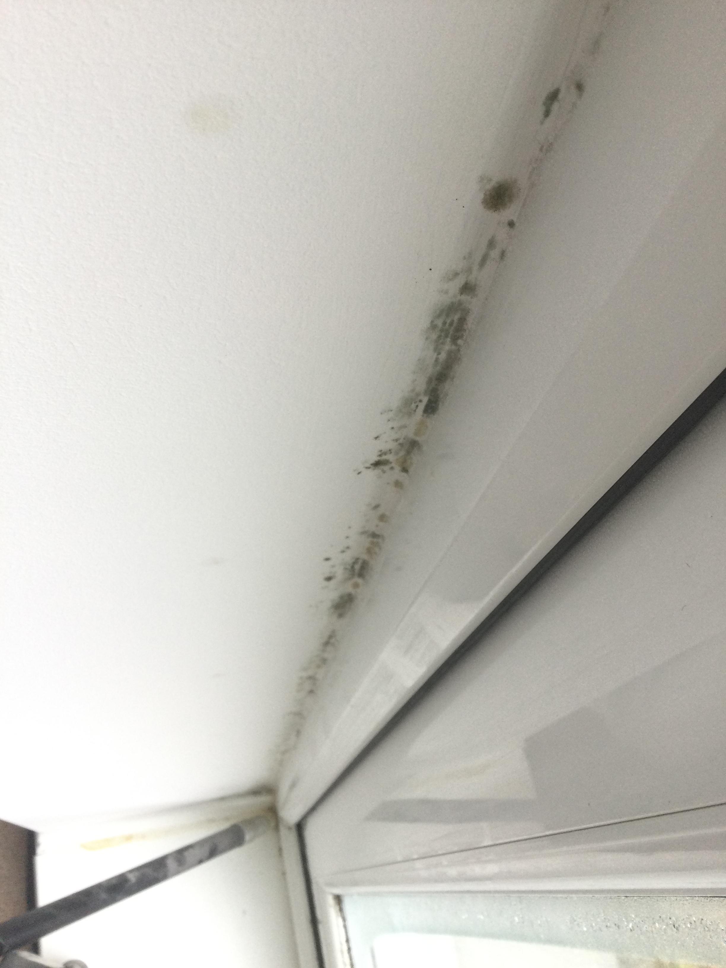

Ive  got a significant black mould & condensation thing happening at french doors..
20 minutes ago, zoothorn said:
Like my electricity provider Co/ Green Energy just has then..
Regular cleaning with a mild bleach in water solution would be my suggestion. SWMBO used to regularly do it at No.1 son's uni digs when we went to visit. Old building / modern uPVC windows.
Redoing the silicone with a specific anti mould one like Forever White might help a bit.
Ventilation is going to be a big thing always. Dead space with little airflow around the windows, corners and so on.
Edit: Saying that just looked on the net and it says bleach might actually encourage mould and black spots! Vinegar maybe?
Edited by Onoff
@Onoff but this the new extention, not old house. Got like this in just a few months since me building it.
It's a new box basically, better sealed up than any of the old rooms. The problem will likely be WORSE than in other rooms rooms.
Guessing no trickle vents in the new windows? Lots of dead air, dust, dead skin cells, sneezes and coughs and other organic detritus to stick and grow.
In fact its equally the same in all rooms.. but I wasnt expecting it in here, bc i thought it was cold bridging responsible, not my germs & mucus ( btw got your rad key to send back). One side of french doors alot worse than other too. Its like my student days.
Please, keep the key. Bleed your rads annually.
Needs heat and fresh air to stop (and regular cleaning). Hopefully your heat will get better soon.
