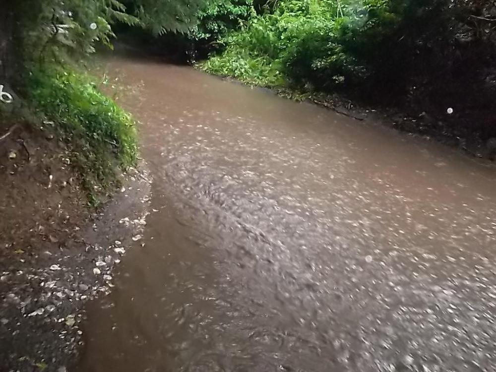

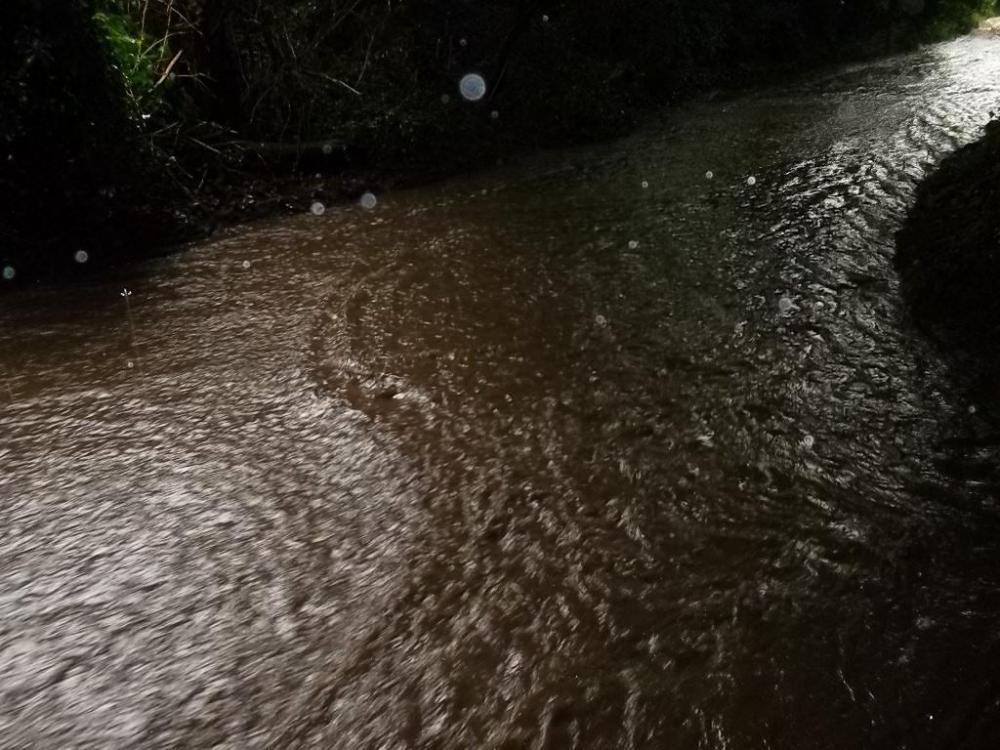

Damp valley, everything goes green? This is the road at the bottom
 of my drive, an old seasonal water course:

1 minute ago, Onoff said:
Microclimate? Think you're getting mixed up with the Play For Today, Z For Zachariah!

Looks like sewage

1 hour ago, pocster said:
Looks like sewage
Goes to the lowest point, know anyone with an underground house?
Sorry don’t . Only a (expletive deleted) wit would build one of them
