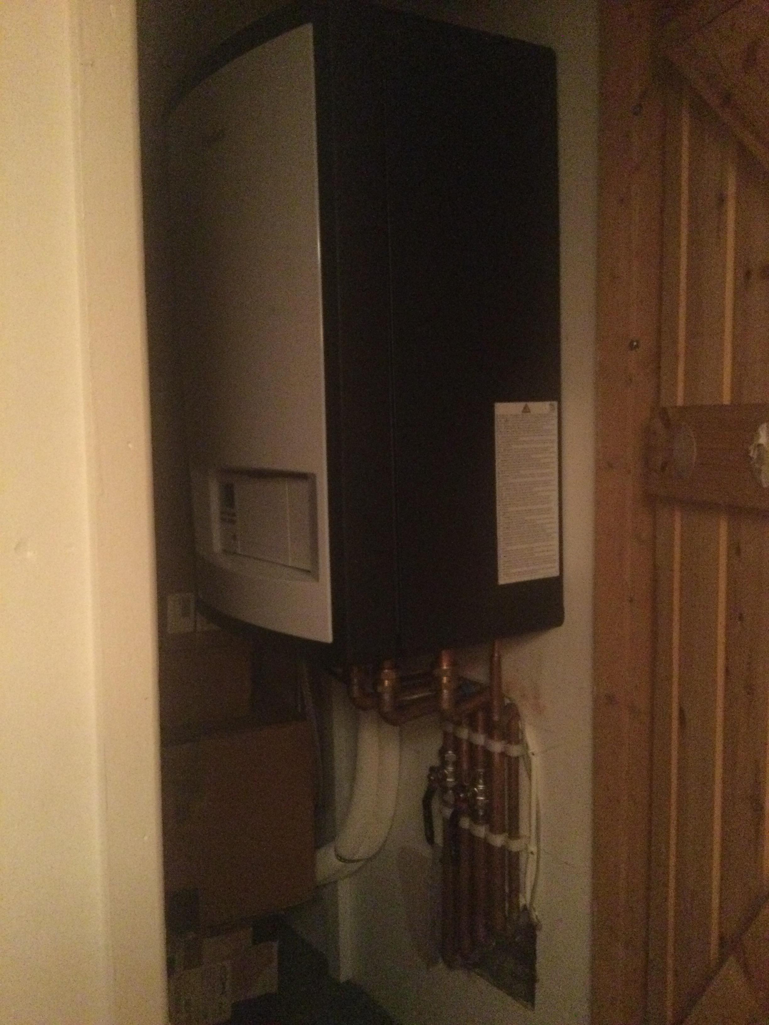

2 hours ago, PeterW said:
@zoothorn can you take a photo of the wall unit in the main room..? Is it definitely a VRC700..?
Sorry, the vrc700 is the wee controller. This is tied to a box unit thing, with pump in, pipes galore coming in/ out from.. the cause of all my woes.
They didnt leave me a manual for this wretched thing. No numbers on it, so I dont know what it is, or what model no. it is.
The system kis arotherm split 7.5kW. Its not the fan unit outside, its not the cylionder, its not the wee controller. Its a suitcase size box thing.
