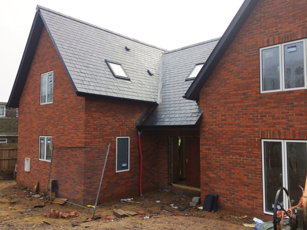

Ian Posted April 18, 2017 Posted April 18, 2017 (edited) Another one for the database: £4,800 supplied and fitted Rehau Upvc system with 3G 44mm units using their standard (dark grey coloured) 5 chamber 70mm frame. Combined 0.8 U value. Price included for 6 'normal' windows, 2 french doors (fully glazed) and 1No front door. Total area 18.5sq.m. £259/sq.m. Edited April 18, 2017 by Ian 2
