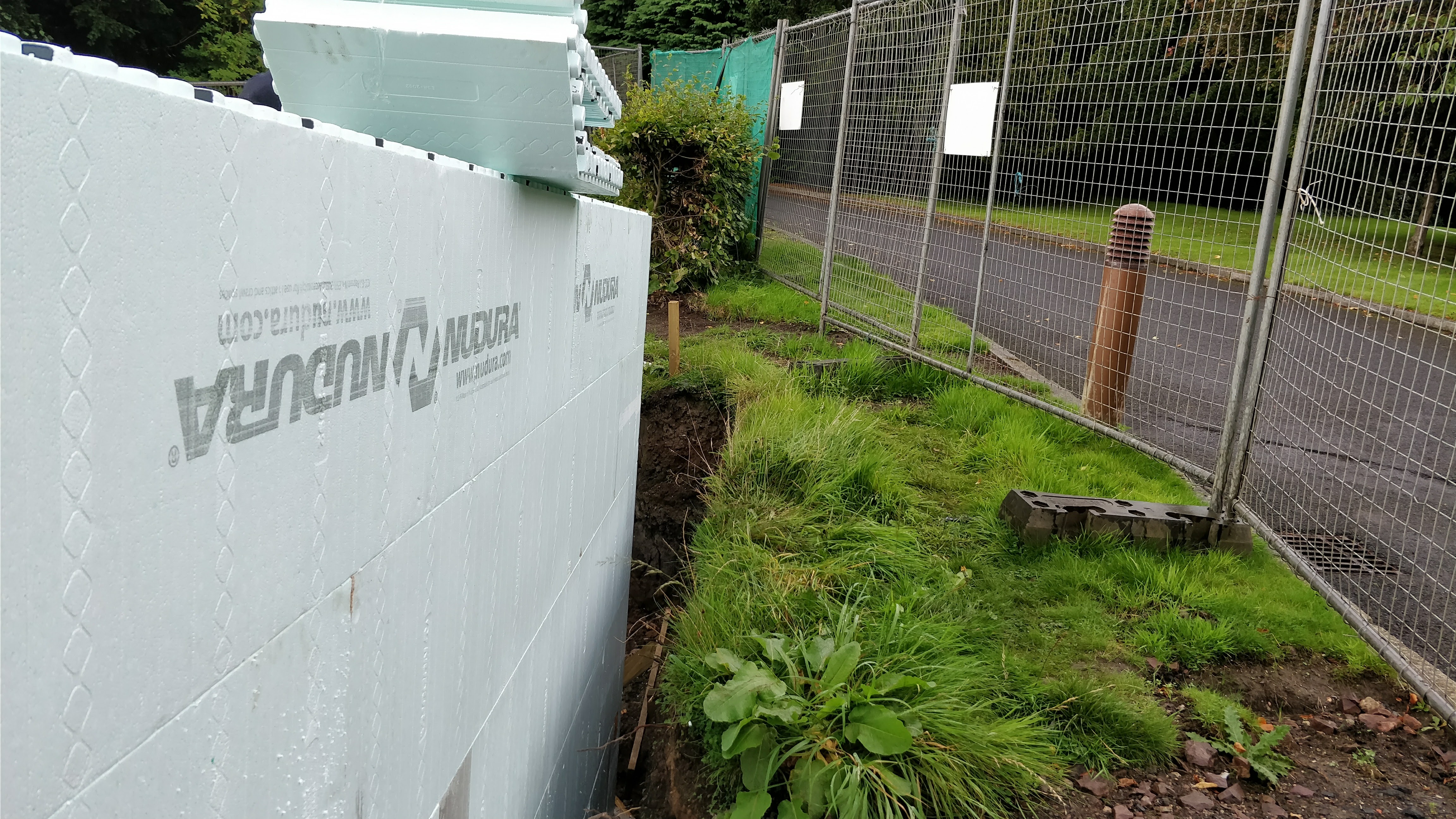

I am looking a Nudura as it has the long track record in Canada and its available in Scotland. I have a sample block that im going to have a play with to figure out how to do the windows and lintels, etc. I would be open to looking at other systems, what else is available in the UK?

hopefully start the icf part of the build next week ! we picked nudara from the scotish agent.

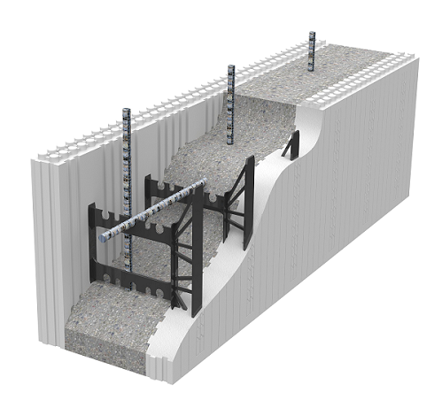

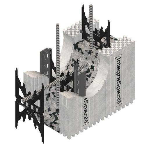

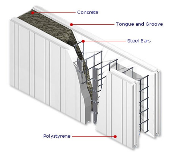

EPS based ICF's will either have a plastic or metal strip that serves two purposes - one is to provide EPS something to adhere to during the manufacturing process, second is to provide a fixing point for the next phase of construction.  I know one manufacturer in particular has done extensive testing on pull out strengths of various screws into the ABS plastic strips - a standard drywall screw has a pullout strength of 95kg and a permissible load of 24kg per screw - the highest proportions were 130kg pull out and 41kg permissible.  If you are still concerned, you are only 70mm or so away from concrete - in one case I recall using Simpson ICF-LC brackets cast into the ICF wall and attaching a timber runner to which you can fix anything heavy.
These webs are factory manufactured, so will feature in regular intervals.  If, for example, they are at 200mm c/c, you can measure from any corner and know you will hit a web consistently at 200mm c/c's.  Most (if not all) EPS based ICF's have markings on them to indicate where the webs are.  I have attached photographs of various EPS ICF's to demonstrate this.
