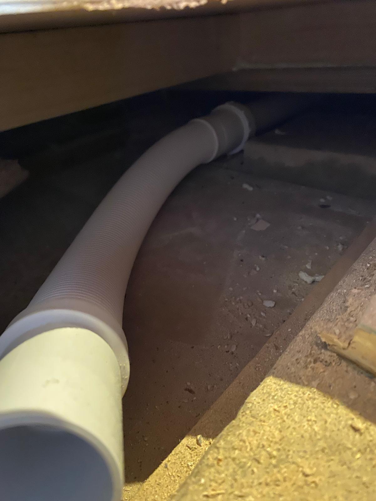

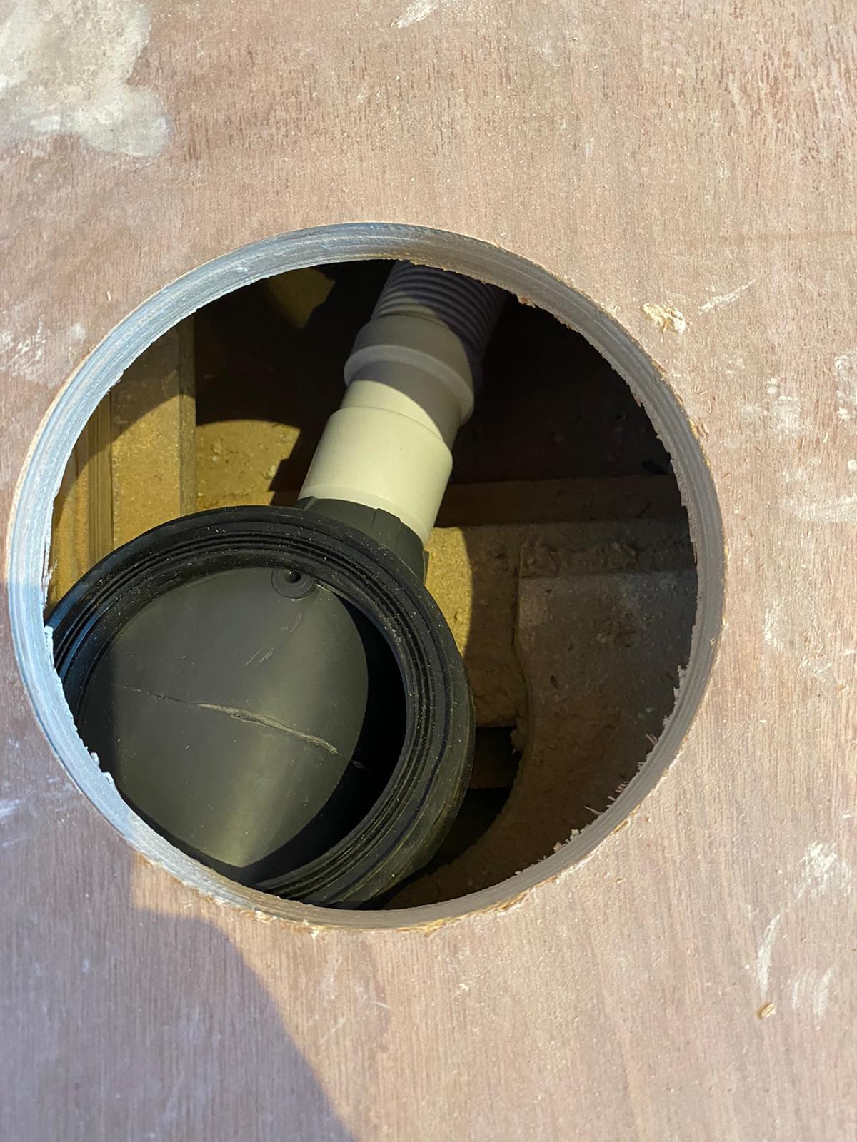

wozza Posted February 13, 2020 Share Posted February 13, 2020 (edited) That shower waste you have looks like a Wirquin Twisto - I got supplied one with my shower tray, I took one look at it and went and got a McAlpine shower waste. I don't know how they perform against each other but the build, fitting method and quality of the McAlpine is far superior. Edited February 13, 2020 by wozza 1 Link to comment Share on other sites More sharing options...

Russell griffiths Posted February 13, 2020 Share Posted February 13, 2020 I have fitted a mcalpine trap and have to say it was a very well thought out and built piece of kit. Not cheap but very well made. 1 Link to comment Share on other sites More sharing options...

Nickfromwales Posted February 14, 2020 Share Posted February 14, 2020 Mixed bag here because I’d have recommended using a flexible waste to alleviate such a baptism of fire. FWIW, a large number of tray-specific traps come with a flexi and in some of those instances you have to use it. Ive been fitting barrooms for a 1/4 century and I’ve never had a come back from a flexi. They are thinner walled, they do have grooves / undulations, but it’s just water and no solids so, apart from a build up of ‘human / soap fatty scum’, ( which builds up in a rigid waste pipe JUST AS WELL I ASSURE YOU ), there is no issue using a flexi at all. If it’s out-stretched then it could benefit from being supported, but after that I’d never say it was to any detriment whatsoever. If the supply waste pipe is rigid with no movement X/Y/Z then you will need to be mm perfect in the execution. No twist, and finished plumb and flush to the waste hole and aligned dead centre. Good advice given about mocking this up dry, but some fittings will bind and not allow you to push them home as they will do when lubricated with the glue. Gaining 2-3mm over 2 or 3 fittings ( during re-assembly ) will put you off centre. Beware 1 Link to comment Share on other sites More sharing options...

H F Posted February 17, 2020 Author Share Posted February 17, 2020 Pipe connected and working beautifully. 1 1 Link to comment Share on other sites More sharing options...
H F Posted February 17, 2020 Author Share Posted February 17, 2020 I also have the stupidly heavy tray in. Link to comment Share on other sites More sharing options...
