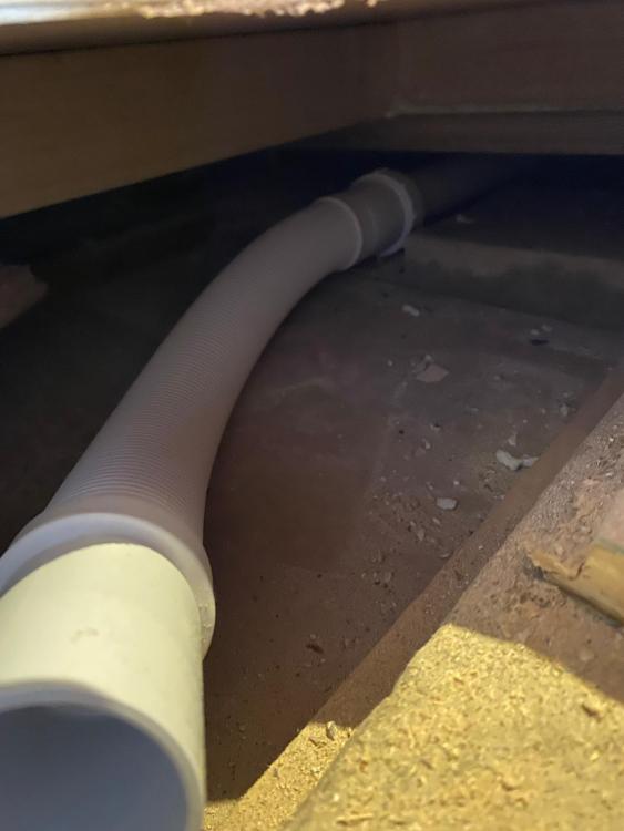

question 1. The waste for the shower. We will run a flexi pipe from the waste to the waste pipe on the right. Is that correct?

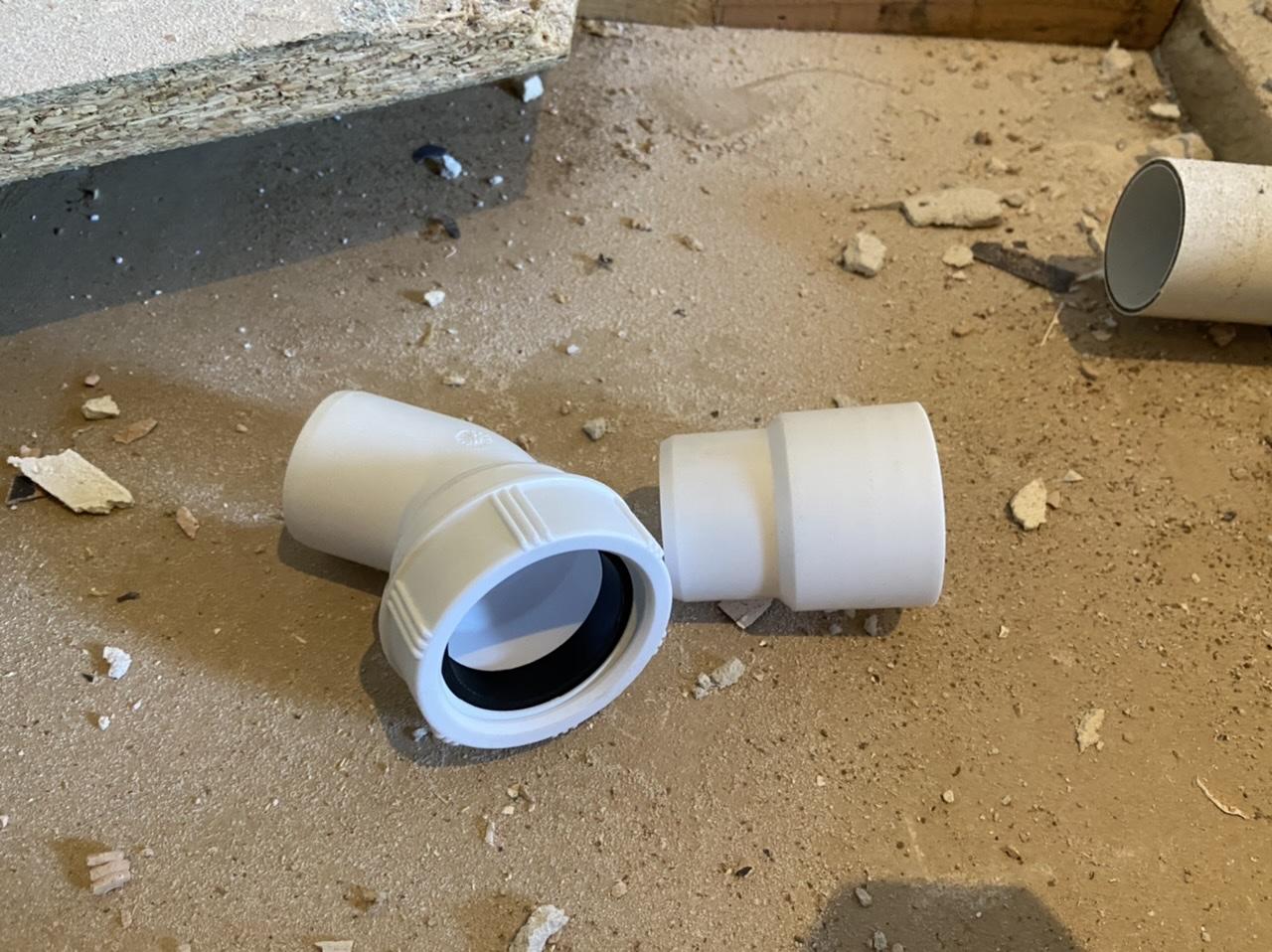

I also have these two bits - will I need them?

I do not know what those are, but if that is you then someone will know.

I personally would'nt use anything that i cant get at again, unless it was solweld. Flexi pipe would be a no for me.
Because of gunk piling up in the corrugations?

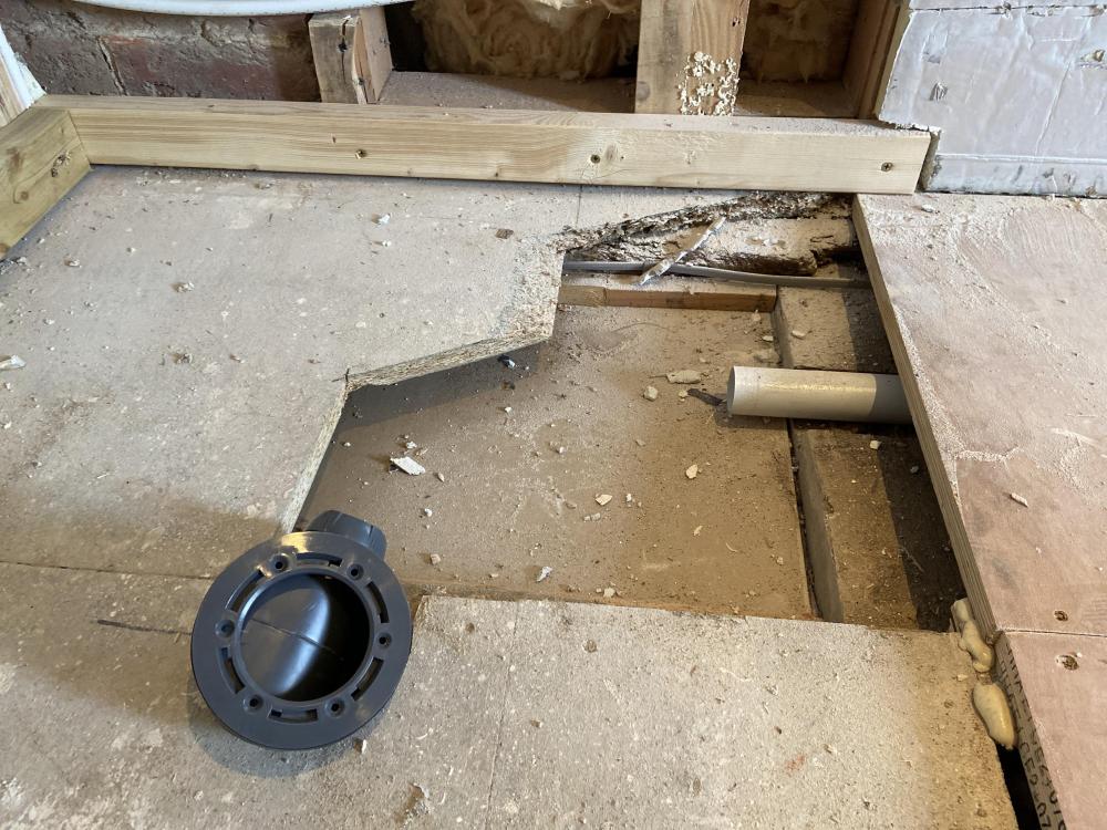

Rigid pipe, solvent welded to a TOP ACCESS trap.  The base of the trap goes in first, then the shower tray, then the top part screws down to the base and seals.  The actual "trap" then drops in, and can be removed from above for cleaning.

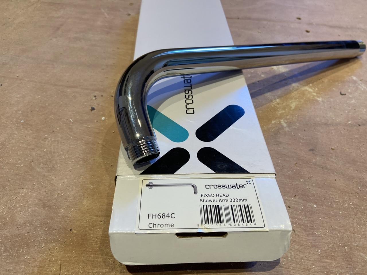

Any advice on how to securely mount a 330mm shower arm so that it’s secure and strong to hold a 12-inch fixed shower head and not droop.‬
Fix one of these so it is flush or slightly recessed in the wall and screw that pipe into it https://www.screwfix.com/p/endex-brass-end-feed-adapting-90-wall-plate-elbow-15mm-x/83561?_requestid=360473
That is just an example you can get them that take a compression fitting pipe, push fit or whatever your favourite plumbing method is. Some examples lower down on the right of that link above.

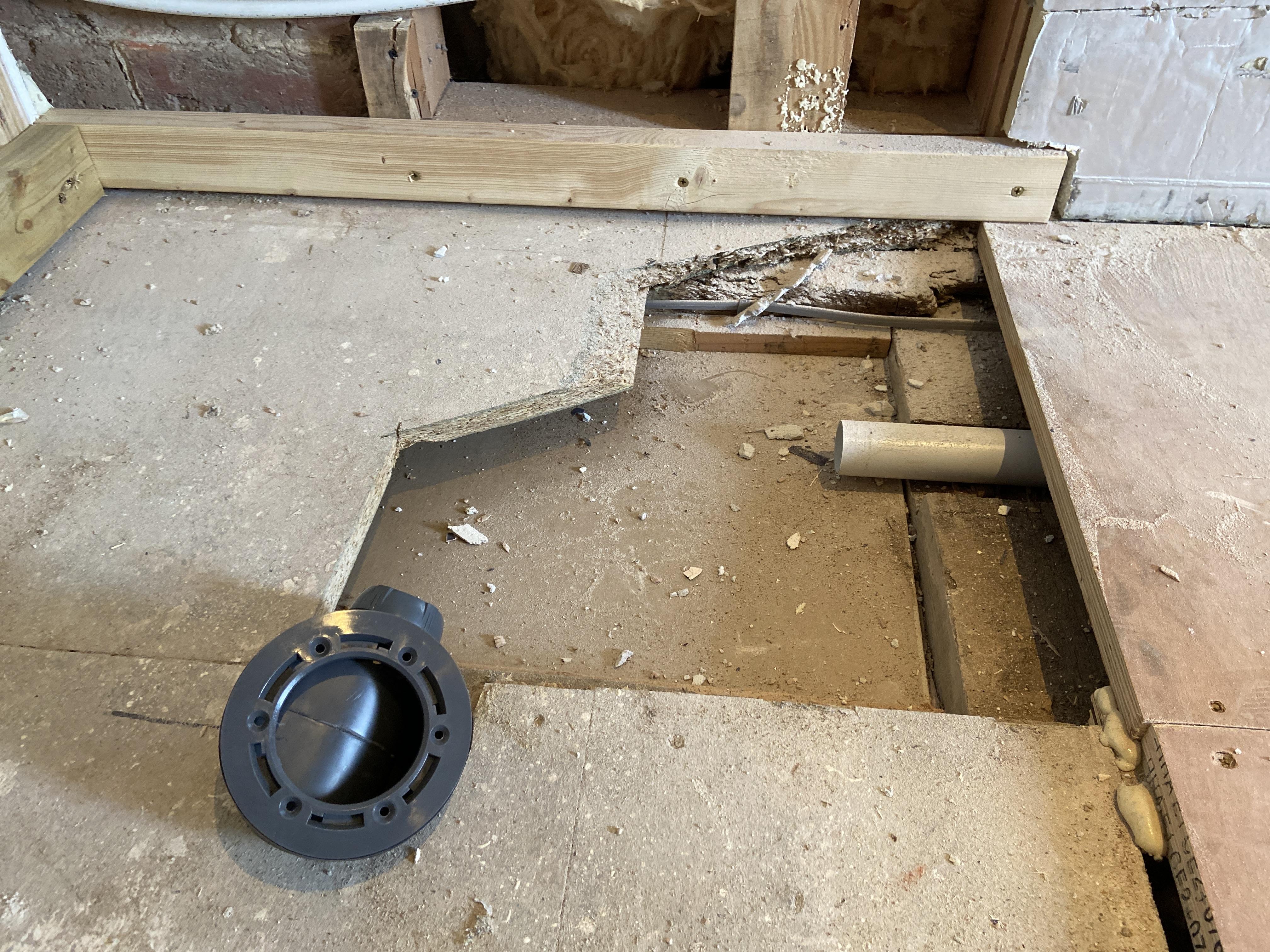

I have just done this in our ensuite using top access trap. This was the sequence I did for fitting the tray...
Shower trays need good support. Typically you need 16-18mm WPB or better still marine plywood same size as the tray supported on a 4*2 frame/joists.
Don't fit ply yet but check it will be level.
Cut a hole in the ply where the trap will go about 1/2" bigger than the trap.
Cut rigid solvent weld pipes and assemble without glue to check position of trap is perfect. Lower tray onto it to check. The top of the bottom part of the trap should be a few mm above top of plywood to allow for mortar which will raise the tray slightly.
Ideally the trap should be able to move up and down a bit so it can tighten up against underside of tray later.
When happy with the position solvent weld the pipes. Test for leaks and screw down the plywood.
Seal plywood with SBR or similar PVA sealer.
When dry lay bed of mortar and lower tray onto it. I laid the tray onto two sticks of wood first and then pulled them out. Check tray is level.
Fit top of trap through tray into bottom half of trap.
If the underside of the tray isn't nice and smooth consider putting silicon around the rubber seal on the trap before lowering the tray onto it. You can also seal the top of the trap to the tray if there is no rubber washer provided.
Later fit the innards of the trap and the mushroom cap.

If you use a top access trap a flexible pipe may not support the bottom part of the trap enough during assembly. If the bottom part moves too much it could be hard to screw the top part into it through the tray.
Solvent weld may seem bit scary but it's not really. Helps if you mark the outside of the pipes after dry assembly and use a reasonable amount of solvent. Then you get enough time to rotate the pipe to line up the marks before it sets.
