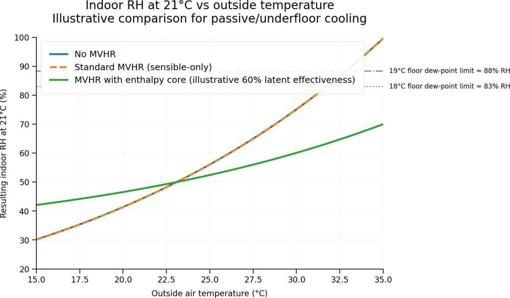

12 hours ago, NSS said:
It's worth remembering that solar gain via glazing is only part of the issue though. Our SageGlass blocks 97% of solar gain but, in sustained periods of high temperatures such as the last few days, heat permeates through the roof and walls irrespective of how well insulated your build is. Okay, it may permeate more quickly through some insulation types than others, but the real issue is getting it out again once it does get in. Let's face it, if @JSHarris is using active cooling so much then I'd suggest you are wise to at least be making provision for active cooling. I'm very glad we did, I just wish I'd tried out the UFH element of it before this week ?‍♂️
Planning on some active cooling yes.  UFH cooling like @JSHarris @jack and others.  Just not sure I need to be planning for more than blinds and UFH cooling and so I'm not currenlty plannign for any additional fan coils or anything like @joth.
Edited by Dan Feist
Like @JSHarris my experemints this last week showed cooling the downstairs floor kept the downstairs okay but did nothing to stop the bedrooms overheating.  We are lucky that I have a route to add extra cables and pipes for 2 fan cooling units in the bedrooms.
I would certainly plan to put flow and return pipes and ducting or cabling so you can add those later should you find you need them, even if you don't plan to install them straight away.

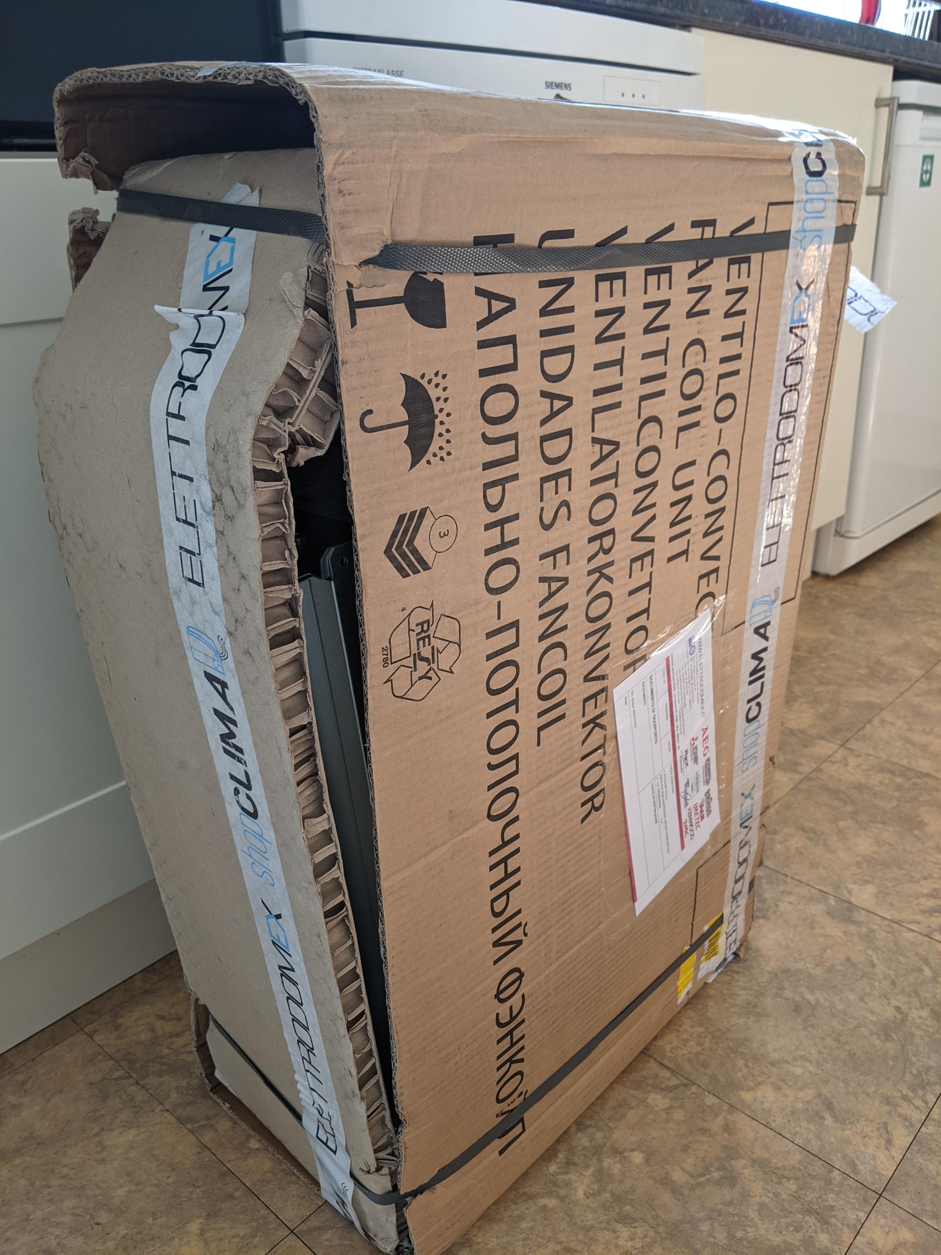

It has arrived! Although the box it arrived it was 90% destroyed, visual inspection it seems ok and mercifully the loose items in the box were still there. Next up will be an electrical and water (air??) leak test
€289.00 delivered from ShopClima, took about a month from order to on-site
Edited by joth
20 minutes ago, tanneja said:
@joth have you got the direct link to the product to hand?
I ordered this one
https://www.shopclima.it/en/panasonic-paw-fc-d15-aquarea-compact-fan-coil-with-left-side-connection-1-5-kw.html
It's clearly just a systemair unit: https://shop.systemair.com/en/scc202plg2/p402066
 (haven't worked out exactly which model number) - they didn't even bother reprinting the MI with Panasonic branding, says Systemair all over it

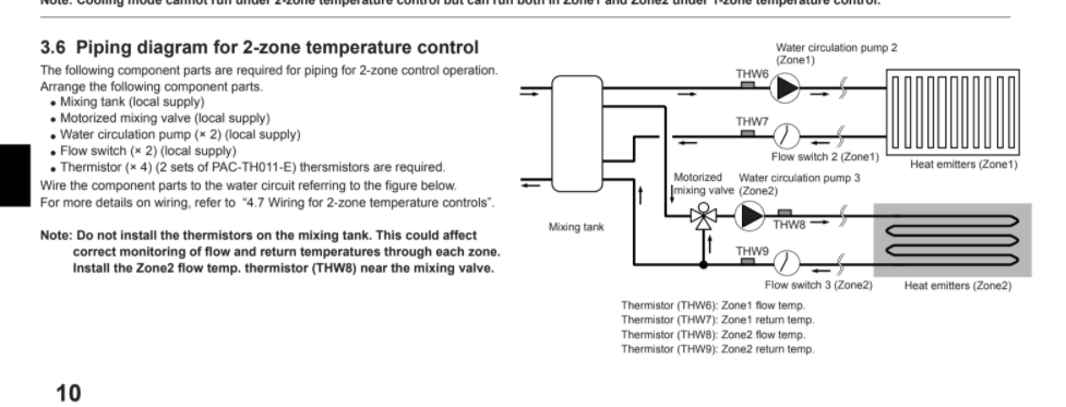

@joth  trying to understand how this all  works. You are planning to use the cooling function from the ASHP to pass cold water through the unit which is fixed on a wall to cool the room.
Do just tee off from the heating circuit into the unit and how do you stop the rest of the house being cooled? I have UFH with 3 manifolds.
The price is very good, was AC an option for you ?
We're using the mitsubishi FTC5 controller that has specific function to manage 2 zones at different flow temperatures, here's a snippet from the MI that explains it. Fan coil will be zone 1 and ufh zone 2, we'll set the zone 1 to a higher target temp so the fan coil should rarely come on. For cooling we'd probably reverse the preference so fan coil runs first.
