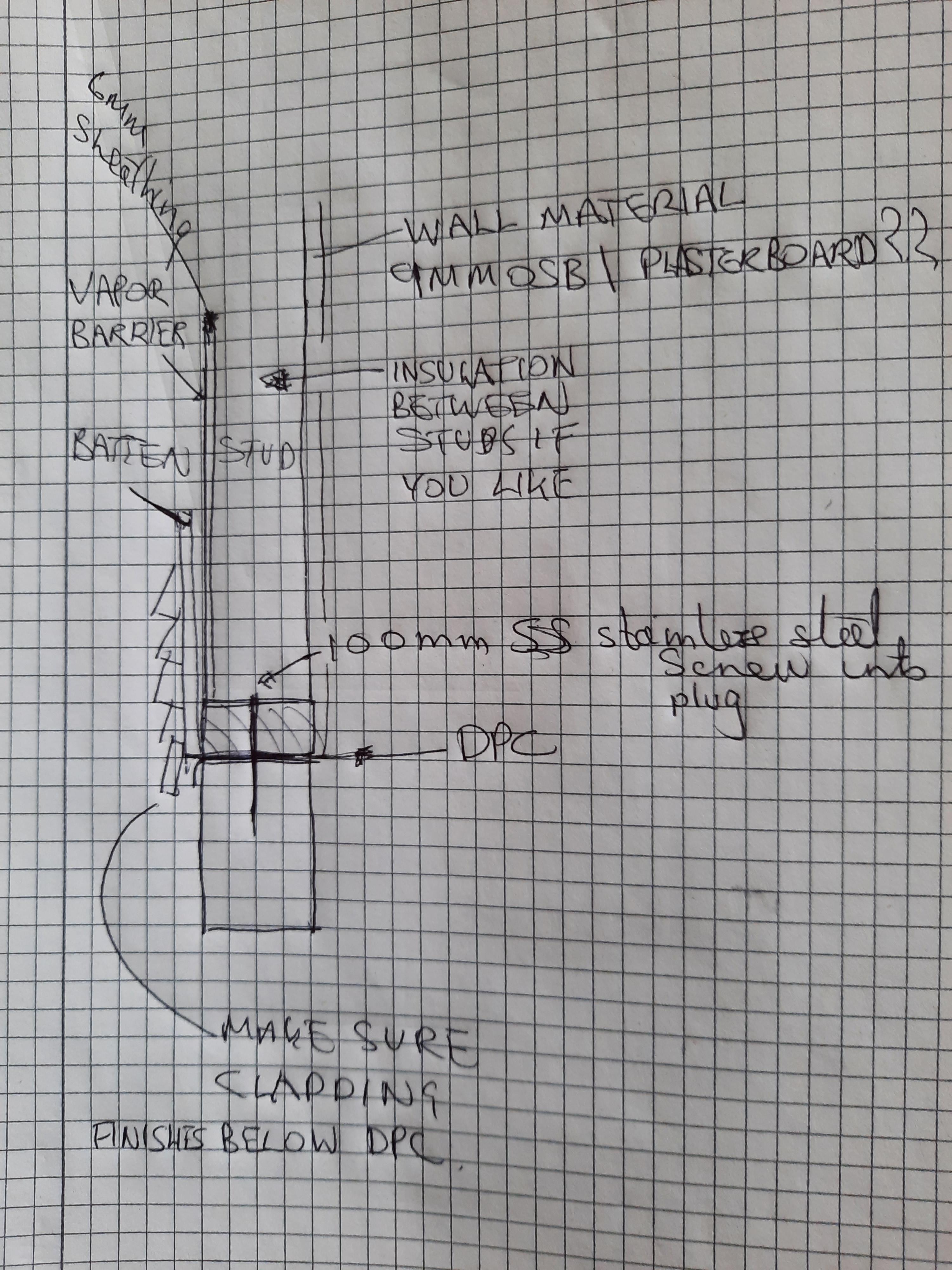

After the stud plastic sheeting to stop moisture getting in the wall. If its a workshop light OSB if yournot going to hang anything on the walls or 12mm thick osb if you are. Remember to protect any electric cables from the insulation if they are in the walls. Onoff also has great ideas and I'm sure will come up with other/better ideas. Good luck M -

If you build it like my shed then stainless steel screws every 600mm through bottom bit of wood into rawplug or easier a hammerfix! Make 1st coat after battening vapour barrier ( to let moisture out but not in) Make sure external cladding hangs below documents or it will drip into the workshop. -
Well you can insulate on top and this would mean the concrete would slowly warm up to the internal space, however it maybe difficult to avoid cold spots at joins with external walls which could cause damp surfaces. May be better as you say to insulate inside. However, more clever people will know others remedies I'm sure. Best of luck M
