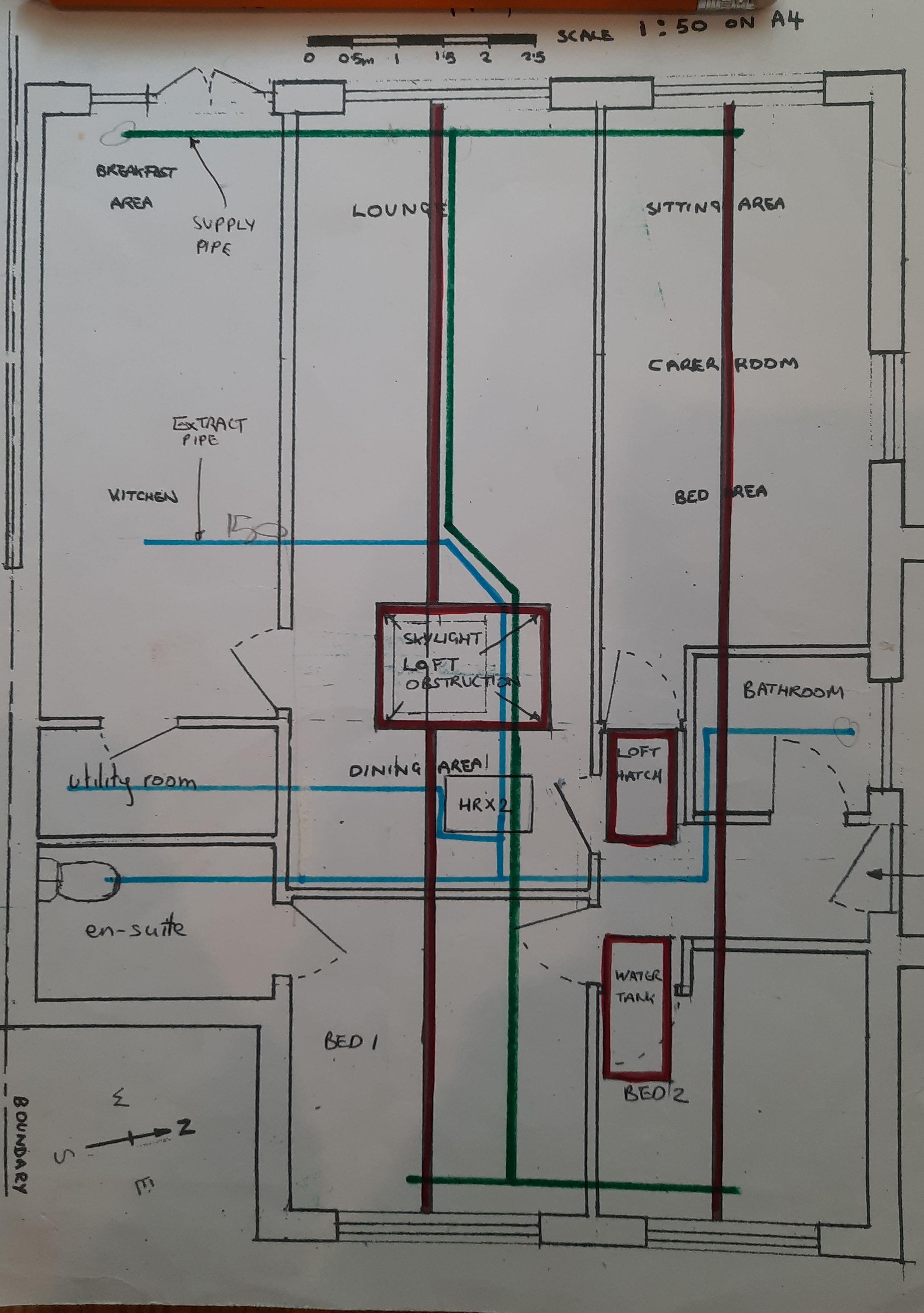

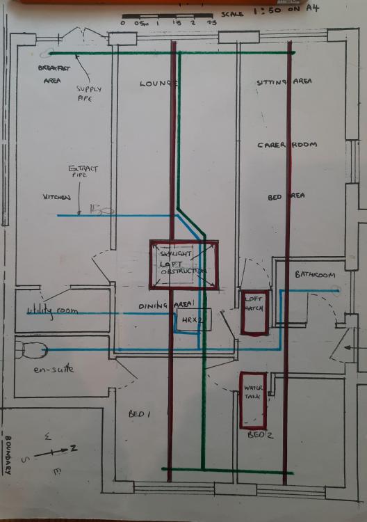

Mould issue in MVHR
Marvin replied to jfb's topic in Mechanical Ventilation with Heat Recovery (MVHR)
did you find the answer to this problem? -
