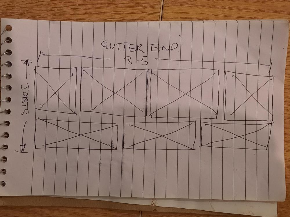

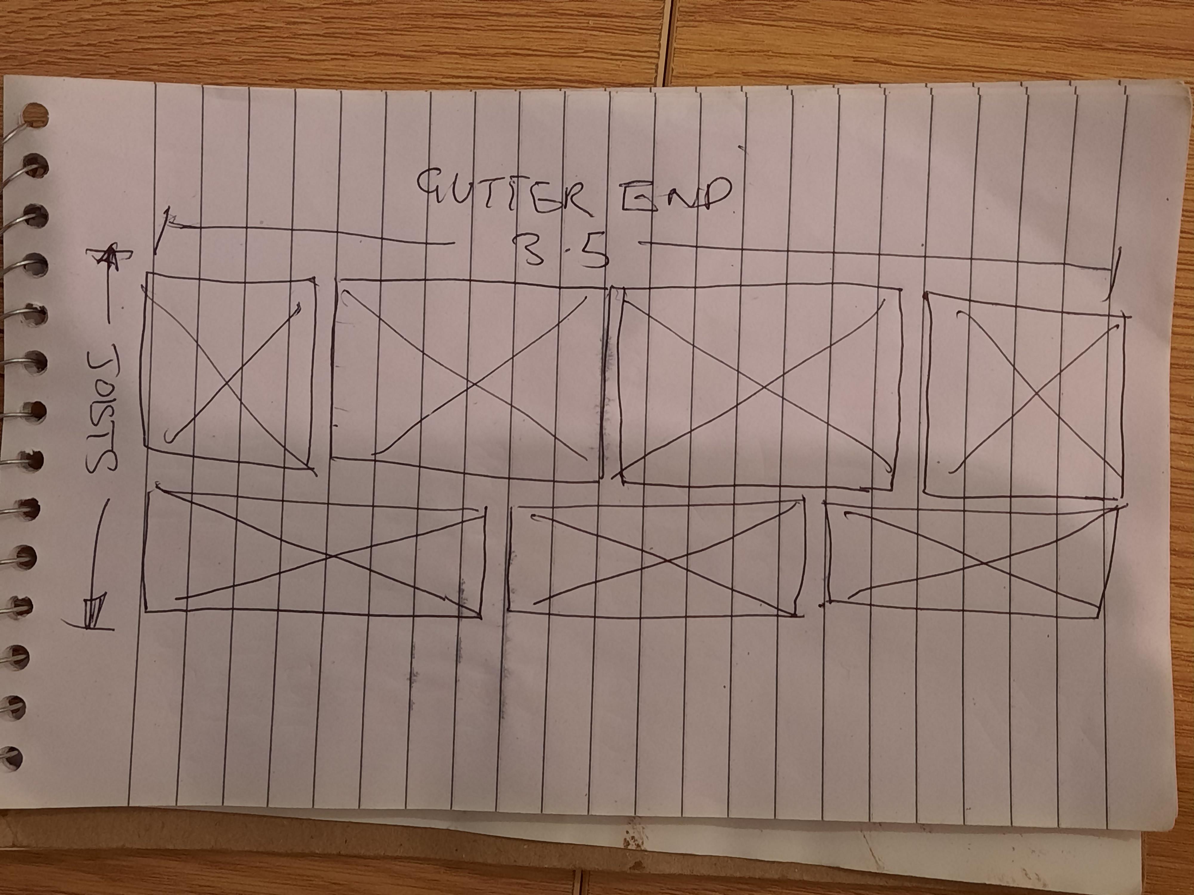

I think the boards, whereever their edges are need to be supported all along.

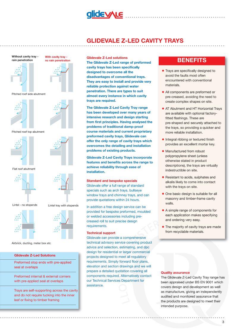

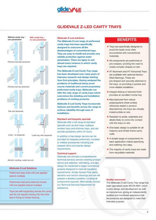

I didn't see if they were high water absorption ("suckie " not in the dictionary how I mean it) soft bricks behind the render or not and I have seen problems in that situation before. But do feel if it was missed, it should be done. Typical info:

Difficult one. Politely enquire with builder if one was put in. Check with architects details if one was specified. Check how the works were described. Be sure of your position first. Did the architect overlook specifying it? Did the builder miss it in the specification? However, both should know that a cavity wall tray is always required in this situation. Its usually part of my submission to building control (along with pad stones etc when required). Good luck. Marvin
Lead standards: Lead sheet for lead flashing should be no longer than 1.5 metres. If the lead is cut any longer it could lead to splitting of the lead work due to expansion and contraction. When fitting flashings they should overlap by a minimum of 100mm. This is a good general rule of thumb on how to cut lead flashing, but there are conditions where you may consider increasing this overlap, such as prevailing high winds, driving weather, and exceptionally high flashings where the overlap may become vulnerable to water creep.
You can buy retro fit cavity trays: https://www.google.com/search?q=retrofit+cavity+trays+installation&oq=retro+fit+cavity+trays&aqs=chrome.2.69i57j0i10l2j0i10i22i30.9944j0j15&sourceid=chrome&ie=UTF-8#kpvalbx=_WuyKYP23FYCFhbIPpYaw0AU15 Beginning to think its a multitude of possible answers but water entering the render running down inside the wall and no cavity tray, will, for my money do it.
