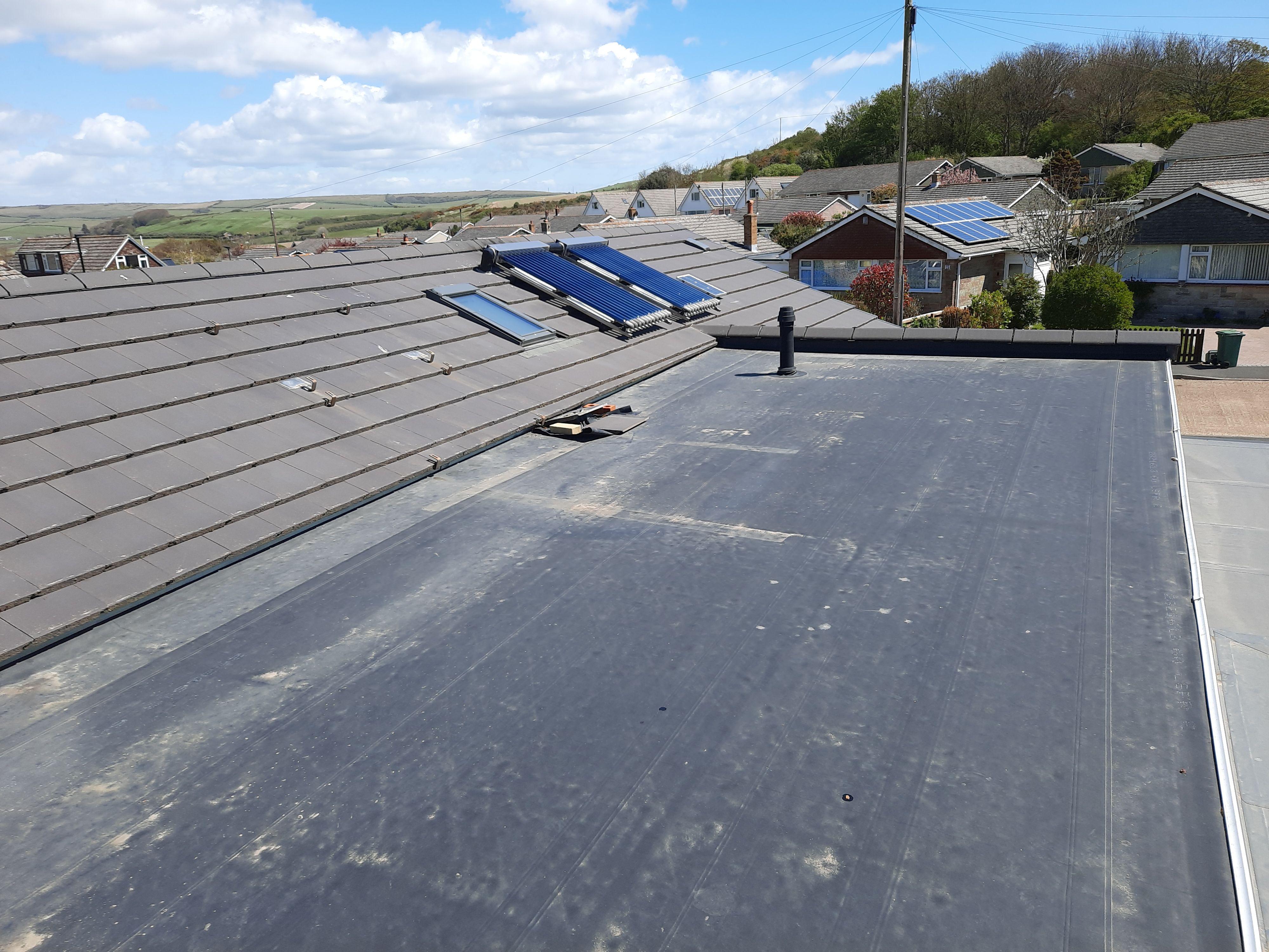

Not sure I can help with your quest but: If you search on Youtube videos for EDPM Roof installations you should see how the black flashings form the side edges to stop the rain water from coming off and the drip edge forms a drop so the rain water can run into the gutter. I can't see how these could be replaced with an aliminium flashing and still do the same job. The only thing I can think of is capping over the edge ones. Personally I wouldn't try the same with the drip edge. Best of luck Marvin

I would have said your roof in that area definitely doesn't leak.
