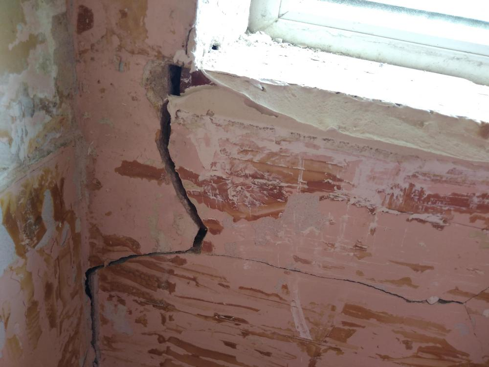

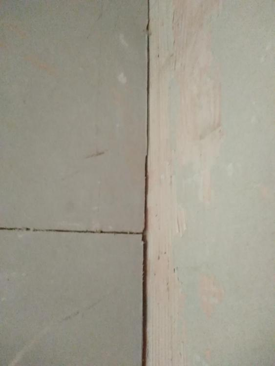

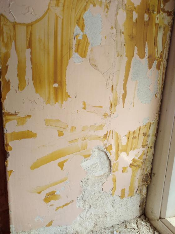

Help please for elderly lady who has plumber trying to cutting corners!
Marvin replied to Nico's topic in Introduce Yourself
It's very easy to be critical and some of the tried and tested techniques I use may be just as effective as the plumber's Also without knowing all the work details one starts guessing what would be right. Fill crack all way down. However definite concern about the possibility of movement cracks changing in the future: could cause tiles to come off the wall or gaps to appear in grouting or corner of room. Fill all edges, tile adhesive fine. But paint on waterproof sealant after. any type of filler to level gap and seal after. last photo not sure what it is. Don't like the idea of bits of old wallpaper still on the walls. Rawplugs I would run a sharp scraper over and that would cut them flush. Holes if small fill with tile adhesive as you go. The thing about existing coatings on the wall is are they going to stay there? If the gloss paint was widespread and slippery I would run a stanley knife and score it to give the tile adhesive a key. Shower tray down and sealed to walls, then walls tiled down to tray and tiles sealed to tray after grouting. Some trays have a upstand bit that fits in the wall behind the tiles... I assumes the floor is to be boarded before flooring? I use a lazer level to keep the same height all the way round when tiling and before that I used to draw a level line all around the room. Either way it didn't matter which wall I started on. However if fully tiled I would always try to finish above the door where small errors can be hidden. Anyway I'm sure they will sort it all out. Regards Marvin -
