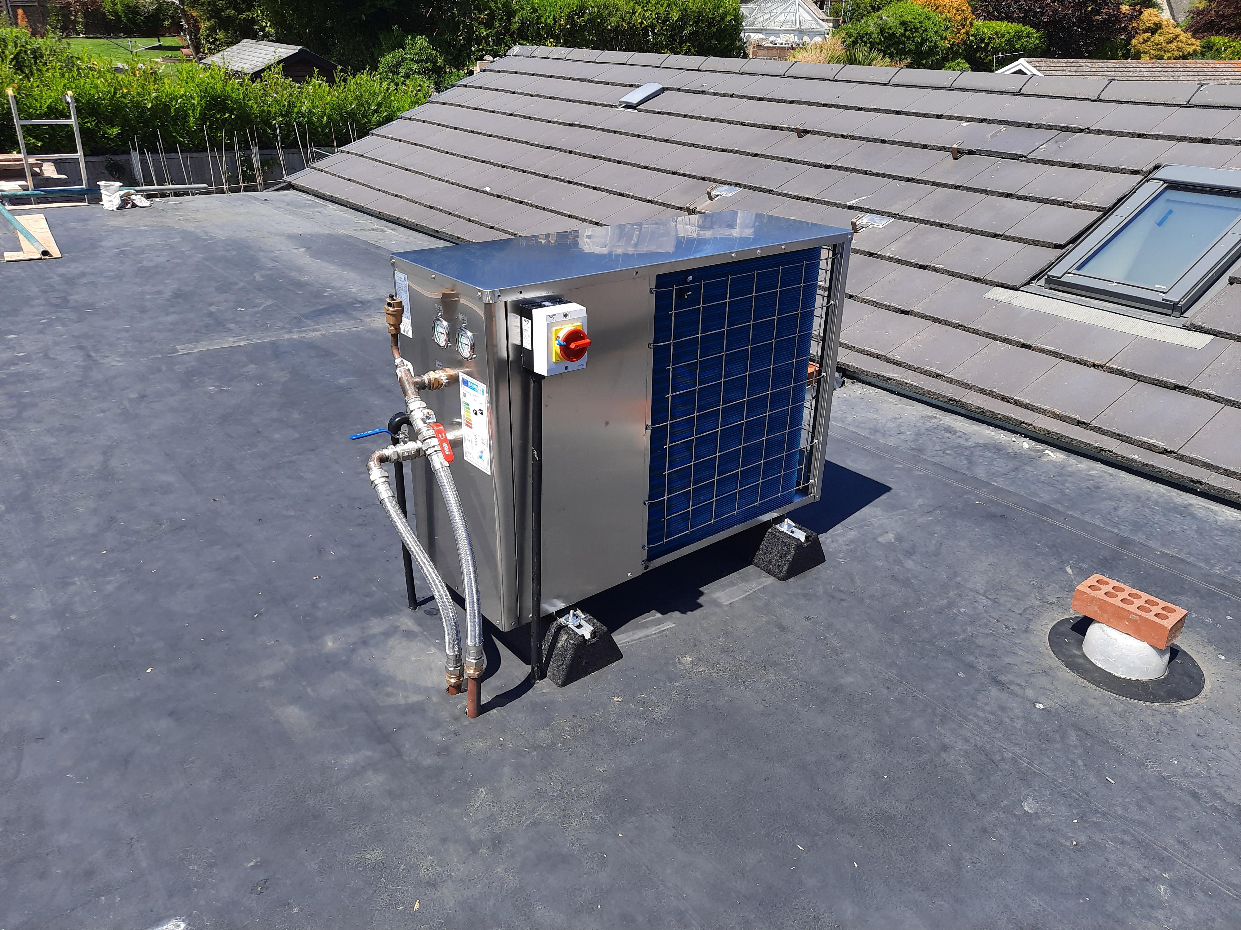

Once again a lot of sense from @Nickfromwales 👏 Our ASHP was installed on the flat roof about 8 month ago. Neighbours noticed box but no noise issue, not even over the winter when its supposed to be noisiest as the ASHP works hardest to heat the property. If there is a lot of noise there has to be something wrong with the sizing or positioning of the ASHP or the actual ASHP, or the way it's being used. Stick a car in second gear and do 50mph and that makes noise and eat fuel, so it the car crap? However, its worth considering all the AIM and APE elements before making decisions. That is Airtightness, Insulation, Mechanical Ventilation with Heat Recovery, and Air Source Heat Pump, Photovoltaics and Electric Vehicle. Some of these will not work properly without the others: A MVHR will not work properly without Airtightness. An Air Source Heat Pump will have to compensate for the lack of Airtightness and Insulation to the degree that the benefits become questionable, especially during winter, without them. An ASHP uses electricity and Photovoltaics can supply a little during winter and a lot during summer when cooling can be a problem and an ASHP can supply cooling. PV can supply a little to an Electric Vehicle during winter and plenty during summer if your vehicle is at home during sunny days. Extending a property and only doing AIM works to the extension will be no good, you have to do all the property within the thermal envelope. So if finances cause you to have to consider only a few in my humble opinion AIM first and go APE later. (but prepare the property for the APE works as much as you can). There are exceptions to properties which have AIM whereby the insulation is so thick that heating becomes a minor issue! Best of Luck Marvin
