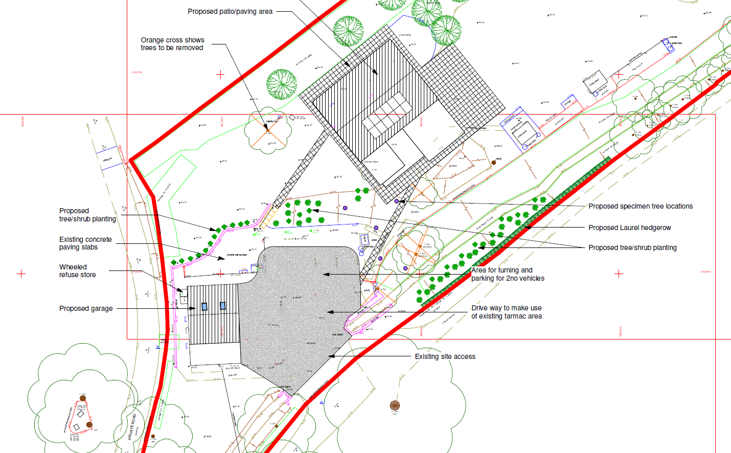

  2. Hi all, We have our planning app in with the local authority at the moment, we are working with a timber frame co. to provide a design and build wind and watertight package. They don't offer a groundworks/civils package so we are looking at establishing requirements, with a view to appointing a structural/civil engineer shortly. We have a soil report already and the ground conditions are determined as firm silty clay, med shrinkibility. Bit of detail on the site (see topo detail & proposed dwelling/garage attached)and what we'll need to incorporate into the design: Foundations & B&B Ground Floor - TF co. will provide structural loadings once they've completed the design & BRs. post planning approval. Site is pretty flat so I'd hope foundations should be fairly standard in nature (multiple fingers crossed!). Storm Drainage - We are off grid, our existing bungalow discharges rainwater directly into a small stream that runs along the front of our land within our curtilidge or onto the driveway or surrounding garden, all very Heath Robinson! Foul drainage - Again, we are off grid, the existing bungalow has a cess pit that requires replacement. We are looking at a sewage treatment plant solution, general consensus seems to be something with minimal moving parts, an air blower type (Bio Pure, Condor, etc). Our understanding is we will need to get EA sign-off to discharge the treated water into the stream for this solution. Need to consider placement of the unit so that it is far enough away from the house. SUDS/Soakaways/Rainwater harvesting - Given we currently discharge rainwater directly into the stream and it's unlikely we'd get permission to continue doing so, we potentially need to look at viability of soakaways (given clay soil), SUDS or rainwater harvesting solutions to offer betterment, we'll need some advice here. So a fair amount that we need to package up, design and get the relevant permissions and approvals. Does anyone have a view on how best to go about approaching this and could anyone recommend a civil/structural engineer that could assist us with it? Is there anything I've missed above that we need to consider and design in? We are based in Hertfordshire, is someone local necessary given we already have a soil report or would you suggest local knowledge of soil conditions be significantly beneficial? Any help much appreciated.

  4. Thanks Mr Punter & AliG, We did discuss another ensuite but it felt a bit excessive to have 4 bathrooms in a 4 bed house, the placement of the bathroom between and easily accessible from three bedrooms is an adequate solution here we feel. Noted on the trees, we'll ensure we don't pick anything too imposing or that's going to grow to a unreasonable height or width. Agreed on point 1 on the shower, we will look to tweak this. The front door we'd assumed was notional, we'll certainly be looking at a more modern design so will get them to tweak as part of planning app. For the stairs we were looking at open tread (something like the below), the in-laws have a piano that my wife has plans to put under the stairs! We can increase the size of the exisiting cupboard toward the living room door and put a bench seat between the living room and snug (kid's room) doorways, we do have a fair amount of space to play with in the hallway.

  14. Hi all, Thanks for your feedback, really appreciated. It's easy to think you've thought of most things, then sometimes you don't see the obvious! Moving front door - Good point, on reflection that does look like a pinch point, option here could be to move the front door 1.5m-2m to the right, then extend the canopy over the front door so it's covered, we could then shift to door to one side of the entrance and have a vestibule area with a cupboard to one side and lose the cupboard in the playroom, freeing up more space in there. The hallway may then be a little on the large size? Window hotch potch on North elevation - Will take a look at this and see if we can simplify, take on board the issue of heat loss. Ensuite upstairs - Thinking here was that with 3 x bathrooms already across two floors that would be adequate, 4 bathrooms in a 4 bed house feels excessive, a solution could be to jack and jill the upstairs family bathroom from one of the bedrooms, maybe removing the bath to make way? Large study - Main reason for this is that this space will house the wife's studio for her home interiors business (2m x 1m workbench, fabric & supplies storage, etc) as well as my home office so needs to be larger than your average study, the idea is that in future this room could be converted to a downstairs bedroom with adjacent bathroom if required. Playroom External door - Good point, will look to remove this as access out via the back door is pretty straight forward from this room. Two sets of sliders - Alternative here could be to mirror the upstairs master bed picture window downstairs, I think aesthetically that would improve and simplify the rear elevation. Utility & pocket doors - Will see if we can shift the plant room door to the right, this could give us more worktop space. We could reduce size and add a bit more space to the playroom by shifting that wall to the left a little, but there's potentially a fair bit going in this room, washing machine/tumble dryer, doggy bits and bobs, bench seating which was the main reason for the size. Landing size - The idea here was to incorporate storage and house a 'library' wall, hence the size, this window does offer nice views to the front of the property and mature trees so we liked the idea of perching here with a book! Walk in wardrobe - Will look at configuration options here to simplify and make furnishing a bit more straight forward. @Bozza External materials wise, we're thinking standard brickwork for the main dwelling (a fairly subtle multi blend), standing steel roof (possibly extending this down the SE elevation, vertical cladding for the pop outs and either standing steel/render for the canopy.
