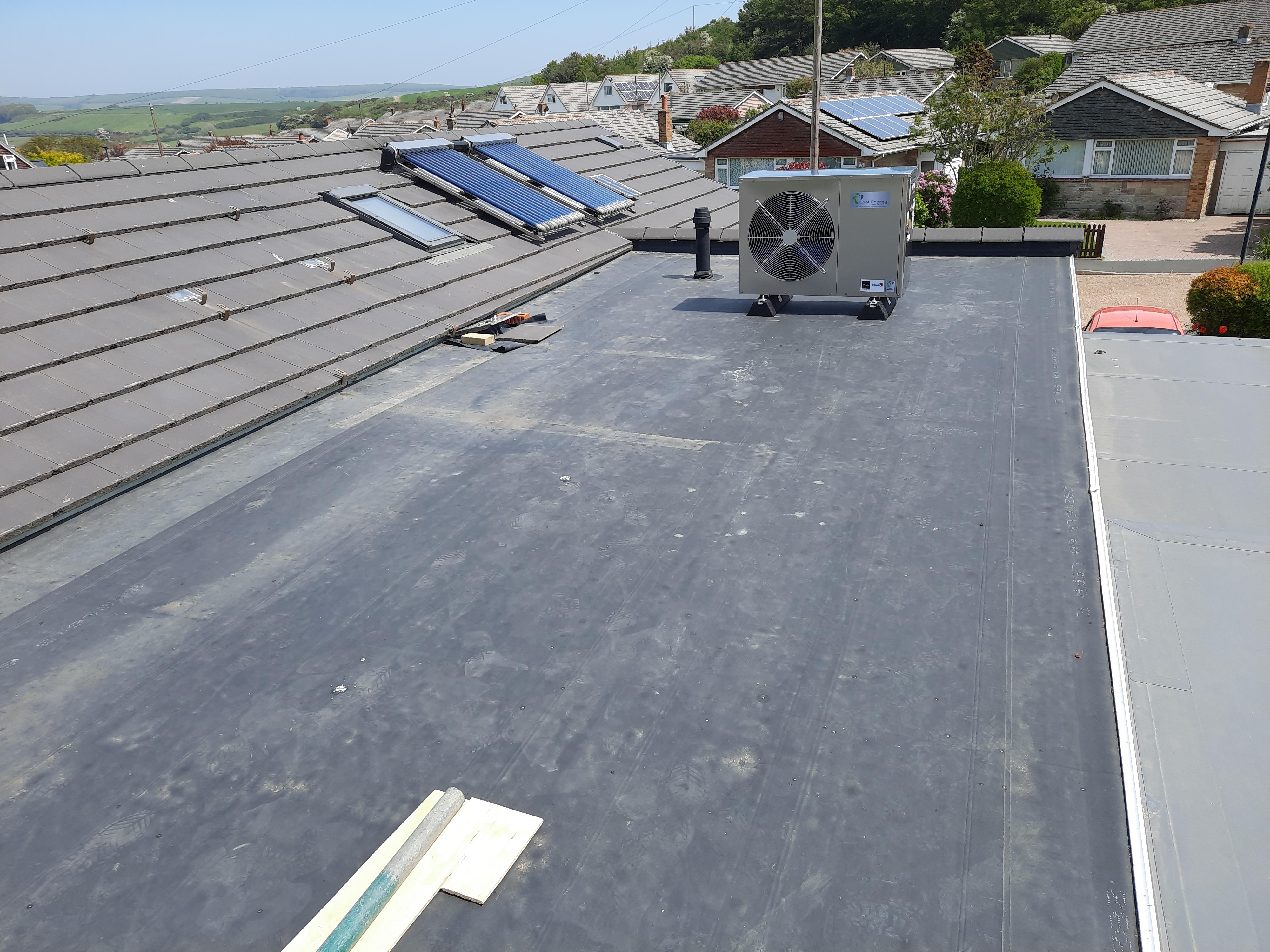

Hi @Conor Definetly need somewhere for it to drain. Our one, we have no vibration problem. IMO weight is an issue if you are expecting the unit is to stand on the rubber feet. To much like stilettos! You need a UDL Uniform Distributed Load over the ground below, that's why they recommend a concrete slab. The CE-iVT9 is 80kg. I would go for compacting the ground, placing blocks flat on top with ties or some form of binding around the perimeter to stop them spreading and an OSB on top with DPM and moniter the movement. I was advised to tilt the unit so the fan side was slightly higher than the back for drainage so I would tilt the blocks and board. Ours really does not vibrate significantly. We have the feet on EDPM, and it has not moved in the last 10 months or through the 120mph storm that hit the island although being on the flat roof totally exposed. Good luck M
