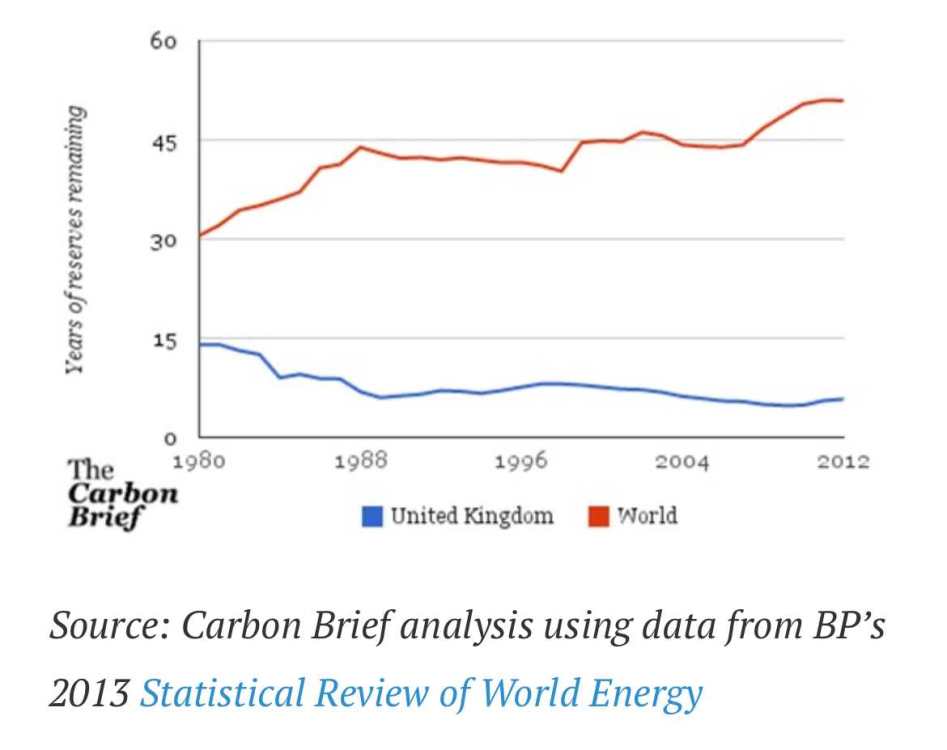

  15. That’s not true. Half the world bases oil prices against the benchmark Brent Crude, which comes from the North Sea. It’s light sweet oil that is perfect for making into transport fuel. There are also heavy oil fields in the North Sea. Some as yet untapped. See the Bentley field. I don’t necessarily disagree with some of this. Neoliberalism has turned out to have a lot of downsides. But the country was in a terrible state in the 70’s. It wasn’t all sunshine and butterflies. That makes little sense if there’s no demand for it then. Perhaps renewables/nuclear or something else will be the future. Or perhaps not. But either way you can’t shut the whole industry down, lose all the experience, skills and infrastructure and expect to just turn it back on in a few decades. Naive in the extreme.
  16. What possible sensible reason is there for leaving it in the ground whilst we import the same product from abroad at additional cost, with no benefit to the treasury and impact on certainty of national supply? In all honesty net zero is not my biggest concern. High energy prices are. We need to reduce them as much as possible and any number of benefits will shortly follow. If the plan is to steal a march on other countries by going renewable early, and it means we can compete then great, but I’m very sceptical. China will keep burning mountains of coal for generations yet imo. Whilst we get poorer.
  17. You make a good point re the price of oil. I stand by my view that there is more there than the booked reserves though. We're kind of arguing over nothing though, as I think we're agreed that we shouldn't leave it in there whilst we import from abroad. Nor should we rely on it long term (decades ahead).
  18. It’s old data, but backs up my point that oil has always been ‘running out’.
  19. I don't agree with that analysis. I'm not an expert, but I do have some experience in the oil and gas sector. UK oil and gas production and to an even greater extent, exploration, has pretty much been taxed and regulated out of existence in the past 15-20 years (maybe more than that, but before my time). You can't book more reserves if you don't drill the wells. And it just hasn't been happening for a long long time now. I still keep in touch with people in the industry and they tell me (perhaps overoptimistically?) that it's out there, there's just the wrong environment in place to go looking for it/extract it. We were all told when we were at school that oil would run out in 20 years, or we're now at or very close to peak oil production. Both predictions have proven to be way way wide of the mark.
