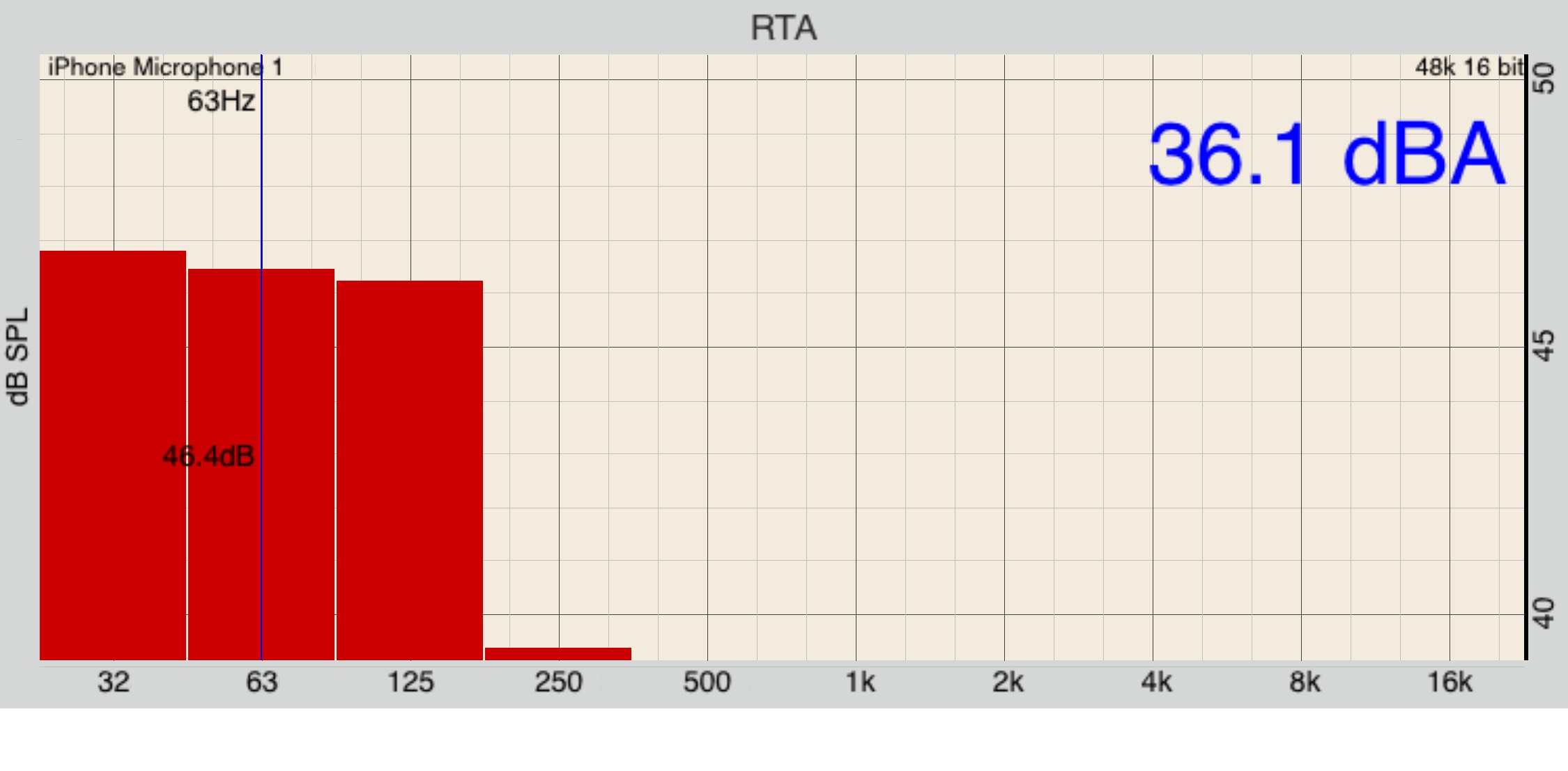

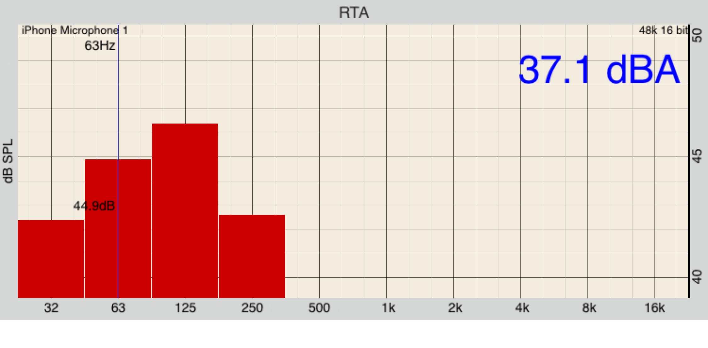

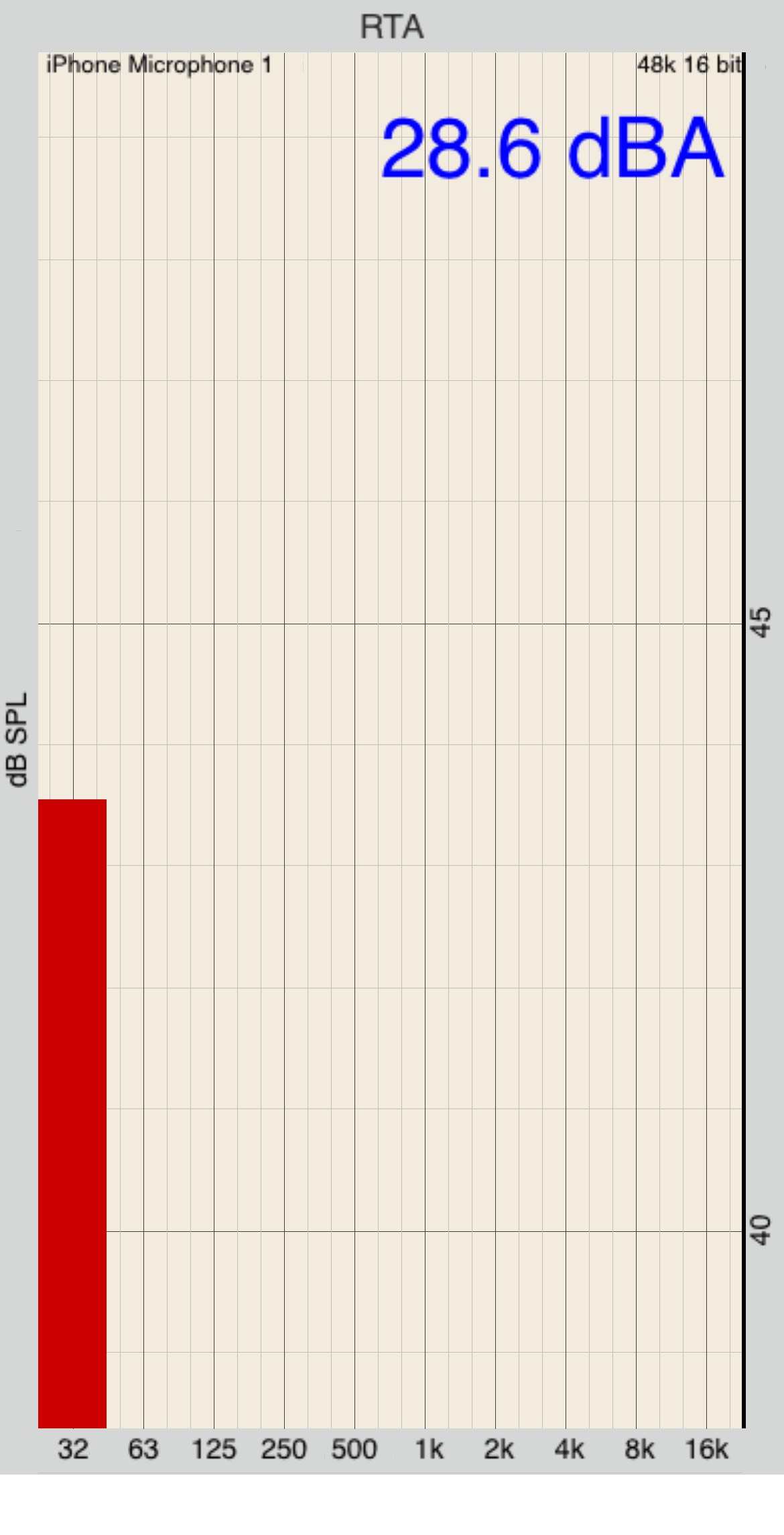

  1. Not sure how I missed that. I just downloaded it, but not sure what I’m doing. The 1st picture is with phone microphone a few mm below the centre of the terminal in bed 1. The 2nd picture is the same test in bed 2. Obviously the results are jumping around a bit - possibly as I’m not that still! Only a snapshot in time, but it does appear that bed 1 is slightly more weighted to the lower frequencies than bed 2 for whatever reason. unit currently on 30% as someone in the bath!
  2. If I had any idea how to get hold of or use an audio spectrum analyser…!! Are there any iPhone apps any good?
  3. I’m 99% sure it’s noise from the unit though. If foam lining the manifold did absolutely nothing, then I doubt lining the plenum will?

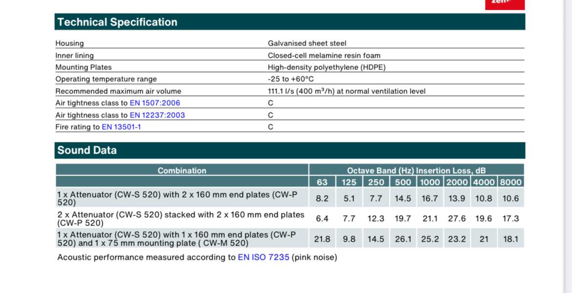

  5. Which flexible attenuator did you use on the ductwork to bedroom? How did you adapt it onto the semi rigid ducting? I have a double run to the bedroom

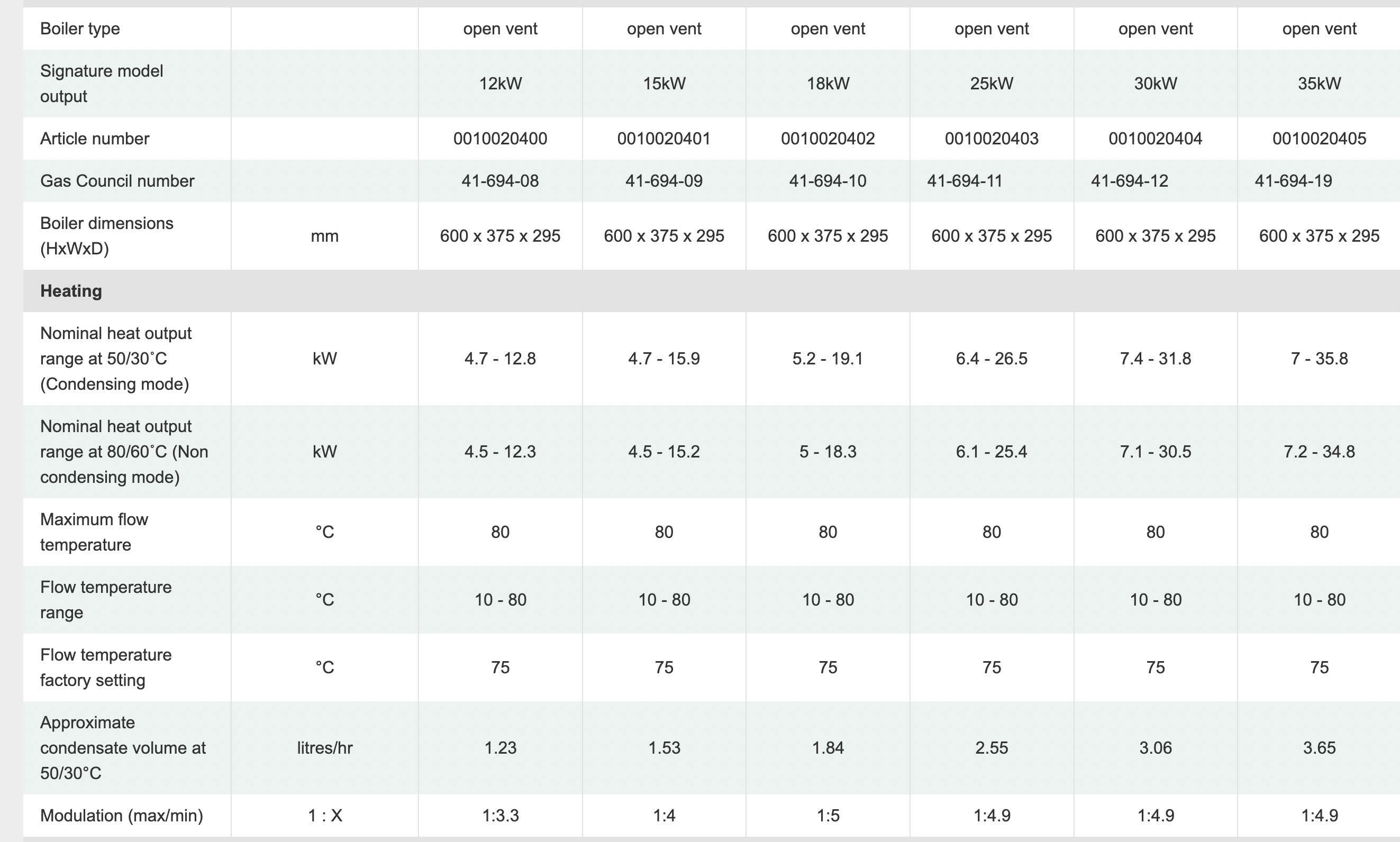

  7. Leaving aside any comments re why I want to know/is this a good boiler at least initially... Can anyone explain why the figures for nominal heat output and modulation don't seem to tally up with eachother. Interested as much as anything and can't find any info.
