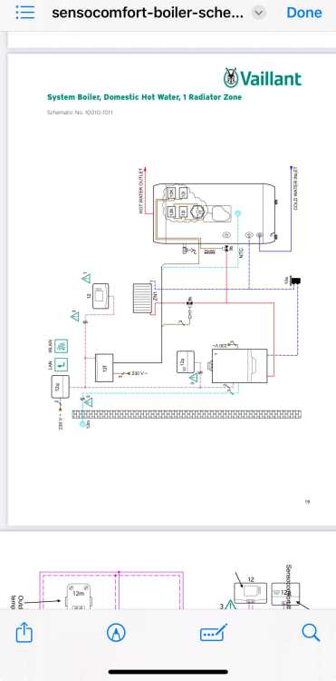

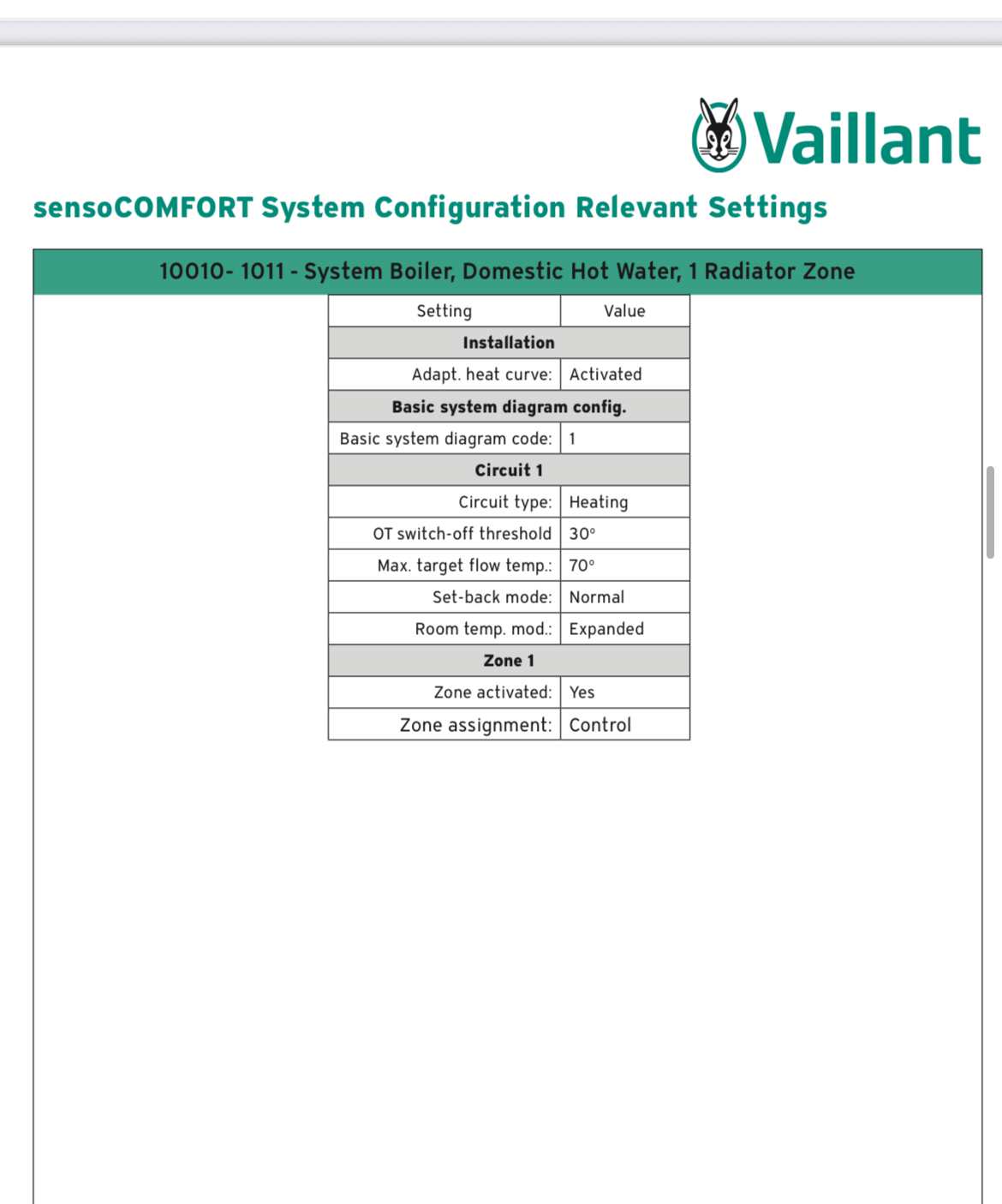

No, as that’s not what the manual says. I’ve just had another look and reminded myself of the relevant settings in the manual. I’m fairly sure they are all set to the below, but I will check them tomorrow. Perhaps the zone isn’t set to activated or something. Not sure why Vaillant make things overly complicated, but also their instructions are not the most intuitive
Outside air temp was 22.5 earlier. Desired (target) temp was 30 inside temp was 23.5 outside air switch off limit changed to 35 Heating set to manual on not sure what else I can do!

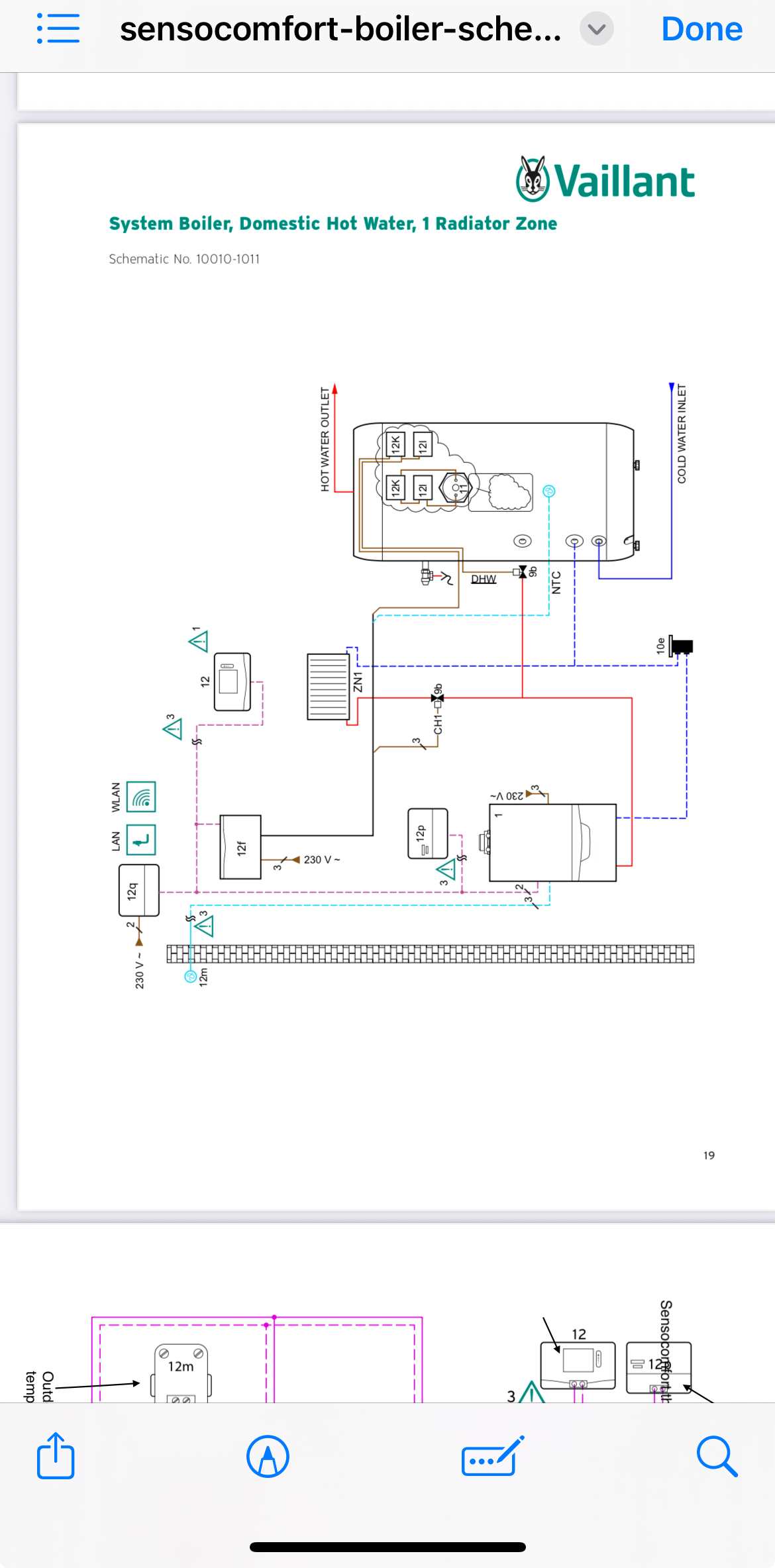

There is a connection for an external stat, but it’s linked out already as per the wiring diagram!
Weather compensation curve set to highest possible setting!

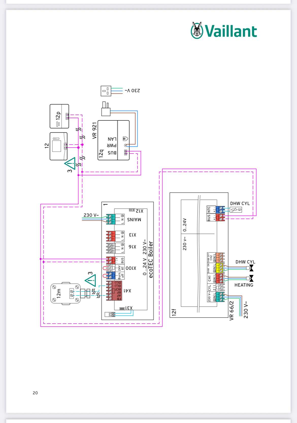

No room stat other than the VRC720, which is talking to boiler as all information from boiler available on VRC720 and hot water controlled from VRC720 turns boiler on as expected. Maybe there’s some setting somewhere that means the boiler thinks there another room stat - which there isn’t.
Tried turning off the DHW and also when the DHW is up to temp, still doesn’t turn on the central heating. No radiator symbol on the boiler, valve doesn’t open and S30 status. Yes, it’s a system boiler. Thanks
Does anyone here have any experience with Vaillant boiler controls, specifically VRC720? My parents have just had a new boiler fitted. Ecotec Pure 618 and nobody can seem to get the VRC720 to switch the boiler on when it’s calling for heating. Boiler showing status code s30 - thermostat is blocking heating mode. All connected together with Bus cables as per instructions and everything works as it should including DHW valve opening and boiler firing. It’s wired to a VR66/2 - dial setting 1 for monozone. Also has outside temp sensor and set up as hot water priority. Guessing it may be something to do with outside temp being too high, but changed that setting to 35 degrees c, so it shouldn’t be that stopping thermostat from sending signal to open valve and fire boiler (neither of which are happening) Should be going there again to meet fitter on Monday and probably call technical support, but would like to be armed with suggestions! Cheers
