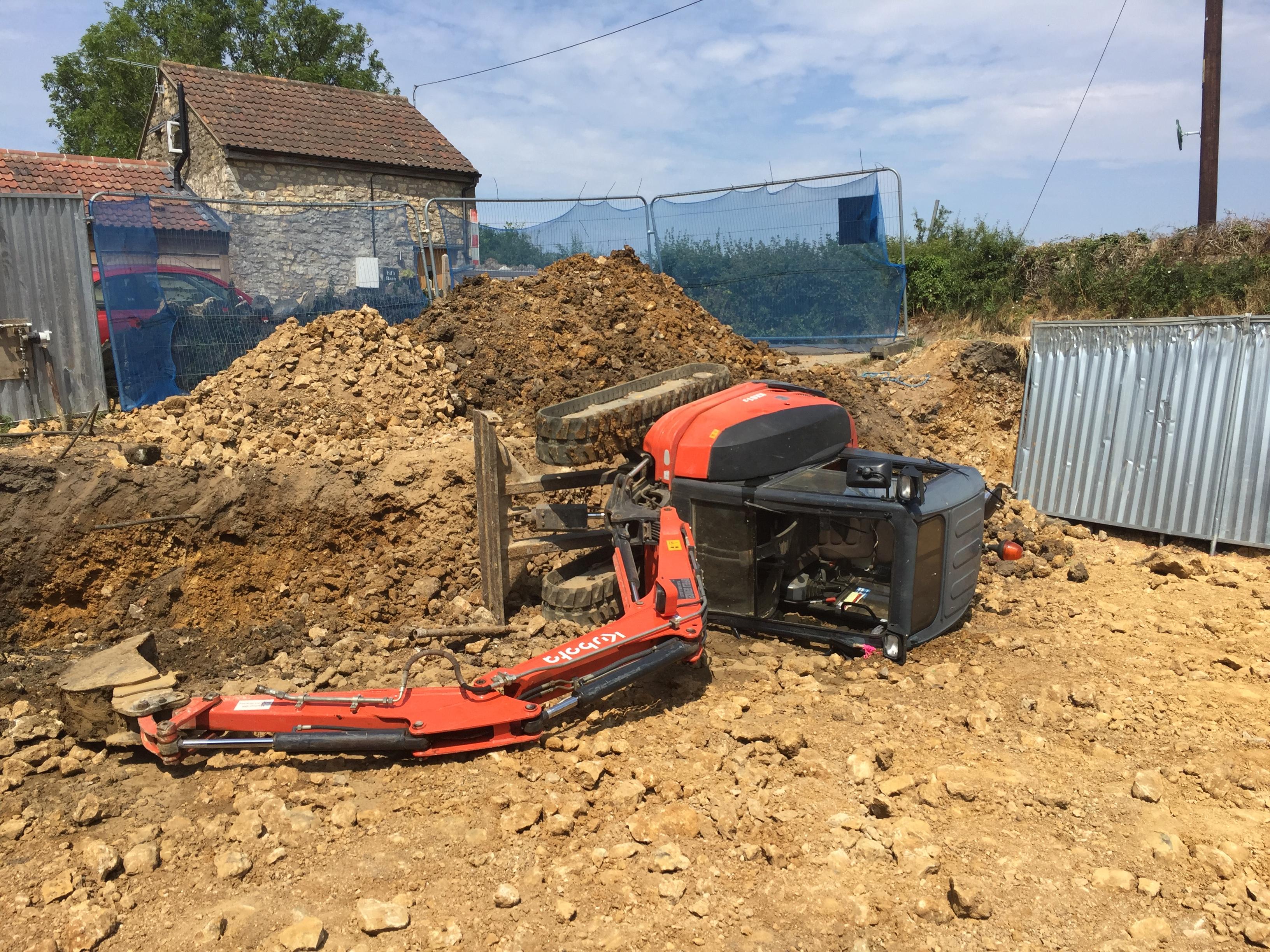

A reminder of the risks of diggers…
willbish replied to Dreadnaught's topic in Project & Site Management
I toppled a 3t digger back in July and was lucky to come out with only a bruised ego. Door open, no seat belt on, working on my own... Fortunately the hire insurance covered for incompetence! As the cab needed replacing. These machines have the potential to be dangerous beasts even in experienced hands. Not that I'd consider myself experienced but I've learnt a lesson about their limitations. -

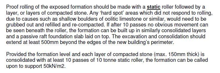

Ah yes I do remember reading that in one of your posts @JSHarris Considering my building is of a heavier construction to yours (ICF) and a full two storey, I could assume twice the ground bearing of 20kN/m2 Me thinks a 40kN roller will be on hire next week...
@PeterW that extract comes from the Ground Investigation report, the Structural Engineer is following it to the letter. I'm inclined to think he is being overly cautious (again) rather than incorrect. His 50kN/m2 ground bearing figure has been remarked as surprisingly low
@vivienz I'd say that's about 40kN model
My cautious ground investigation stipulates a 10 tonne static roller be used for compaction... I've just been looking through the hire catalogue and 100kN of force is a LOT bigger than I was expecting. So much so that I don't think it would be possible to get such a machine down to the required level without a crane/large hiab. An 80kN model doesn't reduce the size much. Can I compromise further without jeopardising the integrity of my foundations? Many people who have been to site, including a surveyor commented that the ground is excellent. Large fragmented stone, no organic matter. A ground worker who came to quote said he thought I could build straight off of it. What size machines have others used to compact the type1 on their rafts?
