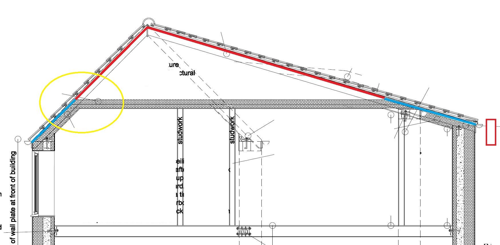

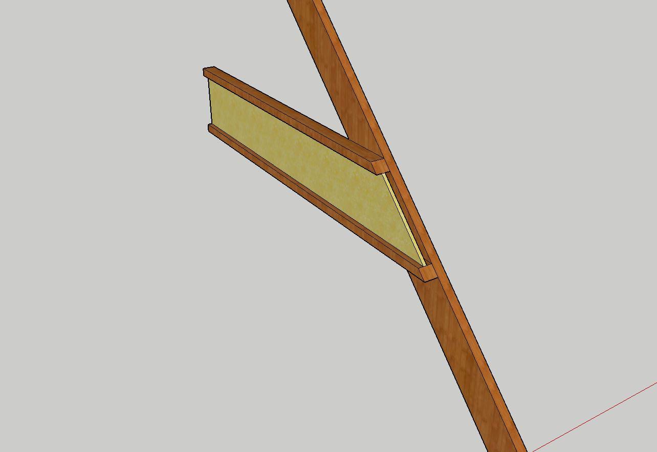

Nada, will bung them an email tomorrow. Yep that's what I'm imagining. I would also think the top flange would need supporting to prevent any rotation The wall plate is lower. The rafter sits on the wall plate in a traditional way. The SE has said select joists from a standard span table. They are not part of the roof structure just ceiling joists. But the span is 6750 so solid timber isnt really an option. Most joists will have a stud wall or two to bear on but as these aren't structural I don't want to rely on them (might change layout one day). Also its only an attic with low loading. It doesn't need to be future proofed for a loft conversion; ridge height is too low, oh and the bats have priority! Just exploring options really and thought Id see if JJI was a possibility -

Thanks @Ed Davies, Looks like green slime heading my way! ? I hadn't acknowledged the differing units of vapour permanence /permeability/ resistance/ resistivity, I'm not pretending I understand these differences yet. For me the Ubakus model is difficult to use because I want to experiment with different roofing membranes; my ecologist has specified a traditional bitumen felt membrane for the bat roost however this conflicts with using full fill insulation in the rafters. My current thinking/aspiration is to use a vapour permeable membrane for the eaves sections along with full fill insulation, then where the loft space starts transition to bitumen to keep the batman happy. There will be no insulation in the loft space rafters. If anyone has any other bright ideas /suggestions that would be great.
