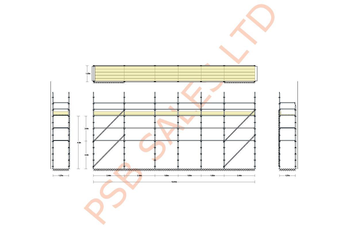

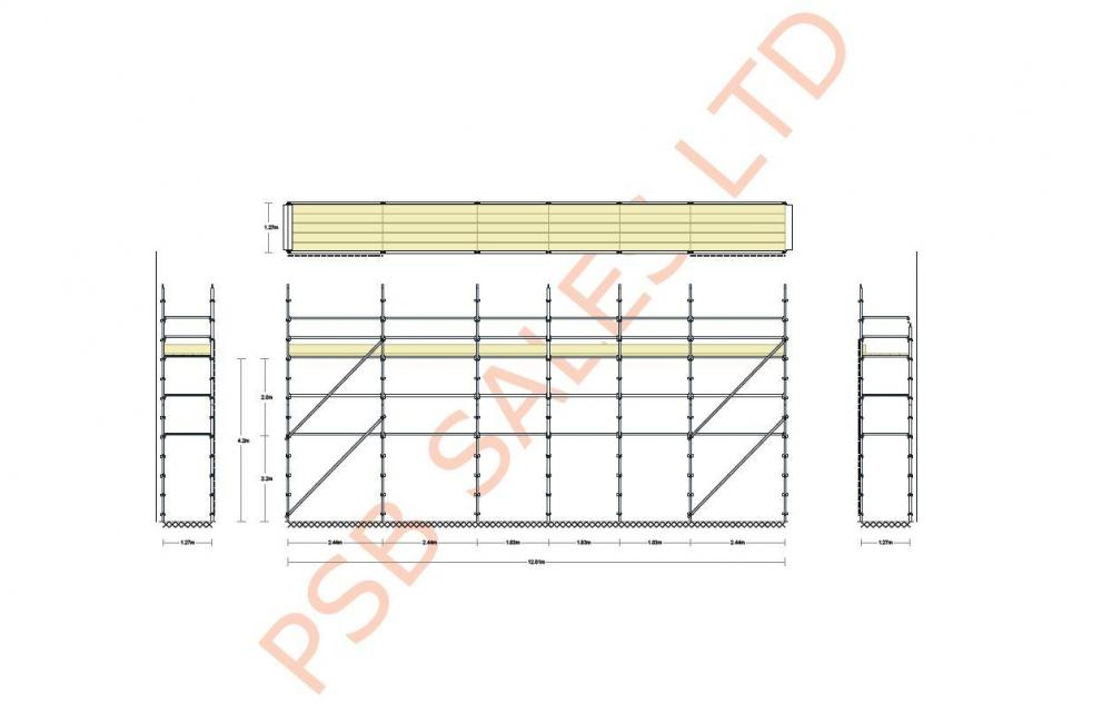

These guys have some Kwikstage design software. I got a couple of drawings from them showing all the bits I needed. Ended up buying elsewhere cos they couldn't match the price. -
