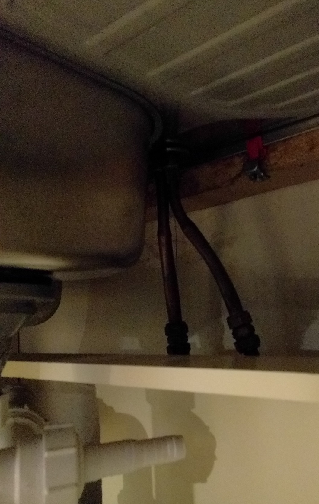

Thanks! Got myself a basic draper one that should do the trick...
Hi, Plumbing 101 question! I fitted a water filter under the kitchen sink which feeds a separate tap. The new tap is still a bit loose and can swivel easily. I need to tighten the nut under the sink but it's at the back left of the sink unit. Simple question - what's the best tool to use? Should I buy a basin wrench or try with a pliers? Thanks!

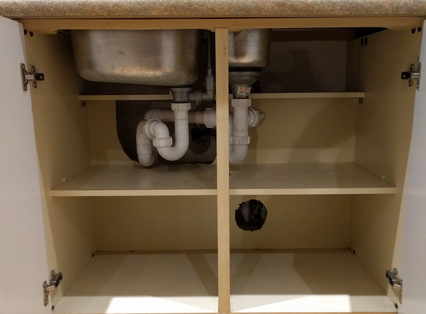

Hi, I bought a water filter kit for under the sink - reverse osmosis & uv (cherry flavoured!). Anyway, I can fit it under the sink after taking out a shelf but I'm worried about the saddle valve after my escapades last year with plumbing.... The hot water feed pipe is straight enough but the cold water feed bends a fair bit. Both are copper. My concern is getting a good seal with the Saddle Valve and avoiding leaks. Are Saddle valves prone to failure? Would a T-Piece be better? There might be a place to install it on a short horizontal section that tees off the cold feed and goes out the back wall of the house to a tap there, I'll have to remove the thin-ply at the back of the sink cabinet to see it though.... Any thoughts appreciated. Pictures: Under Sink Two feeds to mixer tap - left is hot, right (bendy one) is cold View from Left - potential connection points off cold feed - lower is larger 22mm? feed to attic cistern probably, upper one is smaller bore to outside tap:
Thanks - not sure how much of a can of worms I want to open here yet so I'll check out the vinyl click flooring for sure and try to avoid drilling through any pipes!! Cheers.

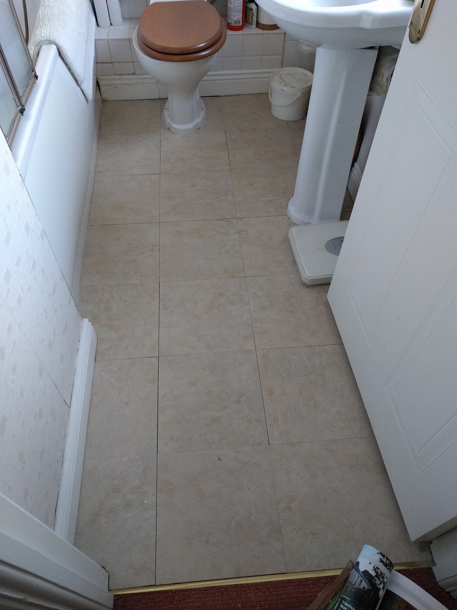

Hi folks, Tiling a bathroom basics! I'm looking at the 1st floor bathroom floor as my next project. It's currently laid with old vinyl tiles and experienced a flood in the last year so it knobbly and uneven. I've been checking youtube videos and wanted to see how much work I'm letting myself in for and how long the bathroom would be out of action for. It's not a big space - 1.7m x 2.3m in total (including the bath). My main questions are as follows: Will I have to remove the toilet and wash basin? Or can I cut tiles around them? What should I place on top of the timber floor and beneath the tiles - plywood? One big strip or layers? Anything else? Should I just do the floor or go further? The box behind the toilet got wet when the cistern flooded the room....not sure if I want to open that up.... Is it ok to tile up to the existing skirting and finish with silicone? Should I remove or trim the skirting to get tiles underneath? Porcelain, textured tiles I hear are best to provide some grip on a wet surface? Any tile recommendations? Is silicone against the plastic bath siding ok or should I tile that area to? A friend suggested using magnets to create a removeable siding feature there. The Bath does flex however which pushes down on the plastic panel.... I think that's it - this will give me an idea of what I'm taking on or if I need to grow more hair first....!! Thanks.
