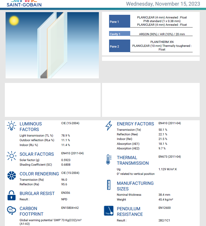

Should we attach plywood to large west-facing windows in storm?
craig replied to LinearPancakes's topic in Windows & Glazing
Thanks, I'm writing our own one at the moment in excel purely for our benefit, as getting these calcs can be a nightmare at times. You'd think that by looking at it but some of these programs are still stuck in the 80s 😉😂 -
@JohnMo Do you mind me asking what program that is? -
I use https://skyciv.com/wind-load-calculator/ and https://www.omnicalculator.com/physics/wind-load / https://www.omnicalculator.com/physics/air-density I tend to enter the data into skyciv, then obtain the m/s and enter the m2 of the unit and assess the glass and unit requirements based on those results. I do have a program being built specifically for this but at the moment this is what we use. It is then for your SE to check this data and sign off (in Scotland it is becoming more and more common that is information is being requested for form Q). The glass size should be within the sizes defined these tables. Although it shows double, it only refers to the inner and outer panes in triple glazed units. -
