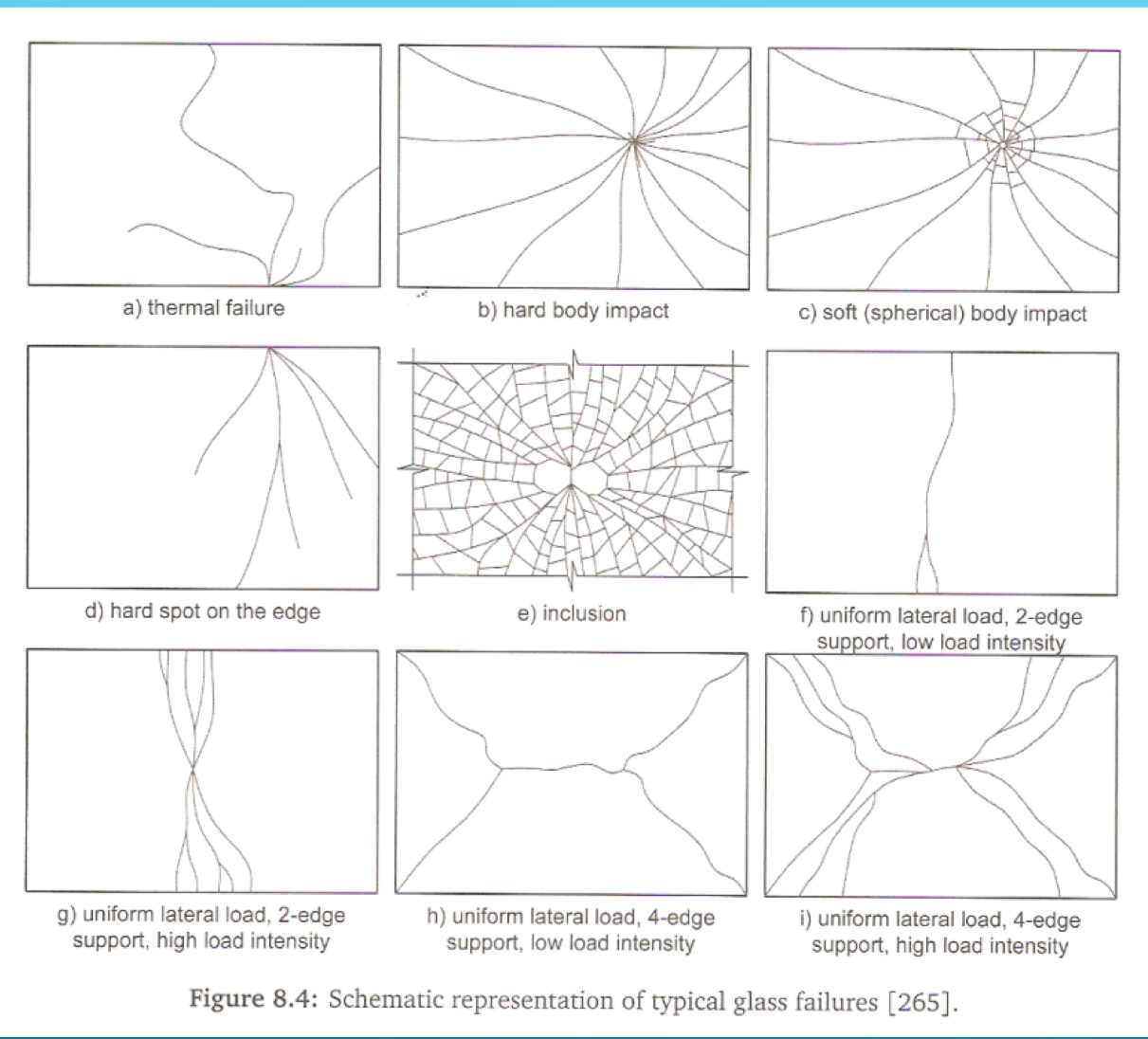

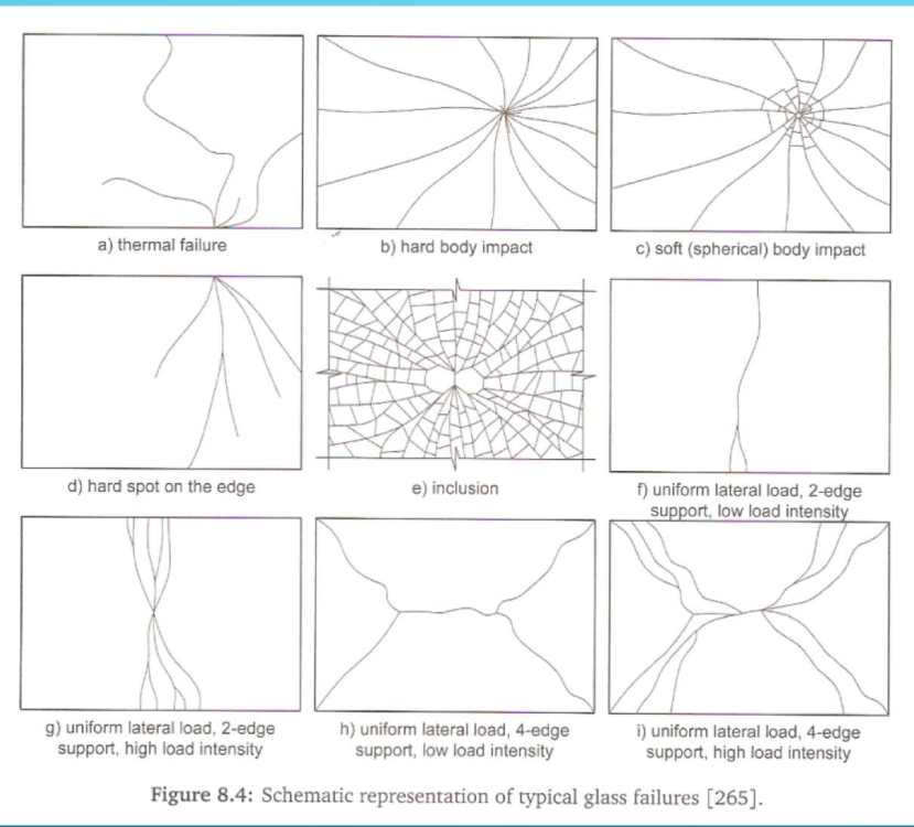

  2. It’s consistent with a stress fracture, can’t say it’s thermal with certainty but possible load stress fracture where the glass has been packed. Thermal stress fractures are not covered under warranty but load stress should be but needs to be proven. If Thermal, then a solid argument to use is has the supplier advised on the risks of not using toughened/heat soaked glass? Did they give you the option? If no, it’s their responsibility tbh. A decent supplier I’d expect them to take it on the chin “if” thermal and not advised of your options or load stress. The position of the crack leads me to “suspect” load stress tbh, as that’s the area of the packer.
