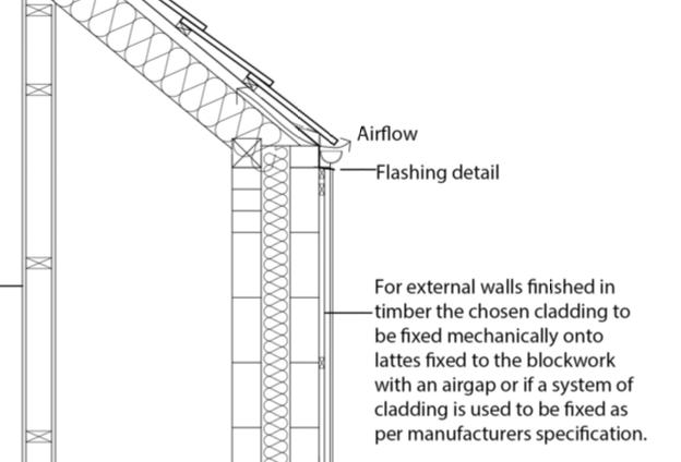

Thanks @nod, I will have a word with the architect, definitely don’t want the cladding proud of the brickwork it would look so wrong!
Morning All, I am looking for ideas to improve a cladding detail on our plans. Just received building control drawings from the architect. The section shown is a timber clad section over the (recessed) main entrance door. It is brick either side so they have replaced the brick with block and put the cladding on that. I would prefer the cladding to be set back from the brick face by 3-4 inches. Is there any way to do that while keeping the inner block in the same line? Thinking timber framing packed with insulation, vapour barrier, then lath and cladding?
