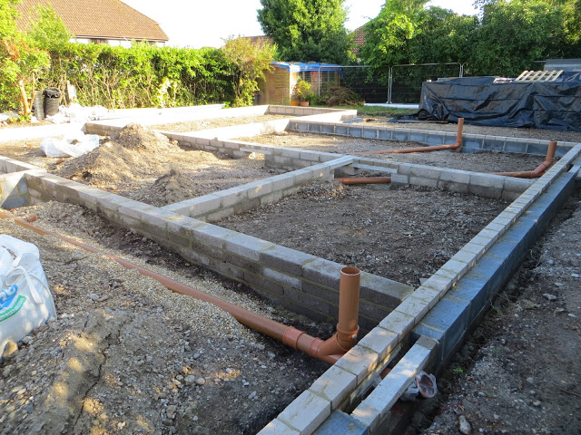

  7. Hi Nick. Thanks for the advice. I'm with you on this as the space under the block and beam floor lets me have very straight pipe runs and I really like the through rodding ability from both ends. I'm not on good ground either Ian with soft spots and high water table so it avoids things like path settlement & surface water drainage cross overs etc. As you say, workmanship and doing it right will be the most important issues. So, i'll be compacting the area under the internal lines, teram and 10mm gravel all through and rest bends / joints / junctions on a slab with mortar to pin them in place. What are your thoughts on pipe exits through cavity walls Nick? The obvious seems to be lintels leaving a fairly big square hole though I cant believe that someone hasn't come up with a better idea yet. What would you use to seal the holes - I can only think of some cement board?
  8. Hi Nick, Will get the BCO up next week and I've dropped the tecnical inspector a note too. However, if its a reasonably acceptable approach then the workmanship issues don't worry me. I'd still bed everything to falls on 10mm gravel and and set the rest bends out on bases / paving slabs etc. I usually like to pin them in with a brick or two as well so that they cant move if rodded etc - might do the same with the pipe as well. Other than that though I was just wondering what else others would do in setting the pipes out and keeping them in place and also how they felt about drainage done this way
  9. Thats what I thought Onoff - saves loads on inspection chambers in paths etc and just cuts down on the number of bends and places where blockages start. It would work really well for me as luckily enough most of my drain runs are straight lines so I can get away with only two external manholes and a few rodding points. Also just less clutter in the paths making it easier for services / surface water gulleys etc. Anyone got any details of how the floor under the beams should be prepared or are we just talking some pea gravel and mortar to pin the rest bends in place?
  10. Hi Vijay & everyone else, Sorry to open this tread up again but reading it and alot of other posts has caused me to have a rethink about my drainage layout. I'm having a block and beam floor and so far had planned for each internal stack to exit out to an inspection chamber through the cavity wall. However, looking at your drawing you have a lot more drainage internal under the floor than I had planned. If I took this approach it could save a lot in terms of chambers / having to stop up exit points etc. Since I started searching though I have now found an even more efficient approach in the attached - blog about Strawberry Tree Lodge (apologies to the owner of this but I did try to post a link to the blog but it wouldn't work). Here you can see that they have lined drainage stacks up internally and then exited one end to an inspection chamber and then at the other to a rodding point (see bottom right) - saving on chambers and external drain runs etc. Any thoughts on this anyone as I like the idea but have to get my head around having the runs under the floor
