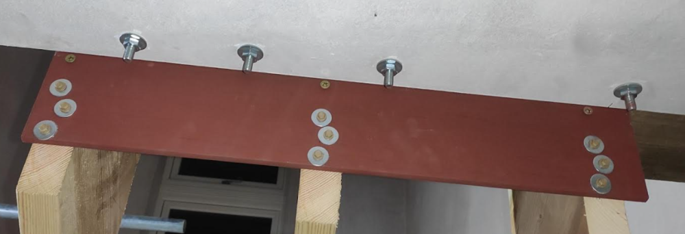

Does anyone know a Balustrade supplier with this type of fixing?
Gus Potter replied to Mikey's topic in Timber Frame
This is minefield! Generally the folk that supply the glass and track test it on a rig that is very stiff. When you look at the fine print of their test data they tell you this... but they don't take any responsibility for the fixings of the glass or glass mounting track to the supporting structure. Your general SE designs the principle structure but when you look at their fine print it often says "glass / track and fixings to be designed by specialists. So no one checks the actual fixing between the track and the main structure. The main reason for this is that the supporting structure can be wood/ concrete / steel etc.. everyone passes the buck... and for good reason as it takes time to do the calcs as every job is different. In Scotland everyone knows that the fixings must be checked and then you should produce a drawing which takes time too.. but in England (apart from Yorkshire folk who are in my experience very shrewed and clever) you are still often in the dark ages I have to say! It's ok I'm not a scot nat.. just yanking your chain... but if you followed the process below (and paid for that part of the design) you would not get into trouble. Below is a part of one of my designs for a glass balustrade that checks a side mounted track and fixings into a structural steel assembly. What I'm doing here is the bit that the general SE doesn't want to do or the glass and track supplier as both take time, effort and an understanding of the behaviour of what it is they are fixing the glass and track to. The funny looking equation is just a mixed up version of O level maths (quadratic equation) that you would have been taught at 15 years old.. if maybe been born before 2000.. it's nothing geeky. Most of the calculation above determines the tension and vertical load on the fixing between the track and what is supporting the glass. The tension in the bolt varies from track type to type and depending on what type of material the track bears against and what material the fixing go into. But make no mistake.. the material you are fixing into can have a dramatic impact on the bolt forces and the possibility that the whole thing comes lose. The above is for a fixing into a steel backing plate (the hatch suggests concrete but it is actually steel) but if fixing to timber the red bearing area would extend upwards and the forces in the bolts would increase a lot. The main thing is that a few mm in terms of bolt postition or a change in material can have a dramatic effect. That is why no one wants to step up to the plate! In summary the fixings are the key bit and what they are going into. Failure to check all the different parts will lead to disappointment not least. For all on BH .. if you are doing this type of balustrade then it is essential to follow the instructions.. don't make it up as you go along! @Mikey hope this helps a bit. -
