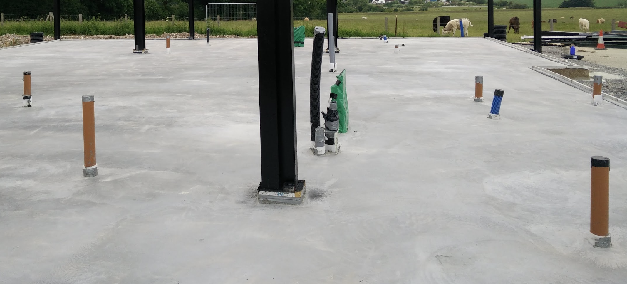

  7. Not for power, water, comms etc. just the ASHP supply and return is insulated. I used a rigid 100mm duct for power and did wrap the outside in a 20mm thick foam, where it was cast into the concrete floor. I did this with all ducts to reduce their chance of fracturing if they were ever knocked. Grey rigid in the background close to the centre was for power and comms, blue flexi is water, black (long) flexi is for ASHP comms and the shorter larger black one that's taped up is the ASHP feed and return. Brown rigids are obviously waste.

  9. Mine is in 100mm duct, through an insulated raft foundation, without any airtight tape. The largest duct we have through the floor is the pre-insulated twin pipe duct for the ASHP, which is 150mm.
