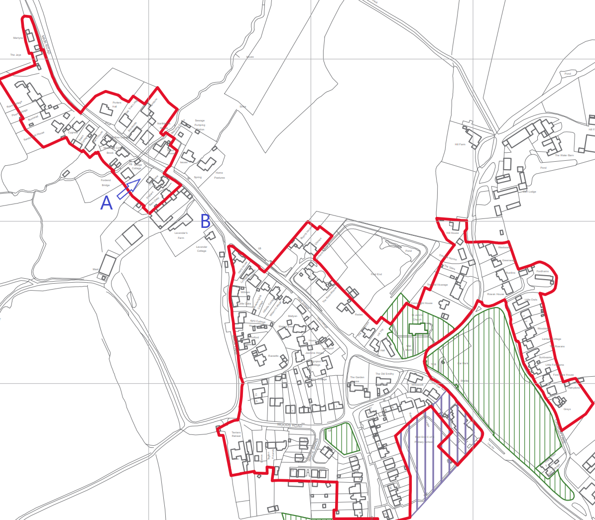

In this context, it's one and the same. The LPA's Local plan will have a set of maps included that define the "settlements" and their boundaries. In the rural context, the NPPF's "village" is within that boundary. As an example from my LPA, an infill at "A" may be considered, but "B" would not. Key:

Hi and welcome What's the reason(s) stated for refusal of the infill application? That would have been the only route to a planning approval, and it's been tried and refused, but can the reason for refusal be mitigated? Infill in greenbelt, within villages, is permitted within caveats, but not outside a settlement boundary. The NPPF covers this in basic terms, have a look at 154. e) & g) https://www.gov.uk/guidance/national-planning-policy-framework/13-protecting-green-belt-land The LPA's local plan may have local policies that build on the NPPF. The infill application should reference them both in the submission and the Officer's report. If the Infill application was well put together, the reason for refusal sound, and there's not been any changes to the local policies since, then it's not worth pursuing. If in doubt, find a local planning consultant that has had previous success with the LPA.

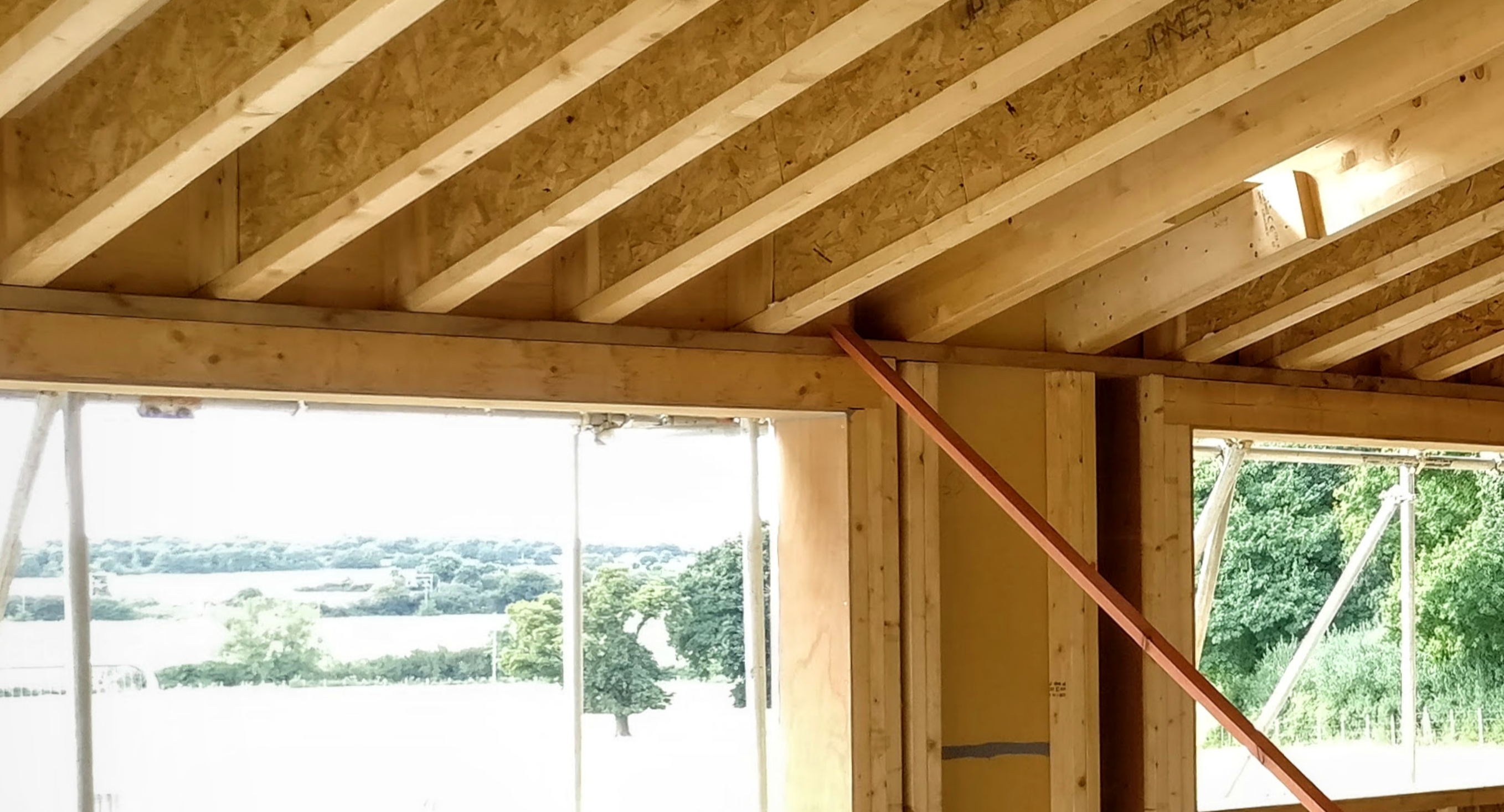

That's right, no clips or straps, just nailed.

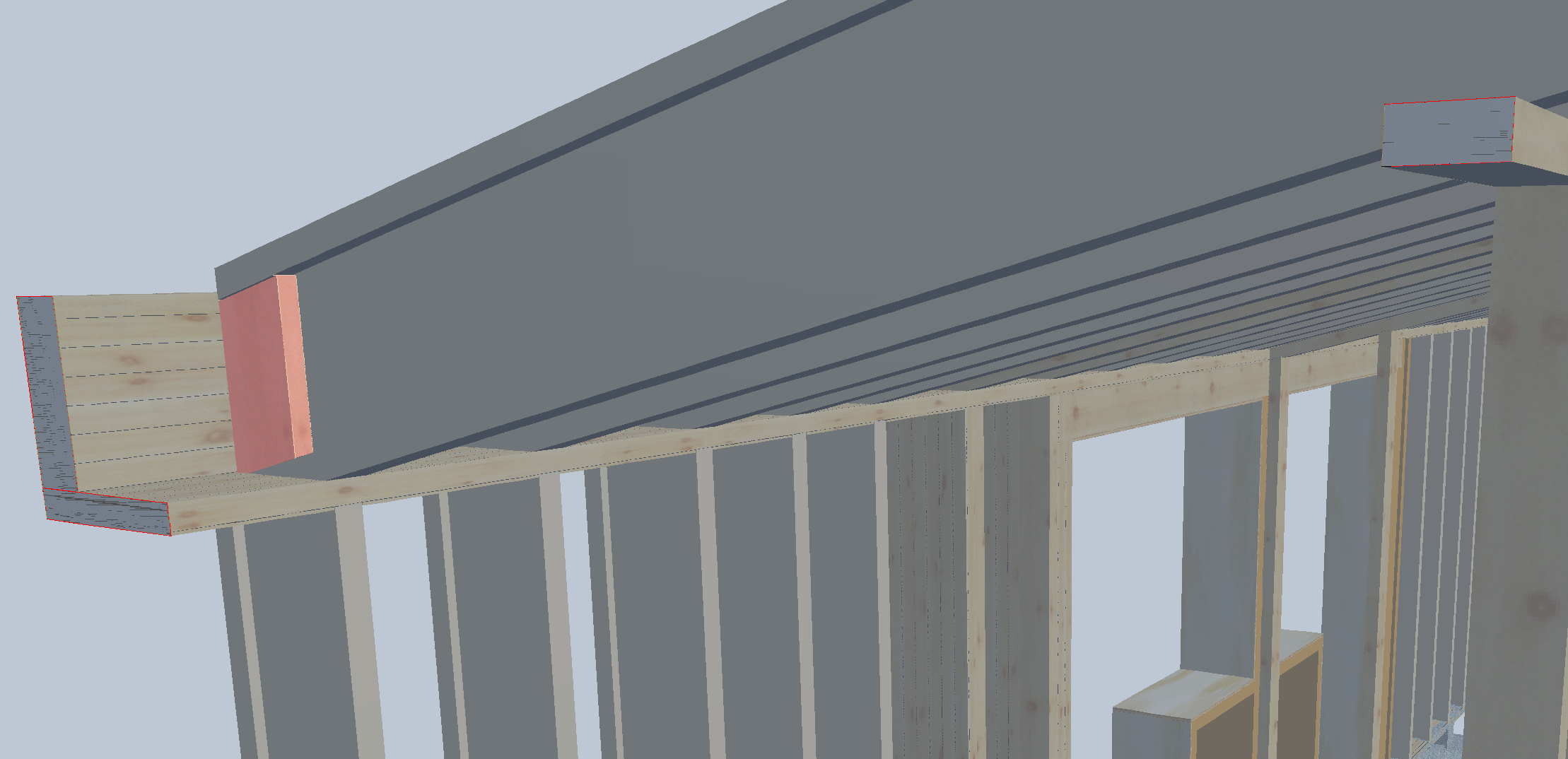

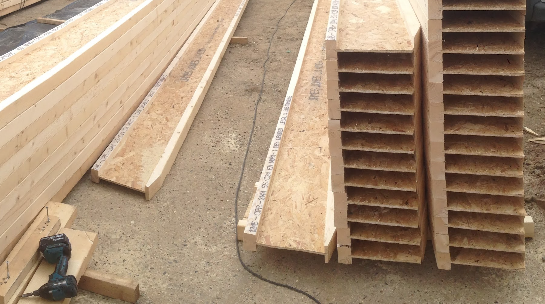

Mine was like this, but with packers between the flanges where the load is taken. Design: Cuts: Installed with packers:
