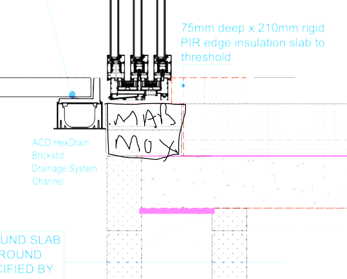

Block extension with external floor level above internal
Dave Jones replied to lookseehear's topic in Brick & Block
why would it ? It's not in direct contact with soil so as long as cavity remains dry (tray) wil be fine. stick to scribbling. -

sit them on marmox blocks. they are structural.

ideally you should be using marmox on the inner skin all way round anyway.
