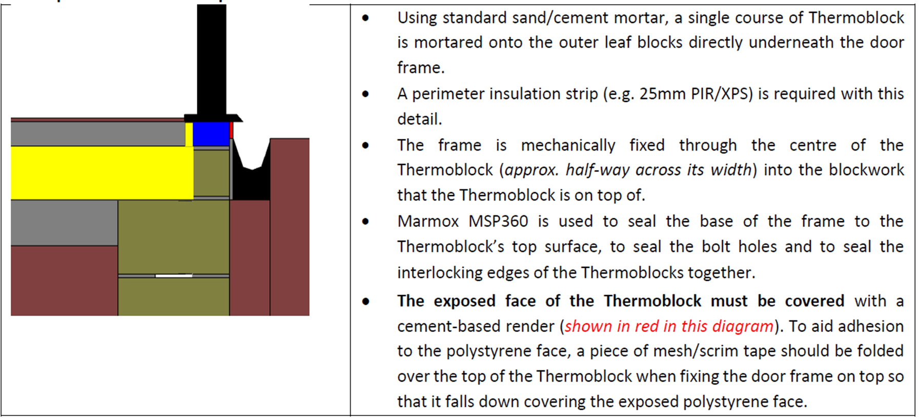

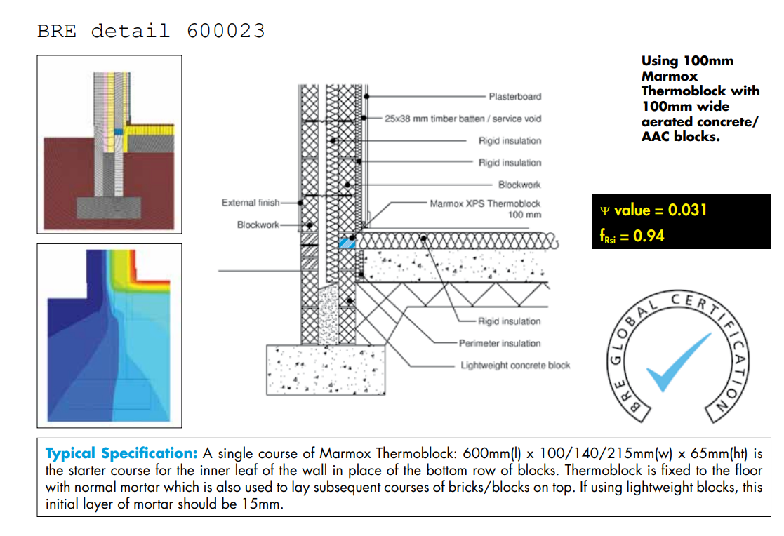

if you want a level threshold, which you probably do. to thermal break it marmox directly under the cil same level as screed. Dont fill behind it with foam or any other non load bearing material as this is your finished floor surface. You are extending your internal floor to the outside skin and at same time breaking the thermal bridge with the PIR under the screed and the marmox block at screed level.

Foundation aerated blocks, marmox, beads below DPC
Dave Jones replied to SBMS's topic in Brick & Block
Inside skin becomes the outside skin for doors maybe you are not understanding this -
they are structural. will be below ground on outside door with level threshold windows are different as they are built into the cavity. -
its for an outside door albeit they havent stepped it out. inner skin is basically the same. aircretes are nowhere near U value of a marmox. your calculating losses through not up as well remeber. otherwise there would be zero market for marmox. -
wait till you start pricing up thermally broken lintels! What's your SAP specify as that is what your having to comply with. Dont forget if your on new regs, every thermal bridge junction has to be photographed for the EPC, no photo - no EPC. -
to eliminate the thermal bridge you really want a marmox block at screed/DPC level all the way round 1 high, no advantage going more than 1 block. where you have openings take them to the outside skin so your door frames sit on them. It's once of the largest thermal bridge junctions in the entire build, not worth bodging. concrete blocks are rubbish for insulation. -
