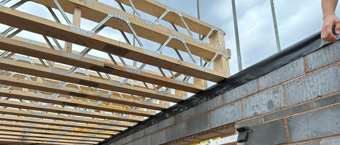

you basically have the same setup we have. panasonic aquera Zehnder Q350 UFH loop fancoils ran off UFH loop. towel rads with electic element and smart breaker to control them all at same time. you could lose nearly all the kit under your stairs i would think. Pozi joists 305mm no smaller or you wont get the mvhr duct in, and dont do what I did and fit the pozi's thinking i could get the ducting in after, you cant! poke in the lengths of tube as you go and cut them to fit later. Also look at tile vents if you have accessible roof space for the mvhr intake/exhaust to save punching unsightly holes in the walls. -
