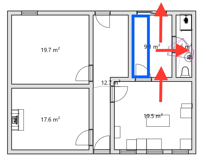

  21. How about this? Utility accessed via the Kitchen along with a rear door. Worktop within Utility indicated in blue. W.C. or Shower room accessed via the Utility. Within the Shower room, you could have the shower on the right (backing onto the Kitchen), a washbasin on the side wall and then the W.C. to the rear with a window above.
