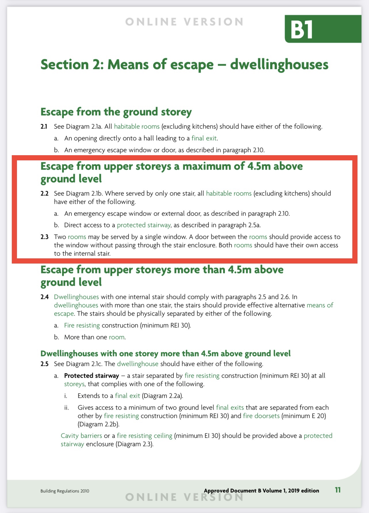

  7. Allowed if the inner room has a suitable escape window or door.

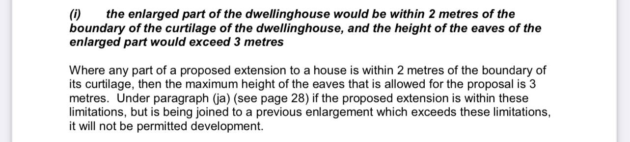

  10. Yes, really. When extensions join one another, the resultant extension would need to comply with the complete rules. As mentioned, the t/s element would join to the s/s element and would therefore not be considered PD.

  12. That would require Planning as the single storey element which would be “joined” to the two storey element would be positioned within 2m of the boundary.
