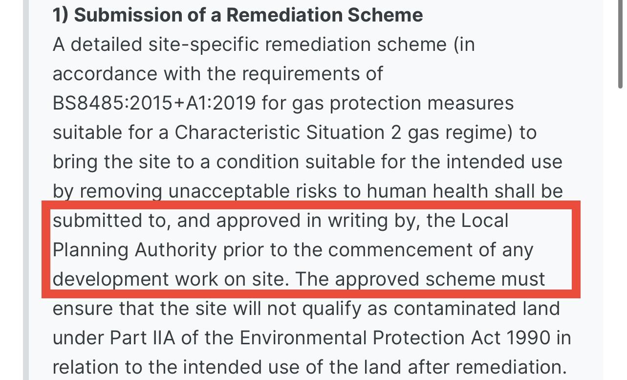

The new driveway and porch would ultimately result in some excavations and reduced level digs. So in Planning terms, it would be deemed as development and you cannot therefore commence work on those elements without formally discharging the relevant conditions. If however there was a PD fallback position for the driveway and porch, then you could argue those elements can be carried out without formally notifying the Council and therefore without any gas remediation information. Information requested that forms part of a condition has to go through a formal determination process, which will include an application form, fee and determination period of up to 8 weeks. You cannot bypass that formal process.
Any works you carry out that would require Planning would usually be considered as development. Otherwise, you could just say the external changes can be done via PD. And the majority of internal changes do not require Planning either. Prior to commencement, you need to submit and receive approval for the information relating to Part 1. Prior to occupation/completion, you need to submit and receive approval for the information relating to Part 2. You therefore have to approach and deal with them in chronological order.

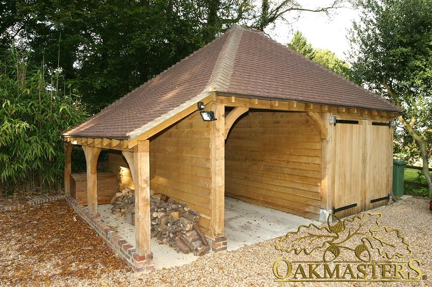

Do you “need” a triple garage? Can you not make do with a nicer designer double garage or carport that would therefore be a similar size and height as the existing? If you went for an open fronted garage, then you could achieve something like this. But note they would condition the approval that it could not be fully enclosed so you may want to include doors for the submission so you have option of having them or not. -
