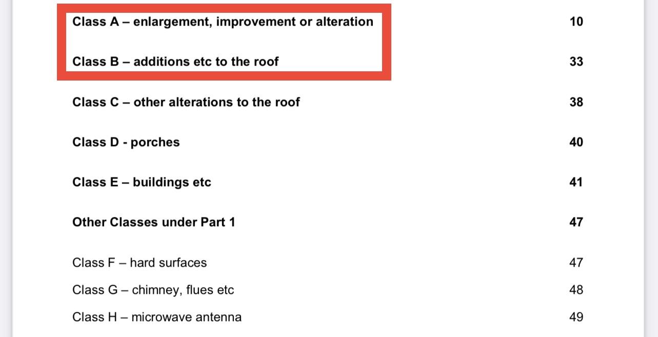

Planning Condition - does this remove PD rights?
DevilDamo replied to Hilldes's topic in Planning Permission
They have only removed Class A and Class B. You can still carry out other PD works providing they meet the requirements. Because you’re in the Green Belt, don’t think that a re-instatement of your PD rights will be plain sailing. -

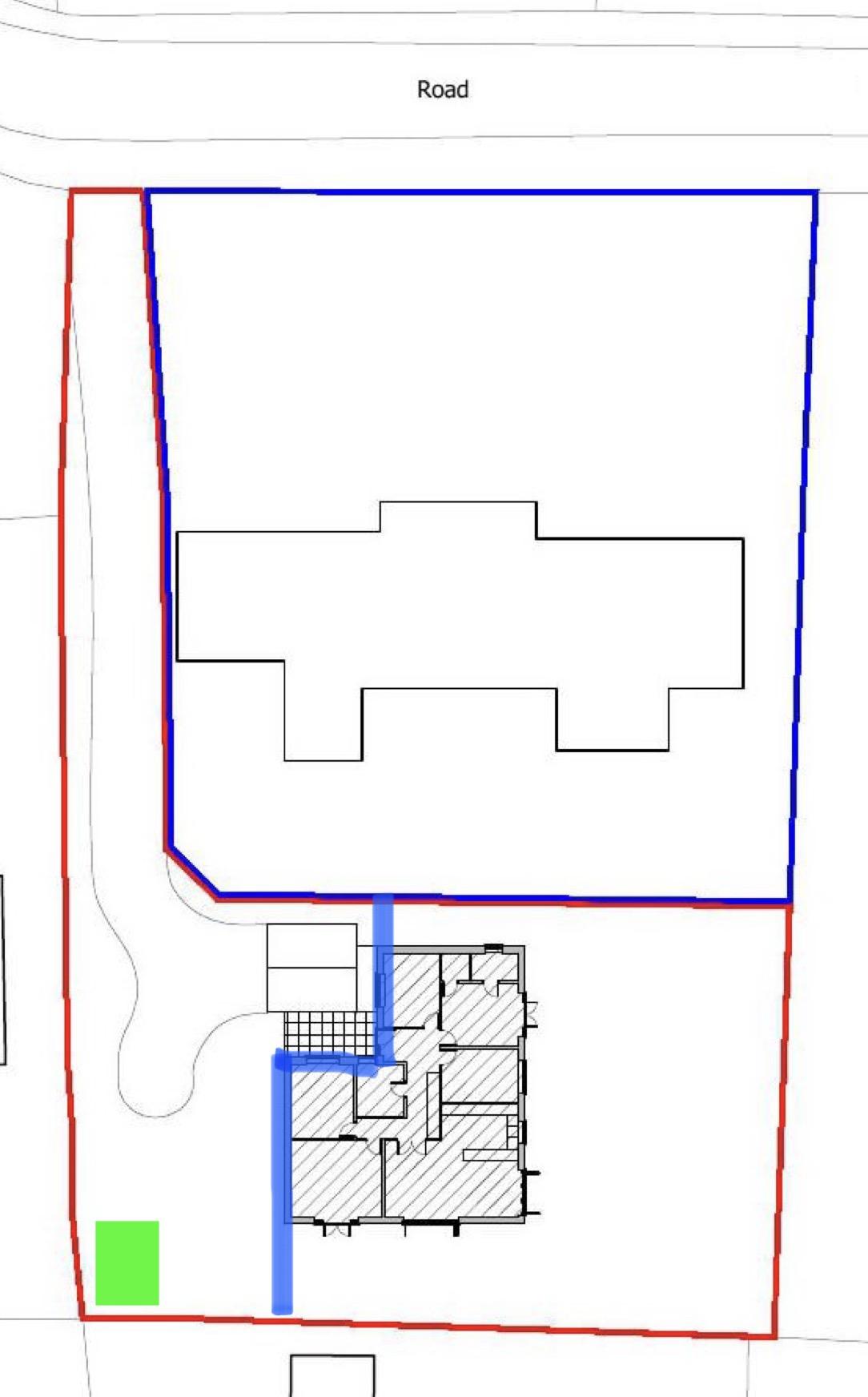

Detached Garage Outbuilding - Part L Building Regs
DevilDamo replied to mac_1's topic in Building Regulations
I agree. I think the main issue here is that because the drawings show and note insulated cavity walls, that is taking the building more away from what is known and seen as a garage and more a habitable space. And this is why the BCO is requesting a fully compliant building. If they stuck with a single skin garage, then once inspected and signed off, the OP can do what they want. -
This is what I would consider the principal elevation as it contains the main architectural features… in addition to the front door. So a suitably designed outbuilding positioned behind that blue line would imo be considered PD.
