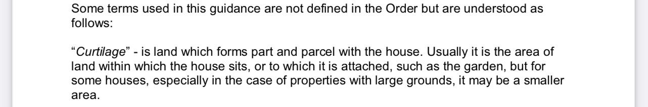

Permitted Development outside original property curtilage?
DevilDamo replied to MAB's topic in Planning Permission
If a habitable room above ground floor level requires an external window/door for escape purposes, the bottom of the opening should not exceed 1.1m above internal floor level. If a Juliet balcony is in addition to a room already providing an escape window, the balcony can be as high as you want. It could not be lower due to health and safety.
