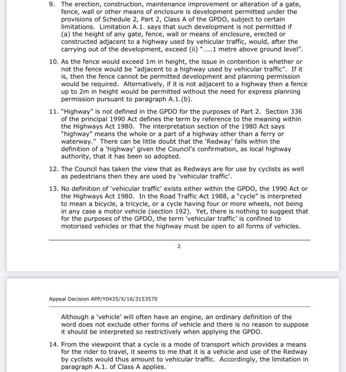

  5. Yes and a highway also includes a footpath, irrespective of who or what uses it, something which sounds like the OP is still trying to contest.

  8. Is this still being discussed!?! 😳 @Al1son The PO has stated the situation along with the LPA’s position. Some of us have had a lot of experience with this and our advice in this instance sides with the PO/LPA. It appears you know better so Appeal the LDC application and see what the outcome is. When it is dismissed and on the assumption you still want to progress it, submit a Full application and see what the outcome is. When it is refused, Appeal that. If that Appeal also comes back dismissed, you know you’ve tried and explored all possible options. Then draw a line under it.
  9. If you meet the PD guidelines, then you have nothing to worry about. Neighbours can comment/object all they want. If you want that added piece of mind if it is PD, then you can submit a Lawful Development Certificate application to the Council. It'll cost you £103.00 plus the PP service charge and the application would also need to be accompanied by the relevant drawings. I wouldn't read too much into that decking link. It seems they have extracted certain parts from the GPDO and made up the rest.

  11. Right I see. I don’t believe that is the most up to date version as changes are yet to be implemented. Have a read of this… https://planningjungle.com/2016/04/18/important-dclg-has-updated-its-permitted-development-rights-for-householders-technical-guidance-document-april-2016/ (Scroll down to “The definition of the term "highway" (page 6):) The definition is on Page 6 of the Technical Handbook and that is what PO’s refer to. Check the original Planning approval for what they have deemed and allocated as amenity land. No doubt this is what the Council are referring to.

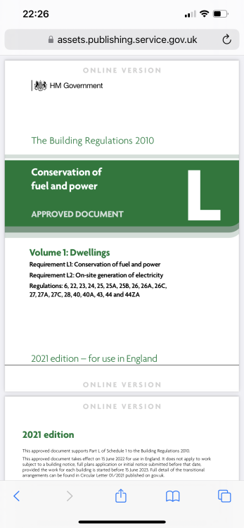

  23. @Temp Correct. So to design and build to the current BR’s, an application needs to be submitted before 15th June 2022 and works started before 15th June 2023. Not complying with both of those means adhering to the new BR’s.
