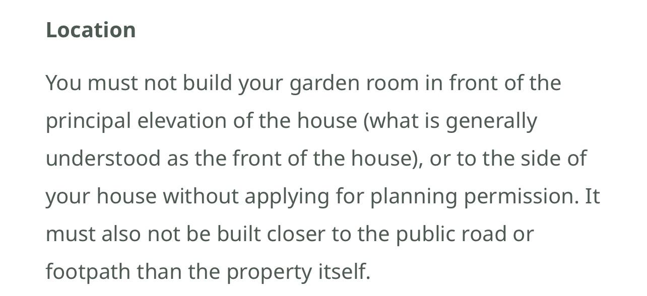

Planning permission for kitchenette in Garden room?
DevilDamo replied to Lloyd Adams's topic in Planning Permission
The “inspection” doesn’t have anything to do with Permitted Development rights. Inspections are carried out by Building Control and Permitted Development relates to Planning. Be careful with what you are proposing as the addition of a Bathroom is now venturing into self-contained territory. This would trigger both Planning and Building Regulations.- 20 replies
Planning for outbuildings to the side 🤔 Well that’s a new one. Again confirming that third party websites should not be relied upon.- 20 replies
