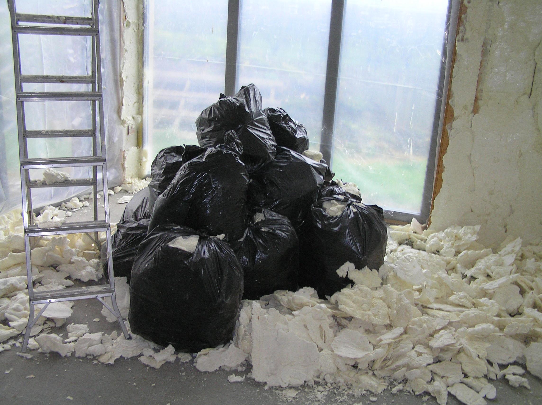

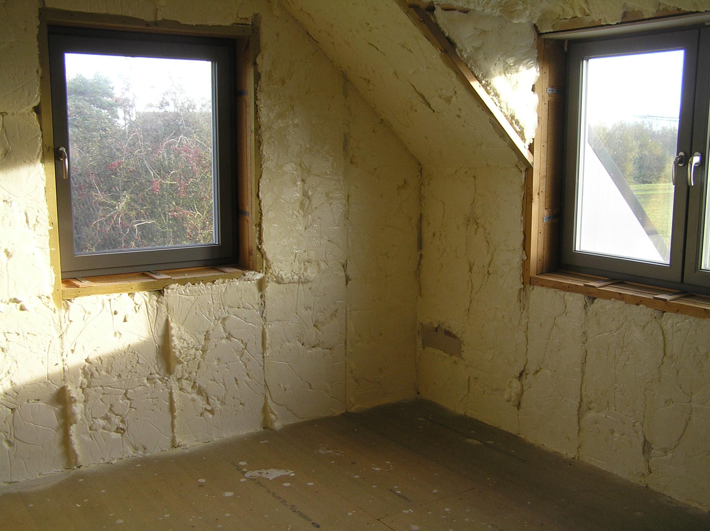

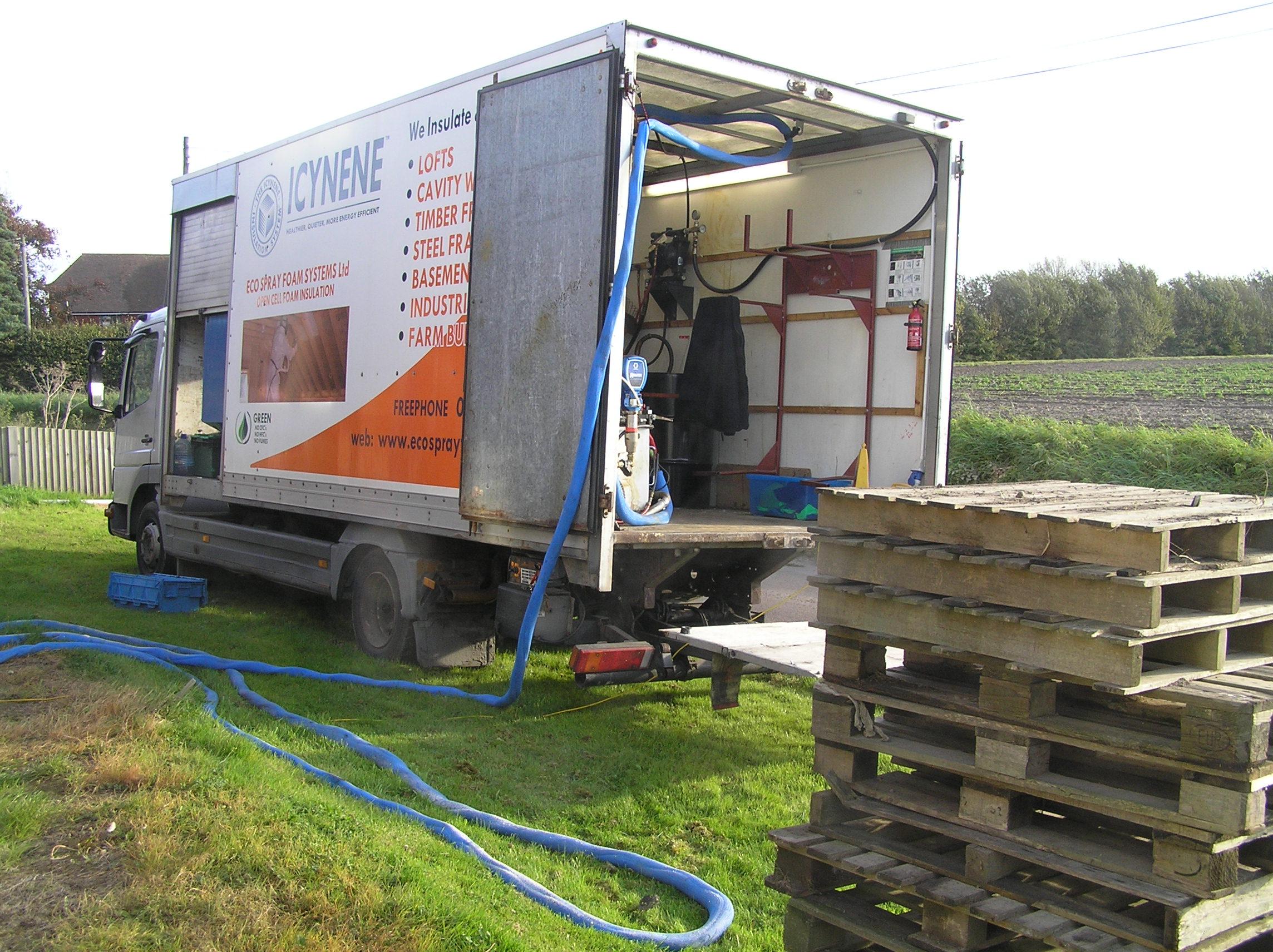

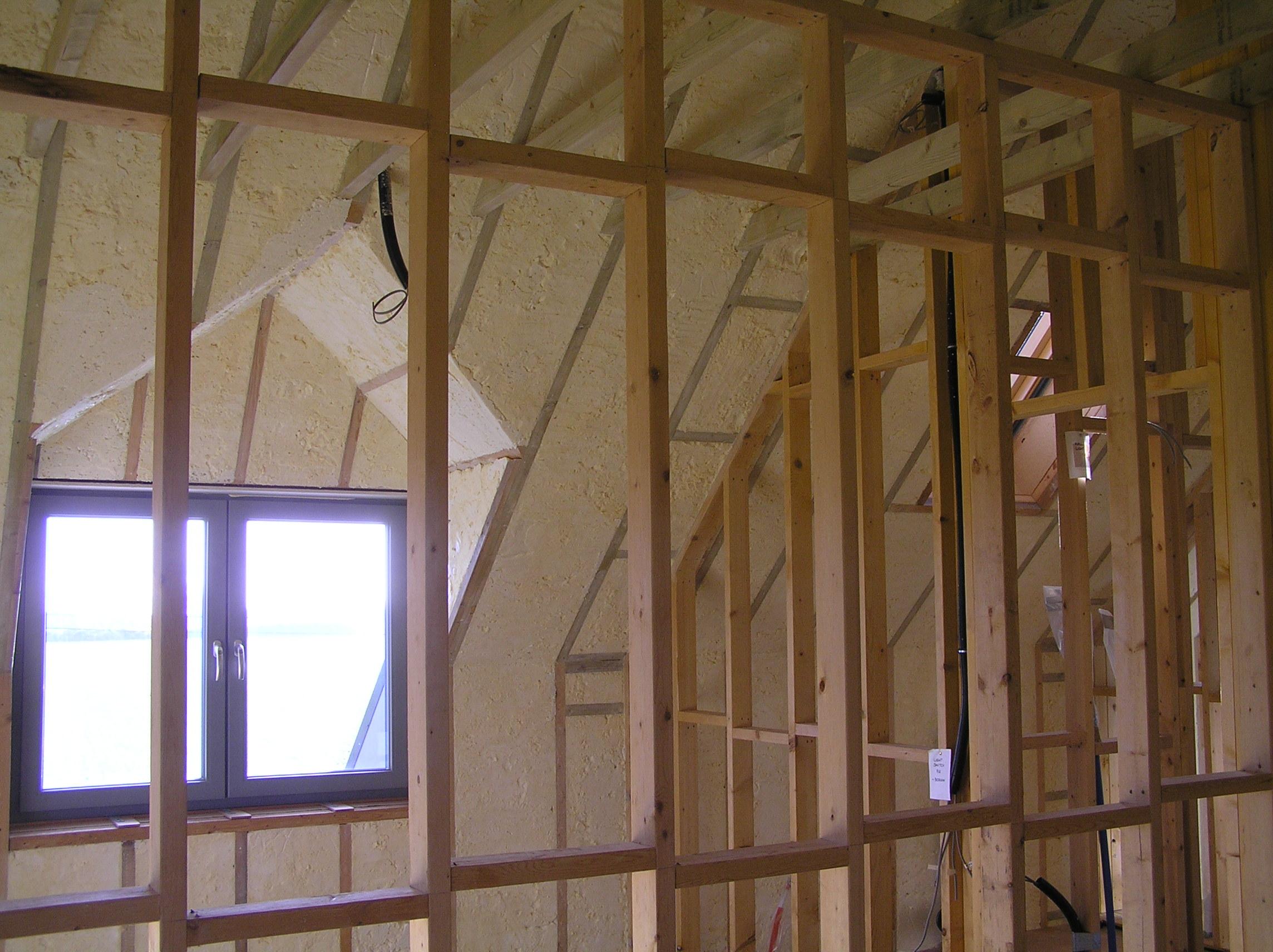

  8. @Arnold9801 This gives you a flavour of what to expect with Icynene. We did our our whole house in 2014 and had it sprayed to a depth of 350mm which was more than twice the depth they had ever done before. As already said the walls have to be warm so a job for the summer. Trimming.mp4
