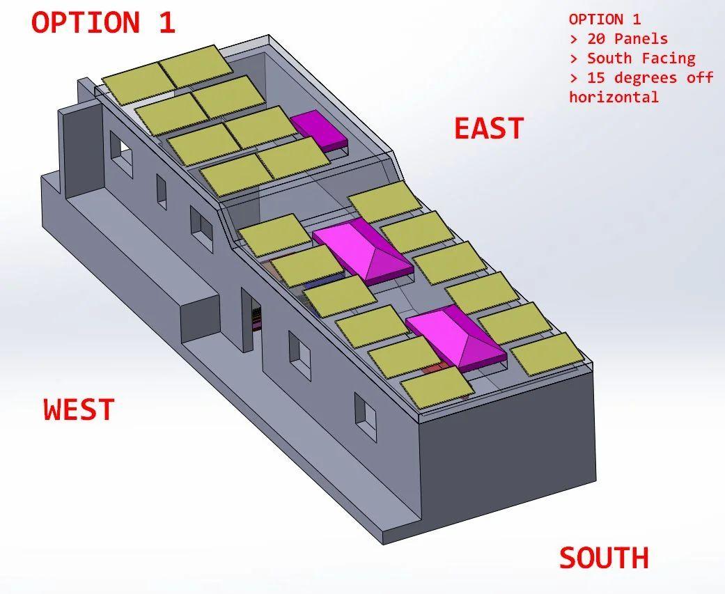

  3. This is the layout I'm thinking about. I may be making life hard for myself in terms of wind lift, but I'd really like to use ballast rather than drilling a hundred plus holes through the roof membrane. You can see that with the existing roof and rooflights, leaving a sensible edge gap is not all that easy. Thanks for all the input folks, really appreciated.

  5. I'm trying to get a new PV system installed, on a flat roof. I'm about to apply for planning permission, but can't find any solid info online about restrictions in terms of how far from the edge the panels must be. I assume this is a building regs thing rather than planning permission, but I'll need to be on the right side of both aspects I guess. Many websites seem to refer to a general rule of panels being at least a metre from the edge, which for my roof will massively reduce the area I can use. Does anyone else have any experience with this? Thanks in advance

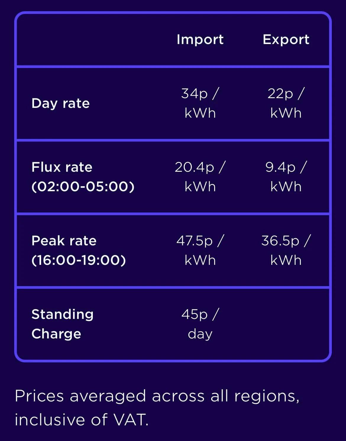

  6. This is the Octopus Flux tariff. As far as I know, there are not many alternatives for export. Though I may be wrong. You'd definitely need a smart meter.

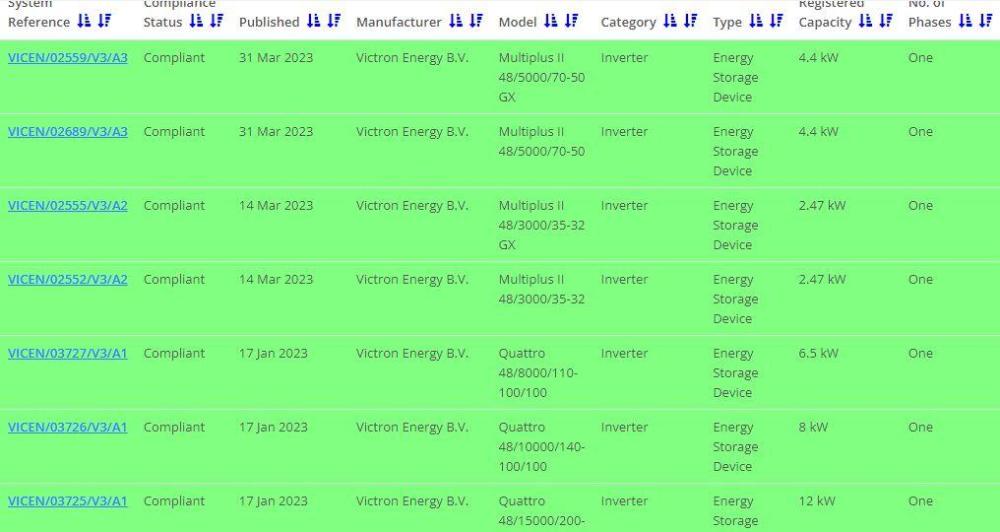

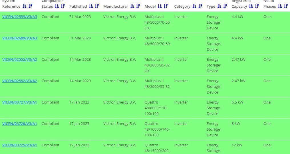

  10. Great info, thanks very much! I heard there is a bit of a faff in terms of which Victron inverters are approved for the G99 application, and from memory the bigger Quattro units are, but not sure about the larger Multiplus models. I'll have a look... Yes it looks like the largest Multiplus that's ENA approved is 5000VA (4.4kW). So in summer I'd not be able to export anywhere near as much as I'd need to.

  13. I am certainly familiar with the kind of output I can expect, having relied on a 2.5kW PV system on our smallholding for the last few years. Yes I have modelled the output using this tool, so I have an idea of what to expect. It's a great tool! As I said in the post, and showed with the 3D model, this is really the max number of panels I can fit on the roof space available. I could just about get more panels on another roof, but figured there must be a law of diminishing returns that says beyond a certain point, the cost of the larger array doesn't really make sense. Plus it will cost more!
