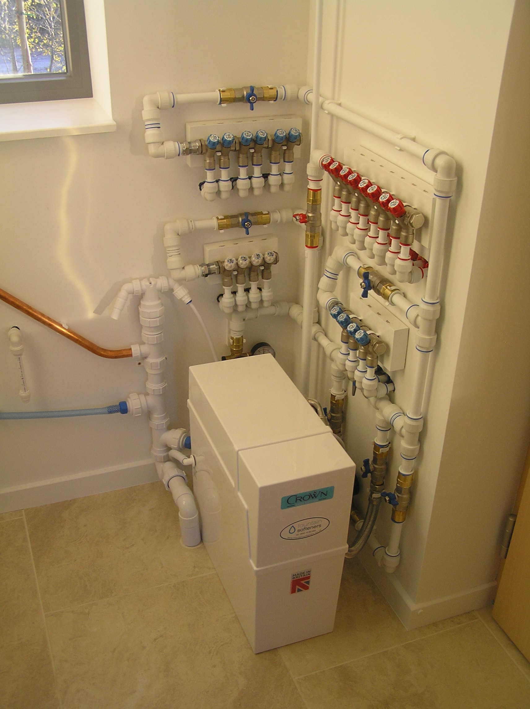

The manifolds are metal and virtually everything is Speedfit. It's a bit cramped but I've managed to squeeze everything in. We don't like the look of copper pipes so we've only used them for the D1 and D2 pipes. It'll all be hidden away in a cupboard eventually.
