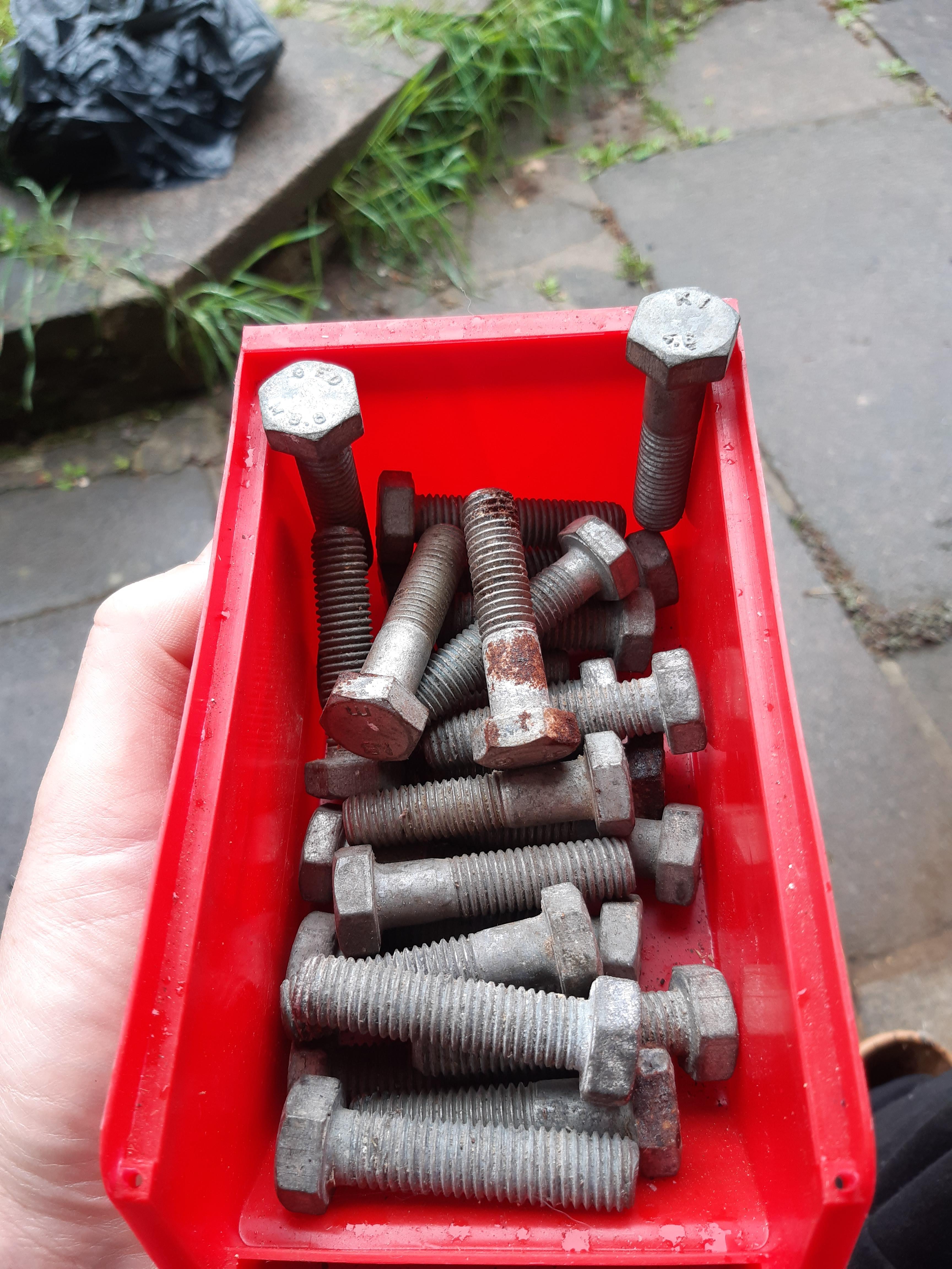

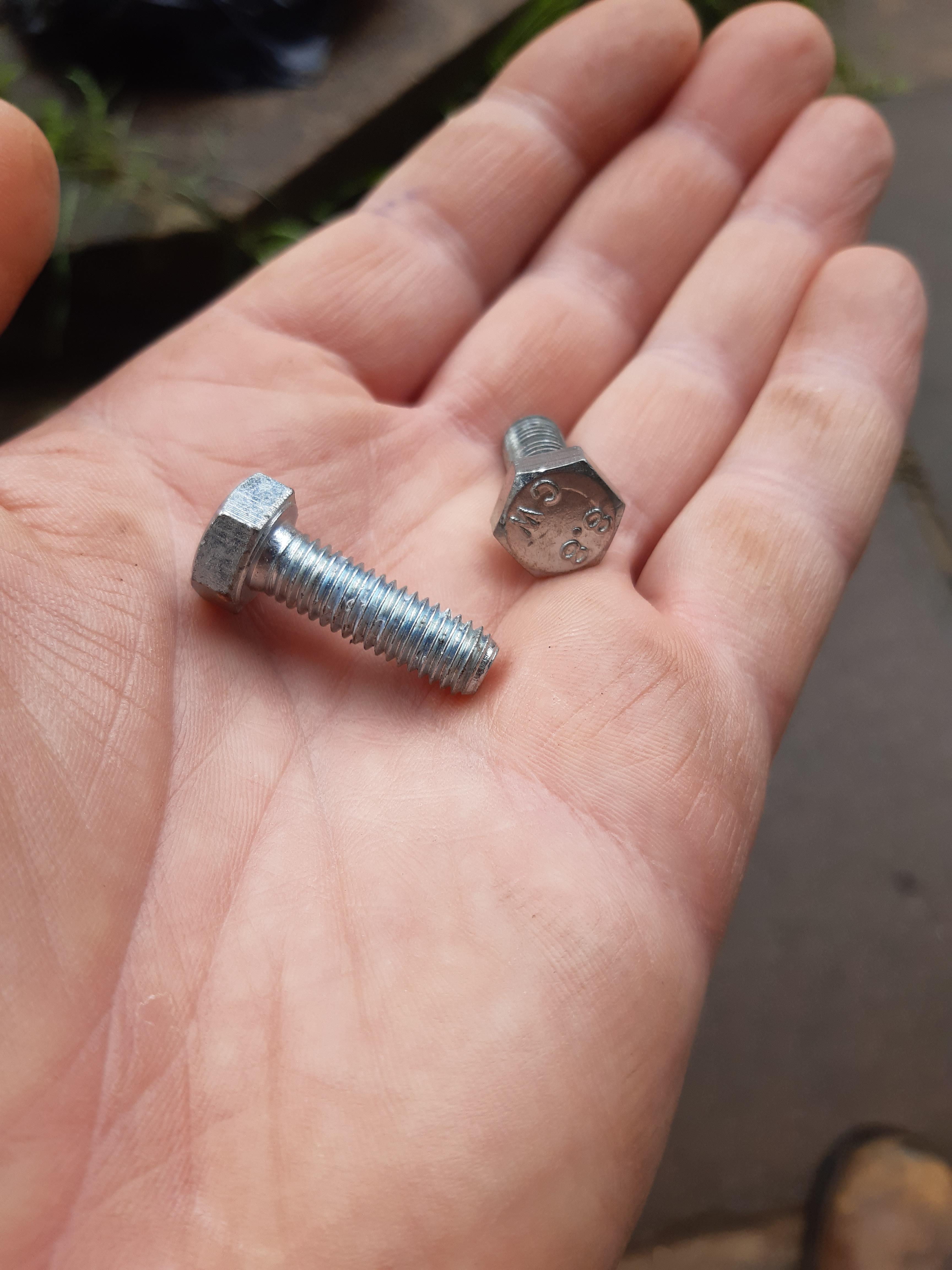

  9. Fyi these are all galvanised fixings a few years old. The one on the left stamped 4.6 a lower tensile grade that the 8.8 on the right. Treat any unstamped bolt as the lowest grade unless proven otherwise. You can see some have a little rust on them. Periodic spannering may damage the galv coating on the head. Similarly you can see rust where a couple passed through other steel plates and moisture would have lodged. These are bright zinc plated bolts, much shinier, not as good as galv: You can also get a "yellow zinc" finish. Slightly better than bright zinc plated...but still w@nk for this! ?
