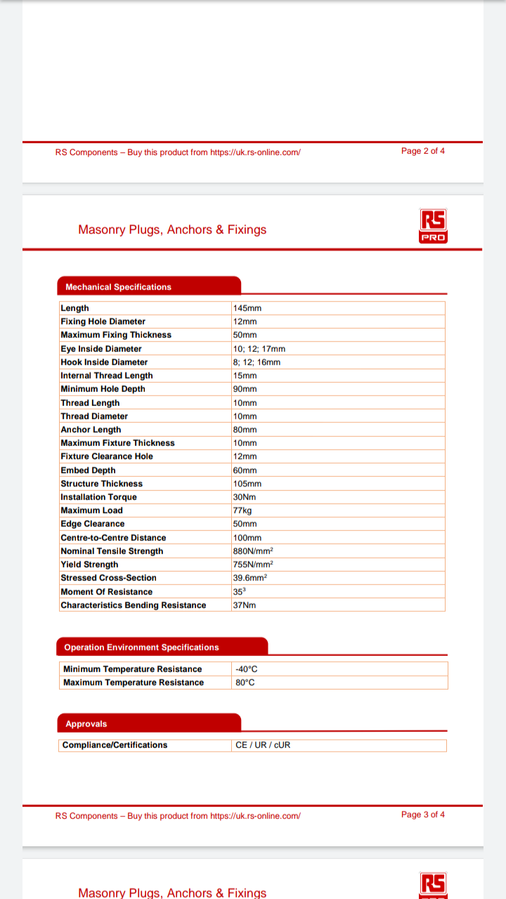

The 13mm hole goes all the way through the post? Drill it at 13mm and if it's too hard going in whack the pointy end from the other side using a 12mm bolt or bit of studding as a drift.

Worst case they'll f**k up and spin in the hole. Then, drill out to 14mm, clean the hole...and use resin! ? Edit: If you can get the spinning anchors out of course.
The FFX ones say fixing thickness 6 - 25mm. The RS data sheet says 10mm for them. On that basis go with the FFX ones. (Resin is so much easier! Sure you'll waste a bit and go thru a few mixing nozzles until you get the hang. If you were nearer and I didn't have the dreaded Covid lurgi you could have borrowed my gun, brush, puffer etc).
Probably don't want to pay for Gr80 stainless fixings so they're akin to 8.8 for tensile strength! Shareholders etc.
Talking ball park then to achieve similar tensile strength to a mild steel 8.8 you want to aim for A2-80 or A4-80 if using stainless. The 80 bring a higher strength that 70. A2 and A4 refers to the corrosion resistance properties. A4 basically the best, for marine and harsh chemical environments. Those fasteners I linked are 316 which is aka A4 so top flight corrosion resistance. They'll be good.
